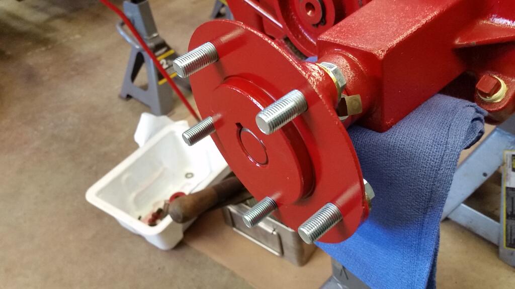

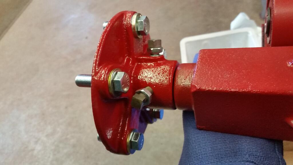

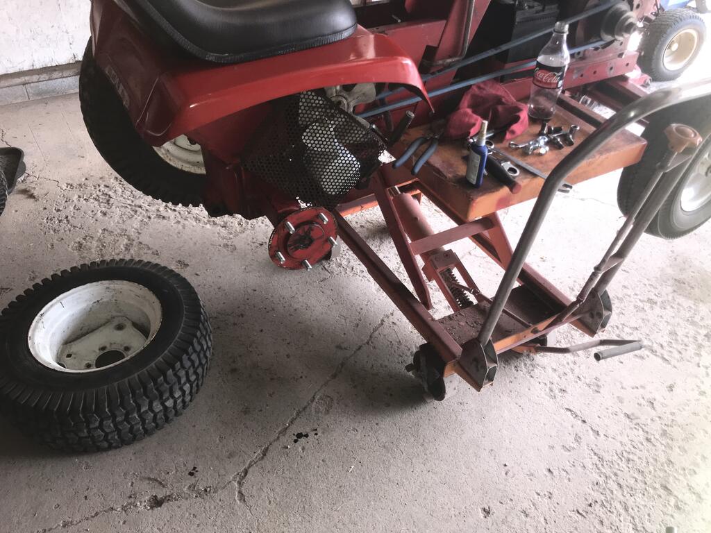

WHX?? 53,369 #3 Posted March 2, 2021 (edited) It's a good mod to do Huey and does ease tire swaps. Bob Maynard here was selling complete kits to upgrade but if you have a decent hardware store at your convenience 7/16-20 bolts 1 1/4 long. I like to put a thick washer behind the head of the bolt to be able to snug the bolt up better. Be sure to torque every thing to specific values for that size bolt. I also like to blue loctite them in. I be workin on EBs tractor I would use green loctite... These clowns like pics so who am I to argue? Obviously wouldn't have to get so pretty with the acorns for a worker but I feel they have more thread contact. Edited March 2, 2021 by WHX24 13 1 Share this post Link to post Share on other sites

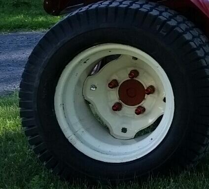

rjg854 12,639 #4 Posted March 2, 2021 I have red lug nuts on my wheels To each his own 5 1 2 Share this post Link to post Share on other sites

ebinmaine 75,807 #11 Posted March 2, 2021 51 minutes ago, WHX24 said: Lol Randy... betcha a cheeseburger EBs got nuts that are blue! 55 minutes ago, rjg854 said: red 38 minutes ago, JAinVA said: I ain't checking but it is kinda cold, so. I do actually have oversized RED NUTS On Colossus... 1 7 Share this post Link to post Share on other sites

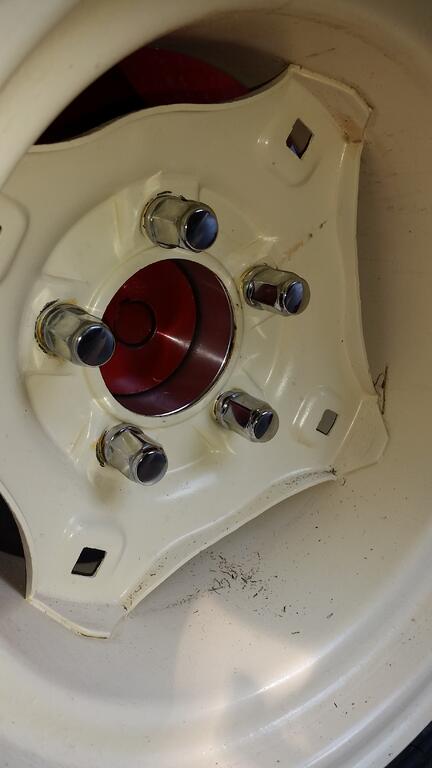

David414 311 #22 Posted March 2, 2021 wheel studs with chrome acorn nuts on a 41-4-8 6 2 Share this post Link to post Share on other sites
