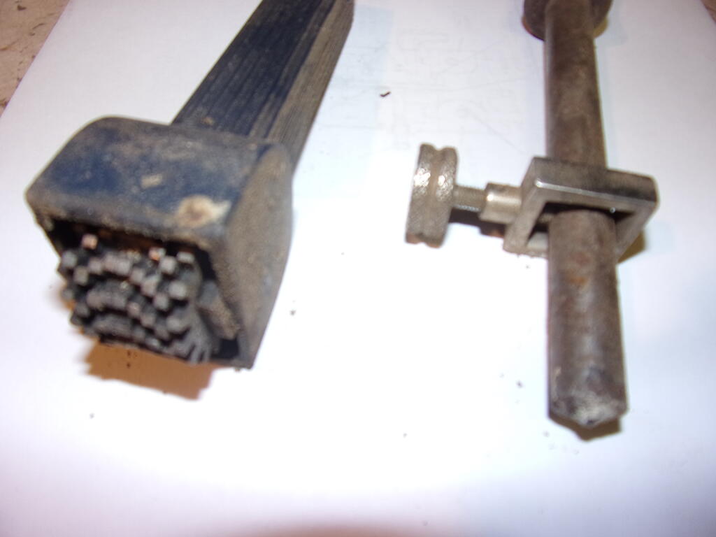

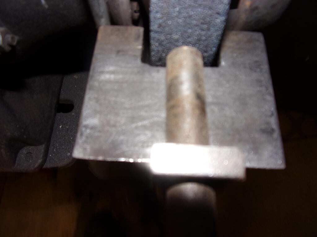

Ed Kennell 46,336 #28 Posted March 1, 2021 16 minutes ago, DennisThornton said: I like the rotary dresser constantly moving back and forth for quickly reshaping a grind stone: But I like the stone dresser for final finishing I've bought several used bench grinders and I've often amazed at the condition of the wheels. Not sure what they were doing, but it seems they were doing it all in one spot! I have both a rotary and a diamond point dresser. I very seldom use the rotary dresser unless I get a grinder with an abused wheel. I get good results with the diamond point with the guide running on the wheel rest. 1 1 1 Share this post Link to post Share on other sites

DennisThornton 4,773 #31 Posted March 1, 2021 20 minutes ago, Ed Kennell said: I have both a rotary and a diamond point dresser. I very seldom use the rotary dresser unless I get a grinder with an abused wheel. I get good results with the diamond point with the guide running on the wheel rest. Diamond point is on my list. Glad to hear you like it. An important part of the process it a light touch and some patience. If the grinder vibrates the wheels are out of balance. Holding the stone or diamond point firmly and just barely touching the wheel will help remove the out of round lessening the vibration. Share this post Link to post Share on other sites
