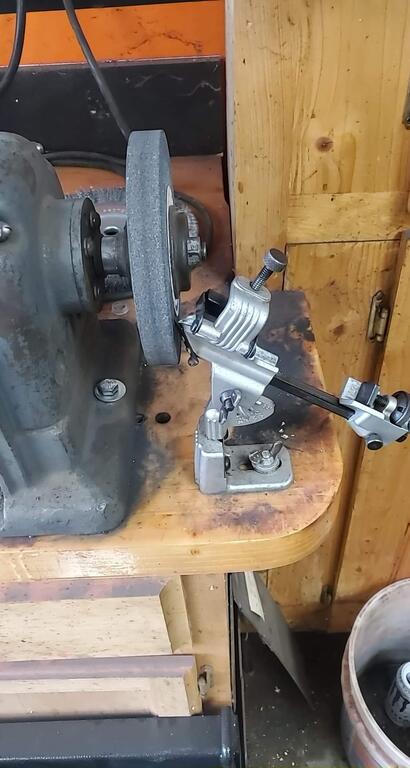

Shynon 7,707 #1 Posted March 1, 2021 (edited) I had a Drill Doctor and had mixed results. Have not mastered sharpening by hand so I remembered back in my high school days Mr. Slifka our shop teacher would sharpen with a jig like this. So on I go and find a vintage Craftsman and with a few trial and error attempts I now have some very nice sharp drills. And yes the Doctor is gone. Edited March 1, 2021 by Shynon 8 3 1 Share this post Link to post Share on other sites
Pullstart 71,315 #2 Posted March 1, 2021 Cool tool! Does it use the side of the wheel instead of the face? I was taught that’s a big no-no... though I’ve been known to break a rule in the past... 1 5 Share this post Link to post Share on other sites
Shynon 7,707 #3 Posted March 1, 2021 3 minutes ago, pullstart said: Does it use the side of the wheel instead of the face? you can use either, I've just seen it used on the side, no concave surface Share this post Link to post Share on other sites

WVHillbilly520H 10,379 #5 Posted March 1, 2021 (edited) 14 hours ago, pullstart said: Cool tool! Does it use the side of the wheel instead of the face? I was taught that’s a big no-no... though I’ve been known to break a rule in the past... Oh my, the older ToolMakers where I used work would nearly "kill" you over using the side of the grinding wheels, "use the belt sander for that" would be one of the responses others I won't repeat, kinda funny the drill bit sharpening came up again today as I was in HF (for a better ground clamp for my mig welder) but of course have to see what's new, looking around their top 2 brands of bench grinder has the drill bit angle bevels built in to the left rests, and they also have a "cheap" drill driven bit sharpener. https://www.harborfreight.com/drill-bit-sharpener-98061.html... https://www.harborfreight.com/8-in-bench-grinder-with-led-light-57287.html... https://www.harborfreight.com/8-in-variable-speed-bench-grinder-with-led-worklight-57285.html... By no means am I a professional at free hand sharpening bits but only practice and trial and error can get you the results you want, and I used both the bench grinder and belt sanders, different materials require slightly different drill tip angles for better results. Edited March 1, 2021 by WVHillbilly520H 5 1 Share this post Link to post Share on other sites
JAinVA 4,638 #6 Posted March 1, 2021 (edited) Have you ever seen a grinding wheel explode? I have and it ain't pretty ! Side loading on a standard grinding wheel is a dangerous thing. Grinding wheels meant for a side load are bonded to a steel backing disk. Edited March 1, 2021 by JAinVA 4 1 Share this post Link to post Share on other sites

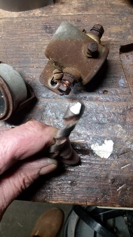

WHX?? 58,220 #8 Posted March 1, 2021 33 minutes ago, pullstart said: I was taught that’s a big no-no... though I’ve been known to break a rule in the past... Here too Kev although I do it more than I care to admit. Only for very very light work JA. So I was fabricating a plate to weld over the F plate on a tractor that is cracked so to drill the holes for tranny mounting I grabbed a bit that was questionable ... had a chip out of the cutting edge. Figured nothing to lose so try free handing it. Worked pretty good. Extra holes for filler weld @Achto...gonna let you burn this one till I get some practice on that new to me welder. 5 3 Share this post Link to post Share on other sites
Shynon 7,707 #9 Posted March 1, 2021 28 minutes ago, JAinVA said: Have you ever seen a grinding wheel explode? I have and it ain't pretty ! Side loading on a standard grinding wheel is a dangerous thing No haven't seen that, I am surprised they still sell these things. On a side not, It's not like grinding a mower blade, as you make pretty light passes. 2 Share this post Link to post Share on other sites
