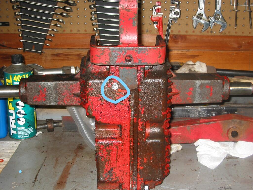

pfrederi 20,891 #3 Posted February 28, 2021 The drain plug on the bottom of the tranny. Circled. 1 1 1 Share this post Link to post Share on other sites

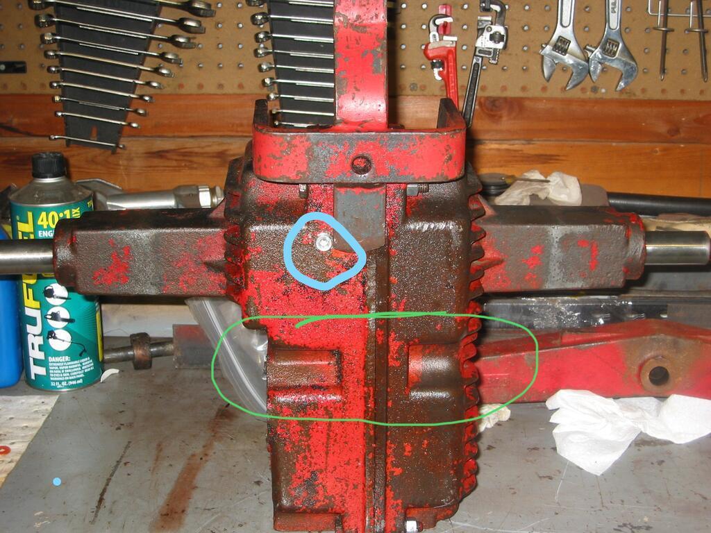

Pullstart 70,766 #4 Posted February 28, 2021 And in green, the reason why it’s advised to jack up the front as high as possible. You’re trying to get all the old oil out from in front of that hump. 1 1 Share this post Link to post Share on other sites
