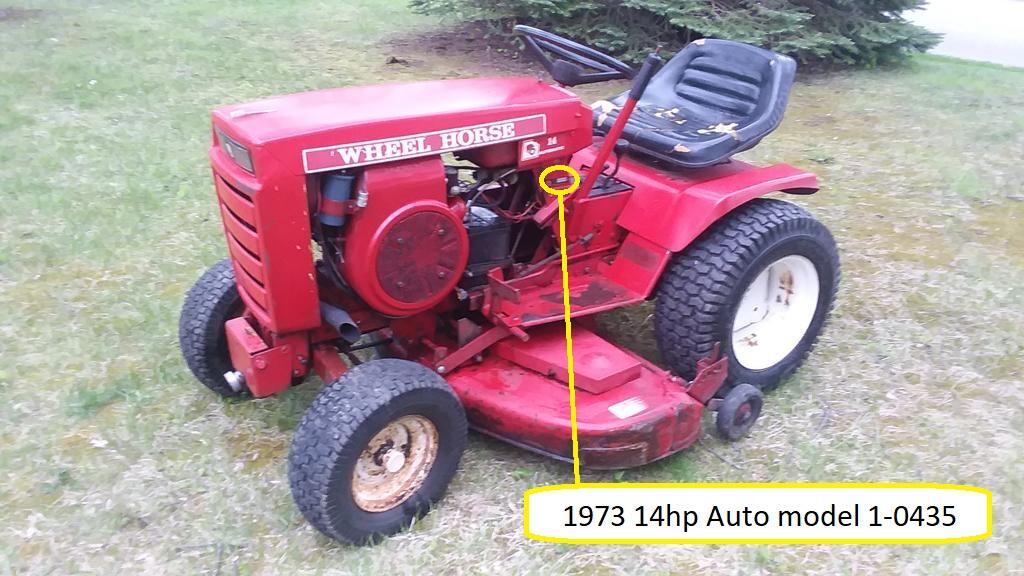

pfrederi 21,312 #2 Posted February 27, 2021 It is probably a C-1*0 Auto. The * would represent the HP could be 2 (12hp) 4 (14Hp) or 6 (16 hp) 2 Share this post Link to post Share on other sites
Gregor 4,848 #3 Posted February 27, 2021 (edited) Any tags on the motor? Model / serial # tag directly under dash? Kind-a hidden. Edited February 27, 2021 by Gregor Share this post Link to post Share on other sites
DennisThornton 4,773 #4 Posted February 27, 2021 That seat will help someone narrow it down. Share this post Link to post Share on other sites
squonk 48,339 #5 Posted February 27, 2021 Manual lift. I'm gonna guess C120 1 Share this post Link to post Share on other sites
krystolo 504 #6 Posted February 27, 2021 Ad says 16 HP, so guessing a C160? 2 Share this post Link to post Share on other sites
krystolo 504 #7 Posted February 27, 2021 Waiting on a reply about tags/serial number. Share this post Link to post Share on other sites
roadapples 6,987 #8 Posted February 27, 2021 I'd love to have that seat... Share this post Link to post Share on other sites
oldredrider 2,554 #9 Posted February 27, 2021 Wrap around shroud says 10 or 12hp. I'm guessing C-120 auto because of the manual lift. 1 1 Share this post Link to post Share on other sites
krystolo 504 #10 Posted February 27, 2021 (edited) He says serial number is 1996. Does that make sense? Never mind. Wrong info Edited February 27, 2021 by krystolo additional information Share this post Link to post Share on other sites
Ed Kennell 47,825 #11 Posted February 27, 2021 I'll go with C-160 Share this post Link to post Share on other sites
pfrederi 21,312 #12 Posted February 27, 2021 1 hour ago, oldredrider said: Wrap around shroud says 10 or 12hp. I'm guessing C-120 auto because of the manual lift. Good catch. just went an looked at my K-341 no wraparound Share this post Link to post Share on other sites
8ntruck 9,387 #13 Posted February 27, 2021 Maybe a '73 No Name? A 14 or 16 automatic? Share this post Link to post Share on other sites
gwest_ca-(File Mod) 12,535 #14 Posted February 27, 2021 From 1973-1975 they had the hood ornament and the ID plate was on the left side of the hoodstand. Garry 1 1 Share this post Link to post Share on other sites
DennisThornton 4,773 #15 Posted February 27, 2021 9 minutes ago, gwest_ca said: From 1973-1975 they had the hood ornament and the ID plate was on the left side of the hoodstand. Garry But the seat. I know they can migrate. But what year was that seat? Share this post Link to post Share on other sites
953 nut 70,354 #16 Posted February 28, 2021 1 hour ago, DennisThornton said: But the seat. I know they can migrate. But what year was that seat? I think the seat was a '70 to '72 unit but not sure. @BOB ELLISON is our seat man. 1 Share this post Link to post Share on other sites
Lee1977 7,809 #17 Posted February 28, 2021 You can count the head bolts to tell if it's a a C-160. If it has 10 it's a 16 HP.. If 9 it's a 14, 12, or 10 HP. I do believe some of the early C-160's had that style seat. 1 Share this post Link to post Share on other sites
BOB ELLISON 2,983 #18 Posted February 28, 2021 2 hours ago, 953 nut said: I think the seat was a '70 to '72 unit but not sure. @BOB ELLISON is our seat man. Don't quote me but I think that seat was started in 1973 to 1977 on the c120 - c160. Also on the gt14 and the electrac. So the seat won't identify the year or the engine. 1 1 Share this post Link to post Share on other sites
