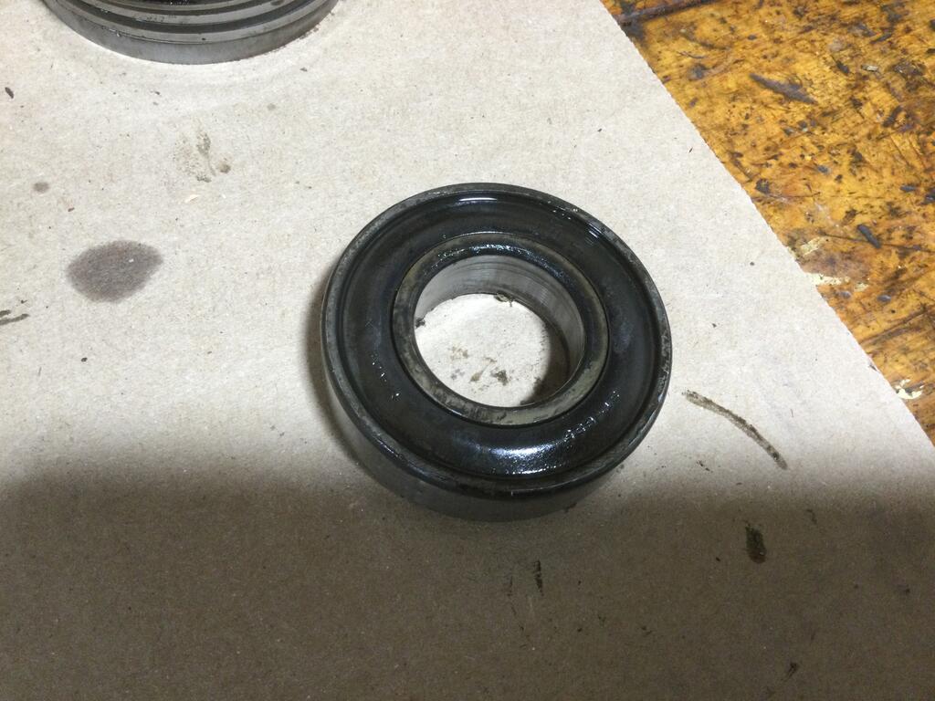

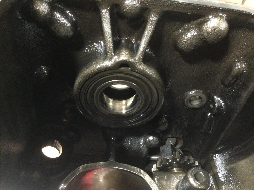

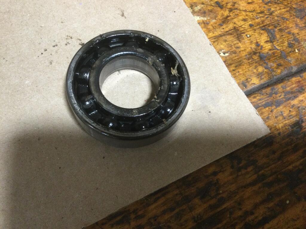

richmondred01 2,393 #27 Posted February 28, 2021 As it happens I got in a k161 today. Both bearings had the shields and.........the shield faced inside the block. Now I’ve seen them both ways. these are going to be replaced. 1 Share this post Link to post Share on other sites

WHX?? 58,228 #29 Posted February 28, 2021 Any idea on the spec or year Richmond? What kind of shape are the bearings in? I got two 161s open now, both off 701s. Will see what they have and report back Note the verbage in the manual Richard.... IF using. I may be thinking too much like Ed's attorney. I had always thought ther was a drain or weep hole on outside of the bearing back to the case to get oil through the bearing or am I wrong? Share this post Link to post Share on other sites
