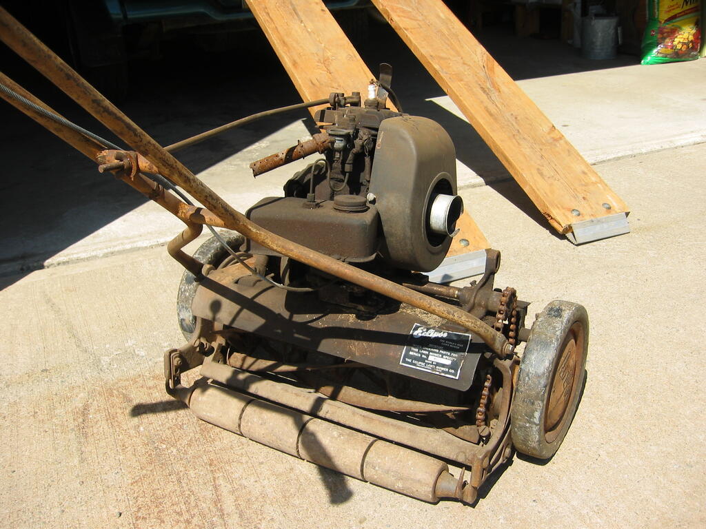

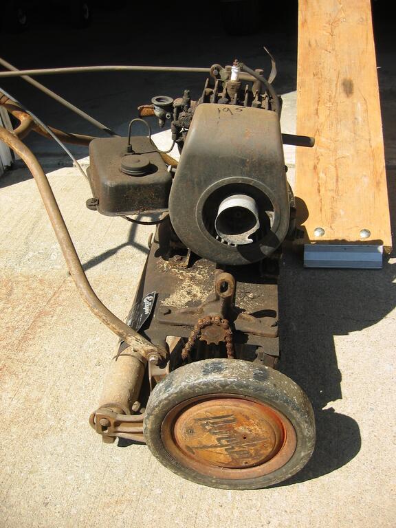

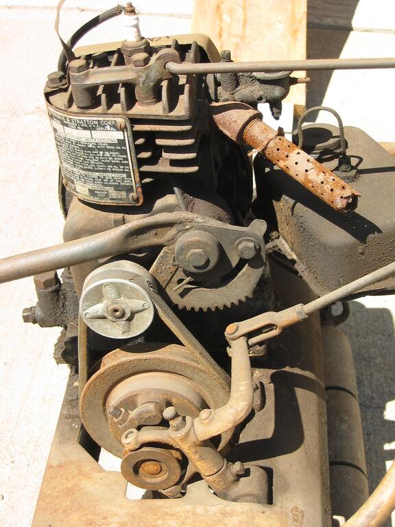

pfrederi 21,222 #8 Posted February 27, 2021 Spent a lot of time mowing our yard with one of these 60 years ago... Self propelled did an OK job but the stalks of narrow leaf plantain were usually left standing. bought this one as a memory but don't use it... Sharpening was easy you added a few links to the drive chain and put an idler sprocket in the top bracket. Smeared some valve grinding compound on the blades and ran it. It spun the backward and sharpened them. 4 3 2 Share this post Link to post Share on other sites

pfrederi 21,222 #11 Posted February 27, 2021 (edited) It was replaced by a King Rotary self propelled mower. The Eclipse went a lot faster... Got the Eclipse fixed up but have to find new pictures... Edited February 27, 2021 by pfrederi 1 Share this post Link to post Share on other sites

Zeek 2,299 #17 Posted February 27, 2021 12 hours ago, pfrederi said: Spent a lot of time mowing our yard with one of these 60 years ago... Self propelled did an OK job but the stalks of narrow leaf plantain were usually left standing. bought this one as a memory but don't use it... Sharpening was easy you added a few links to the drive chain and put an idler sprocket in the top bracket. Smeared some valve grinding compound on the blades and ran it. It spun the backward and sharpened them. I remember those beasts! I used to have to use one to cut a ladies lawn when I was a kid. Hated it! Super heavy, hard to maneuver around and rope starter. However, if I saw one today I'd love to have it! Share this post Link to post Share on other sites

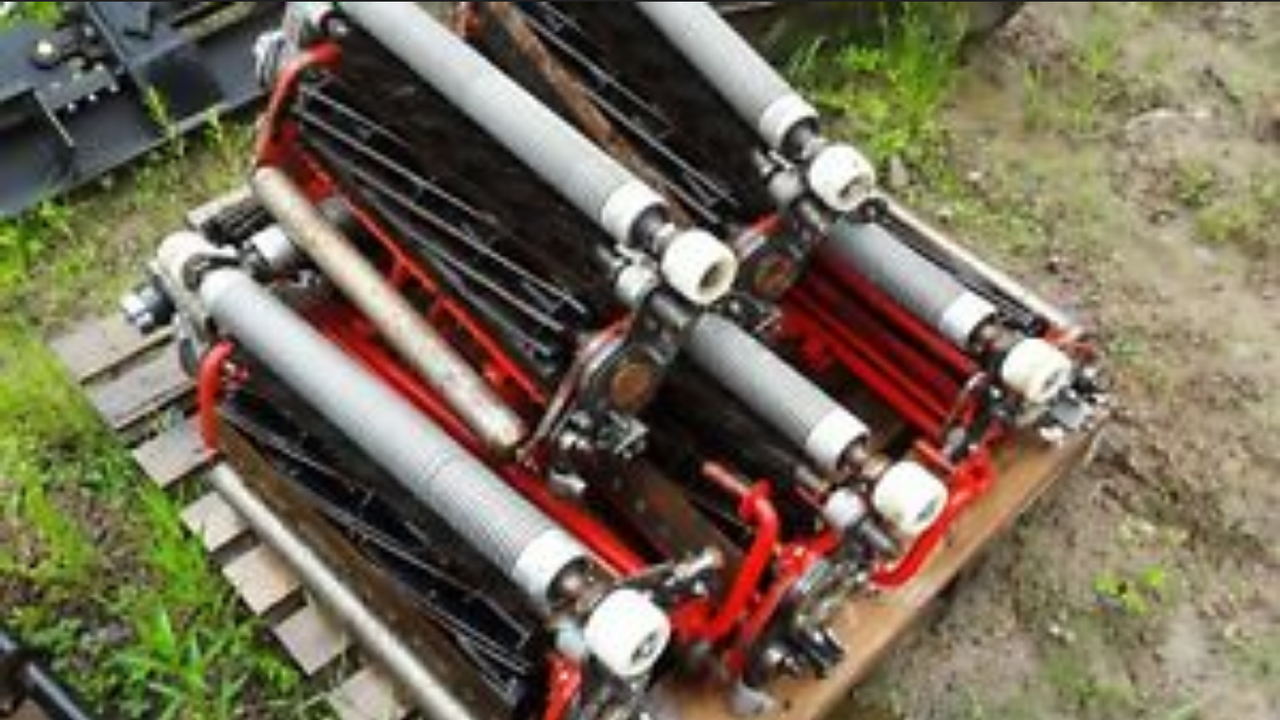

racerjohnbf 130 #20 Posted February 27, 2021 10 minutes ago, DennisThornton said: I'm not a lawn fanatic but I do enjoy a better cut. Problem up here is sand along the edges and a gravel driveway. I suppose if I sprinkled those to keep the sand and dust down it would help, but, I don't. And after a rotary blade dulls it just beats off the grass so I've got enough to build a gang mower but honestly, it's so far down the list... And then this front mount reel caught my eye again and I was curious how well it would handle more than how well it would cut. Pretty crazy to be able to cut down to a 1/10th of an inch! Thanks for the rather valuable 2 cents! Sand is my worst enemy at work. We top dress the greens lightly with sand every few weeks and after a couple mowings that pick up the excess sand, the reels are dull enough to have to be pulled down and sharpened again. After 23yrs of golf course work I appreciate a nice looking lawn as well! 1 1 Share this post Link to post Share on other sites

Handy Don 17,563 #22 Posted February 28, 2021 On 2/26/2021 at 7:27 PM, pfrederi said: Spent a lot of time mowing our yard with one of these 60 years ago... Self propelled did an OK job but the stalks of narrow leaf plantain were usually left standing. bought this one as a memory but don't use it... When I was a pre-teen, my grandfather got a new fangled "rotary" mower gave me his Reo reel mower like this one. I cut off the blades and with my dad we built on a frame with front steerable wheels and an old car seat. A simple go-kart. Ran it until the poor mower chassis simply wore out and fell apart but it was fun while it lasted! 1 Share this post Link to post Share on other sites
