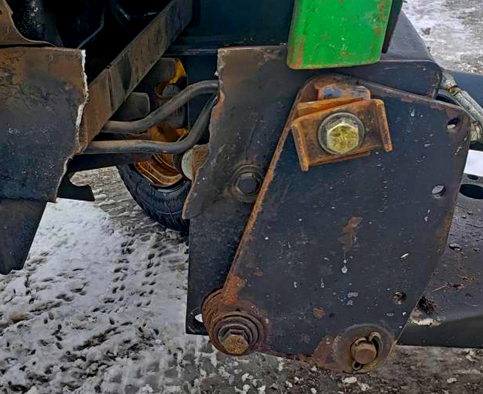

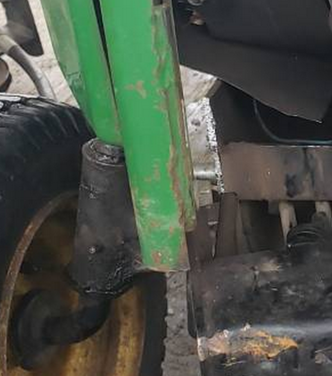

Handy Don 15,755 #26 Posted February 25, 2021 7 hours ago, DennisThornton said: It does look thin but it probably is rather substantial. Looks like he was pushing snow into the highway as the plow truck passed by! I'm not sure how to do that? The forward broken off piece of the frame appears bulged out toward the front wheel at the bottom. Gonna bet that plow was slammed into stuff repeatedly and the lower part of that frame started bending/cracking and it moved up with repetition 'til it just fell off. 2 Share this post Link to post Share on other sites
SylvanLakeWH 30,466 #27 Posted February 25, 2021 Meh... Wrong color... 2 Share this post Link to post Share on other sites
DennisThornton 4,773 #28 Posted February 25, 2021 4 minutes ago, Handy Don said: The forward broken off piece of the frame appears bulged out toward the front wheel at the bottom. Gonna bet that plow was slammed into stuff repeatedly and the lower part of that frame started bending/cracking and it moved up with repetition 'til it just fell off. Could be. I can't tell. Looks like a lot of freshly exposed steel in that crack but some rust as well and I do see a bulge on the front portion. Rust would suggest repetition. If I was there and could check it out I think I could figure it out, but for now... The hodge podge of washers suggest something, but I've been know to do with what I had at the time too. That bracket with the weird washers and other empty holes makes me wonder as well. Share this post Link to post Share on other sites
Handy Don 15,755 #29 Posted February 25, 2021 1 minute ago, DennisThornton said: That bracket with the weird washers and other empty holes makes me wonder as well. An option for the 54" plow was a hydraulic angler--its bracket attaches in those holes (that's why the seller mentioned "lift only" for the plow) Share this post Link to post Share on other sites
DennisThornton 4,773 #30 Posted February 25, 2021 Lots of fresh tear. Share this post Link to post Share on other sites
DennisThornton 4,773 #31 Posted February 25, 2021 7 minutes ago, Handy Don said: An option for the 54" plow was a hydraulic angler--its bracket attaches in those holes (that's why the seller mentioned "lift only" for the plow) Ok. Thought maybe it was mismounted. That last pic I posted showed a lot of fresh metal. Something major happened. Share this post Link to post Share on other sites
Achto 30,844 #32 Posted February 25, 2021 10 minutes ago, DennisThornton said: Something major happened. Yep!! 30 percent engineering, 70 percent "nut behind the wheel". 2 3 Share this post Link to post Share on other sites
DennisThornton 4,773 #33 Posted February 25, 2021 9 minutes ago, Achto said: Yep!! 30 percent engineering, 70 percent "nut behind the wheel". I keep asking myself, if I wanted that to happen, how would I do it. How do you almost tear off the front of a 300 series JD? Share this post Link to post Share on other sites
Achto 30,844 #34 Posted February 25, 2021 (edited) 16 minutes ago, DennisThornton said: How do you almost tear off the front of a 300 series JD? Frame formed out of sheet metal, heavy weight hanging off from said sheet metal, repeatedly using the plow to stop the tractor when you reach the snow bank. Hammer a chunk of metal enough times, it's going to break. I like the design of pushing the plow with the rear axle. But if you ram into a snow bank enough times, you will break the formed sheet metal plate that holds the transmission to the frame. Only disadvantage that I see of the plow frame connecting to the rear axle is the limited lift of the plow. A snow plow that has a pivot point in front of the front axle will lift a lot higher. Edited February 25, 2021 by Achto 2 Share this post Link to post Share on other sites
JCM 10,638 #35 Posted February 25, 2021 12 minutes ago, DennisThornton said: I keep asking myself, if I wanted that to happen, how would I do it. How do you almost tear off the front of a 300 series JD? Not easily 1 Share this post Link to post Share on other sites
DennisThornton 4,773 #36 Posted February 25, 2021 7 minutes ago, Achto said: Frame formed out of sheet metal, heavy weight hanging off from said sheet metal, repeatedly using the plow to stop the tractor when you reach the snow bank. Hammer a chunk of metal enough times, it's going to break. I like the design of pushing the plow with the rear axle. But if you ram into a snow bank enough times, you will break the formed sheet metal plate that holds the transmission to the frame. Only disadvantage that I see of the plow frame connecting to the rear axle is the limited lift of the plow. A snow plow that has a pivot point in front of the front axle will lift a lot higher. All true. I'm still not sure what happened to this Deere... I LOVE my WH snow plow! I suppose there are a few times that I'd like to raise it higher though. And the WH frame to trans might be it's weak spot for abuse it can easily be reinforced. 1 Share this post Link to post Share on other sites

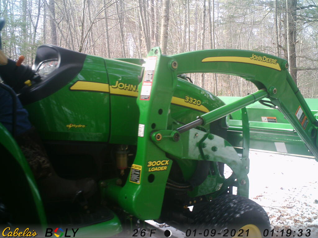

JCM 10,638 #37 Posted February 26, 2021 They are very durable, depending on the model, operators skill level and attention to maintenance detail. The ergonomics are phenomenal on this machine, it's like sitting in your favorite easy chair while operating this tractor. Picture caught by the trail camera while on trail clean up duty. 1 Share this post Link to post Share on other sites
