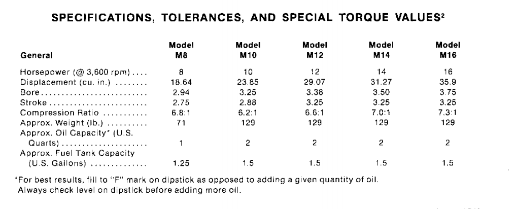

snowhound 106 #1 Posted February 24, 2021 I think I have the wrong dipstick in my Kohler M10 after putting in 2 quarts the dipstick shows oil at the low line. How much oil should be put in? Share this post Link to post Share on other sites
WHX?? 57,470 #2 Posted February 24, 2021 Kohler M8 M10 M12 M14 M16 SM TP-2203-A.pdf 1 Share this post Link to post Share on other sites
snowhound 106 #3 Posted February 24, 2021 Thanks for the info now all I need to do is get the right dipstick Share this post Link to post Share on other sites
gwest_ca-(File Mod) 12,371 #4 Posted February 24, 2021 The Wheel Horse lubrication charts show 2-1/2 quarts for 1985 and 1986 310-8. I expected to see more for 1986 because of the low oil warning system but just the bigger single cylinder engines 312, 414 and 416 got the extra 1/2 quart. 314 did not get it. 1987 310-8 first year for M10 uses 2-1/2 quarts. Garry 1 Share this post Link to post Share on other sites
