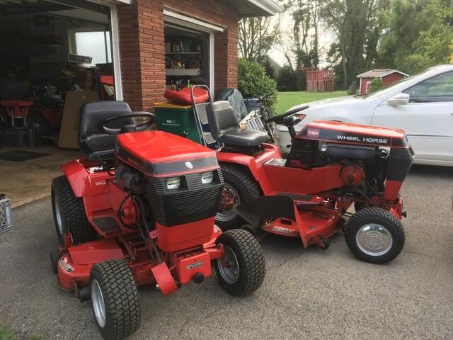

tom2p 2,394 #12 Posted February 25, 2021 (edited) 6" fronts on the classic 300-400 series garden tractors don't pass the eye test bad decision maybe the 6" fronts could have been offered as a dealer option for use with the 37" deck ... or whatever I rolled a 6" tire off the rim plowing brush / dirt - and then later a 6" front tire developed a large bubble providing the motivation to finally replace the 6" fronts with 8" fronts Edited February 25, 2021 by tom2p Share this post Link to post Share on other sites

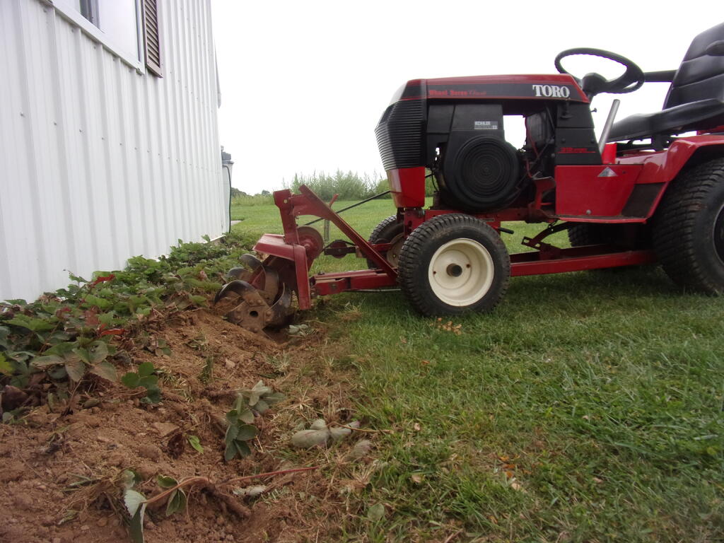

Ed Kennell 46,132 #14 Posted February 25, 2021 I replaced the factory 6" wheels on my '86 312H with 8" wheels and kept the longer 6" spindles. This gave me additional clearance under the front axle allowing higher lifting for the snow plow and front tiller. Share this post Link to post Share on other sites

tom2p 2,394 #16 Posted February 25, 2021 (edited) 2 hours ago, Ed Kennell said: I replaced the factory 6" wheels on my '86 312H with 8" wheels and kept the longer 6" spindles. This gave me additional clearance under the front axle allowing higher lifting for the snow plow and front tiller. I like the front tiller ! I did the same - replaced 6" fronts with 8" fronts on a 312-8 and kept the longer spindles I also have an extra set of short spindles - but prefer the long spindles Edited February 25, 2021 by tom2p 1 Share this post Link to post Share on other sites
