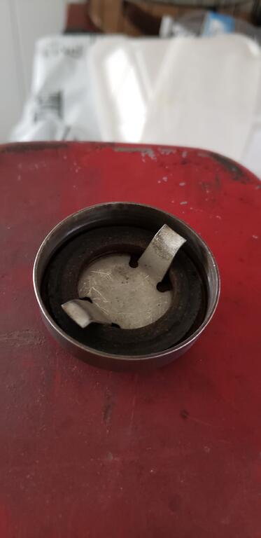

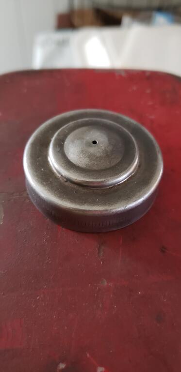

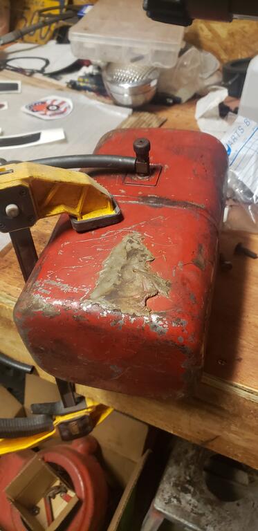

Gordyhogg 150 #1 Posted February 23, 2021 (edited) Im either looking to repair this one or hoping maybe one of you guys maybe has a decent one for sale? There was a poor patch of jb weld on it and it started leaking all over my new paint. I was considering buying jb weld fuel tank repair and then sealing the inside with red kote...but if i can just get one cheaper than the repair id rather save myself the work. It also needs a new shutoff valve and the cap leaks when its full. Any help is appreciated thanks! Edited February 23, 2021 by Gordyhogg Share this post Link to post Share on other sites

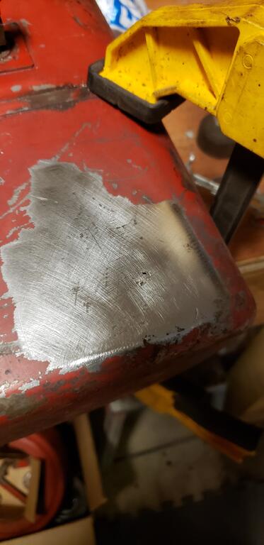

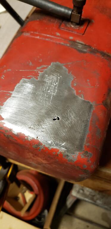

Achto 32,891 #2 Posted February 23, 2021 I have repaired them by tapping the metal down around the hole to create a small dent. Then I solder the hole shut and put a smear of JB over it just for extra insurance. Valve is common with 1/8" pipe thread into the tank. As for you cap leak, take the seal out of the cap and see if you can match it up with something from your local hardware store. 4 Share this post Link to post Share on other sites
DennisThornton 4,773 #3 Posted February 23, 2021 Flame vs no flame. Torch vs electric soldering iron. Don't blow it up! I think it's best to drain of course, then fill with water with the hole at the top. Now you can safely have your way with it, soldering iron or torch. As ACHTO said, dimple the area a little after cleaning it well, solder up and finish. Added trick. You can only see the holes from the outside but if they rusted from the inside there's likely others that just haven't poked through. If you use a torch there's a way to find those too. Grind clean and play the torch over the area looking for changes in the metal's color, tan to maybe blue. Could happen quickly so watch closely. Any thin areas will heat up faster and show themselves in color! Dimple and fill with solder too. You can check all over the bottom where rust was most likely lurking. 6 Share this post Link to post Share on other sites
Achto 32,891 #4 Posted February 23, 2021 Good point on the electric vs flame. I use electric or a separately heated iron when I can. If I need to flame heat or weld, I use a hose to fill the tank with CO from my truck exhaust. Pushes the O2 out & no boom. I had a tank pop while it was filled with water, must have had an air pocket. Bout pooped 'em! 1 3 Share this post Link to post Share on other sites

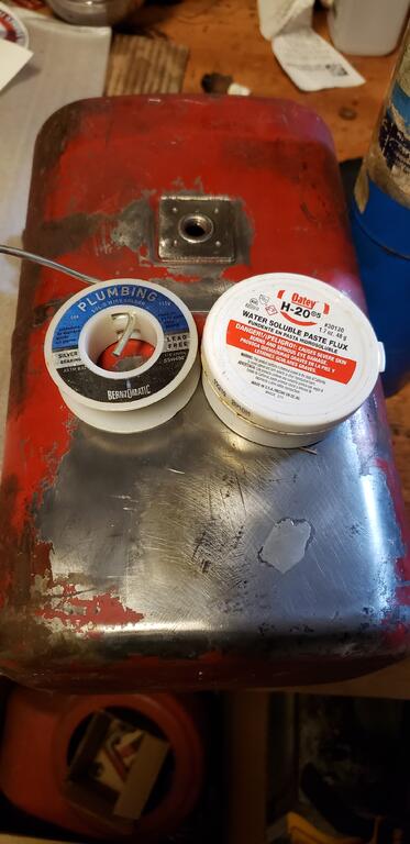

Gordyhogg 150 #15 Posted February 26, 2021 Thanks guys! What kind of solder are you using? Share this post Link to post Share on other sites
Achto 32,891 #16 Posted February 26, 2021 (edited) 35 minutes ago, Gordyhogg said: Thanks guys! What kind of solder are you using? A 50/50 lead / tin will be fine, or a no lead equivalent that is made for steel. You can also up grade to silver solder if you wish. Edited February 26, 2021 by Achto Share this post Link to post Share on other sites
Gordyhogg 150 #17 Posted February 26, 2021 Would lead free plumbing solder work? I think i have some in the garage id have to find it 1 Share this post Link to post Share on other sites
DennisThornton 4,773 #18 Posted February 26, 2021 8 minutes ago, Gordyhogg said: Would lead free plumbing solder work? I think i have some in the garage id have to find it The most important parts of soldering is cleaning, flux and proper heat. Sure lead free will work. Share this post Link to post Share on other sites
Gordyhogg 150 #19 Posted February 26, 2021 Well heres how it turned out. Im gonna sand it some more but i did the old pressure test and didnt see any moisture around the repair...i think i fixed it! Much better than that giant gob of jb weld that was on there and i know this will last a heck of alot longer now. You guys think i should coat the inside with red kote or por 15? Its not real rusty at all in there i think this hole formed from the outside. Also, is there supposed to be a pad of some sort under it when installed on the tractor? 1 Share this post Link to post Share on other sites

Achto 32,891 #21 Posted March 4, 2021 On 2/26/2021 at 12:52 PM, Gordyhogg said: Oh and a cap gasket maybe? When it ran before with the tank full it would spew out the breather hole A new gasket may not cure the vent hole issue but it can't hurt. Awesome job on the tank repair!!! Putting a thin peace of rubber under the tank would be beneficial. Share this post Link to post Share on other sites
