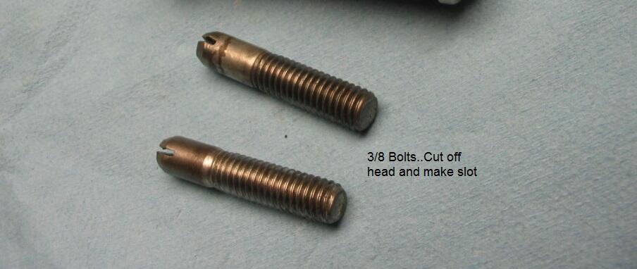

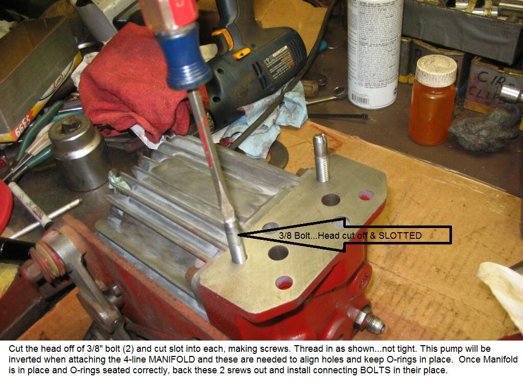

daveoman1966 3,882 #3 Posted February 22, 2021 The D-200 (all D's ) have a 'Separated System' and the most difficult part of the rebuild is getting the Hyd PUMP separated from the engine. You'll also need to rebuild the Hyd MOTOR as it has nearly identical internal parts and it shares the fluid (Oil or ATF) with the pump via a 4-line MANIFOLD. The rebuild is NOT difficult at all....if you can turn a wrench, you can do the rebuild. I have posted on Red Square a .pdf file of the 'How To' with pics. There is a 2nd .pdf file from SUNDSTRAND. Here again are the files. I also have a source for Gaskets and O-rings. You will need to make these 2 screws for reassembly of the maniflold to the hyd PUMP: SUNDSTRAND Piston-Piston PUMP & MOTOR Refurb.pdf Transmission_Sundstrand_Hydrogear_Piston-Piston_1965-1982.pdf D SERIES ALL LIST (3).pdf 3 Share this post Link to post Share on other sites
