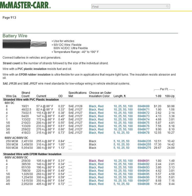

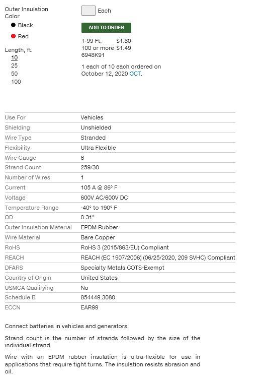

pfrederi 21,181 #2 Posted February 22, 2021 I am using this stuff from McMaster It is super flexible note the strand count. Very fine individual strands. i ordered 6 ga Blk and Red but they the red coil I received was 4ga. 1 2 Share this post Link to post Share on other sites
RandyLittrell 3,946 #3 Posted February 22, 2021 I thought 4ga would be what I needed, but didn't know for sure. Thanks! Randy 2 Share this post Link to post Share on other sites
pfrederi 21,181 #4 Posted February 22, 2021 140 amp rating is certainly more than enough (maybe over kill but who cares) 4 Share this post Link to post Share on other sites

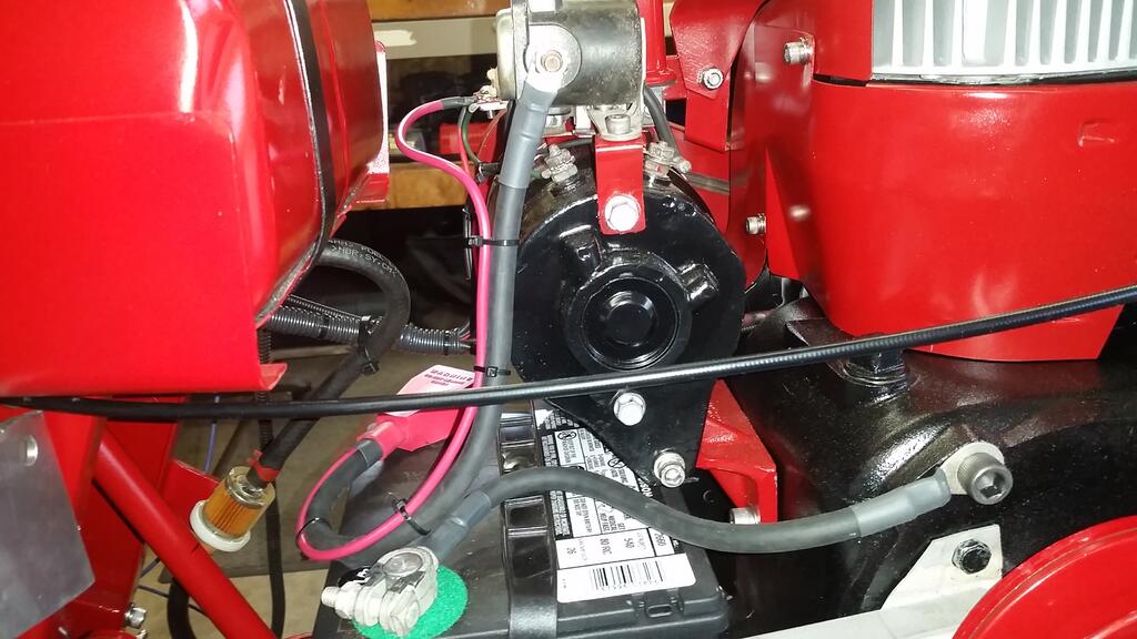

WHX?? 58,218 #9 Posted February 22, 2021 (edited) I used 8 once with no issues.... it's all I had laying around and was jonesing for seat time on a round hood. Was a easy starting motor and so current draw was was short duration. Did make it easier to wire the 70 amp key switch tho. I use 6 ga trolling motor wire now.... fairly flexible.... or have Dan make them for me at work!!! He's right about that hole in the dash stand can get pretty tight but if wiring a solenoid. I solder & shrink all my homemade ones. Edited February 22, 2021 by WHX24 3 Share this post Link to post Share on other sites

peter lena 10,076 #11 Posted February 22, 2021 RANDY, went over to 4 ga cable wire for my battery and engine to ground rail points , to enhance overall grounding , look at 1ST AND 4TH PHOTO , 1st is the ground rail next to battery , that also holds the pto lever action , support, great spot to washer fill the sloppy pto lever action. with washers , about 3/8 " thick ,add lubrication , solid and smooth. 4TH PHOTO , note the cable coming off the corner of the engine , that goes up the the ground rail , and enhances all dash related electrical hook ups, also in the 4th photo , note ,BATTERY TENDER PLUG IN wire wrapped to the choke cable for simple easy plug in . you have a great opportunity while there , just my own experience , pete 1 Share this post Link to post Share on other sites
RandyLittrell 3,946 #12 Posted February 22, 2021 2 hours ago, squonk said: Heat shrink the crimps. Yes, I have really nice heat shrink already with the glue on it to seal it. 2 hours ago, Achto said: redoing a square hood model with a starter gen and the stock ignition switch My son has a 782 cub that needs cables is my initial reason for buying, but I need to redo the cables on my C-120 and if I do the 1277, I'm going to a solenoid. 1 hour ago, squonk said: at way I can get my positive cable made in red. I ordered 20 foot of red and 10 foot of black. 1 hour ago, peter lena said: ,BATTERY TENDER PLUG IN wire wrapped to the choke cable for simple easy plug in I already have that on my 1277 and will add it on all the stuff we are rewiring. Thanks for all the help guys!! Randyt 1 Share this post Link to post Share on other sites

RandyLittrell 3,946 #14 Posted February 23, 2021 On 2/22/2021 at 9:20 AM, WHX24 said: I used 8 once with no issues.... it's all I had laying around and was jonesing for seat time on a round hood. Was a easy starting motor and so current draw was was short duration. Did make it easier to wire the 70 amp key switch tho. I use 6 ga trolling motor wire now.... fairly flexible.... or have Dan make them for me at work!!! He's right about that hole in the dash stand can get pretty tight but if wiring a solenoid. I solder & shrink all my homemade ones. Very neat and tidy!! Just how it should be done!! Randy 1 1 1 Share this post Link to post Share on other sites
WHX?? 58,218 #15 Posted February 23, 2021 Thank you Randy. Actually that was my first stab at a resto. Wiring is about the only damn thing I am good at! 3 1 Share this post Link to post Share on other sites
