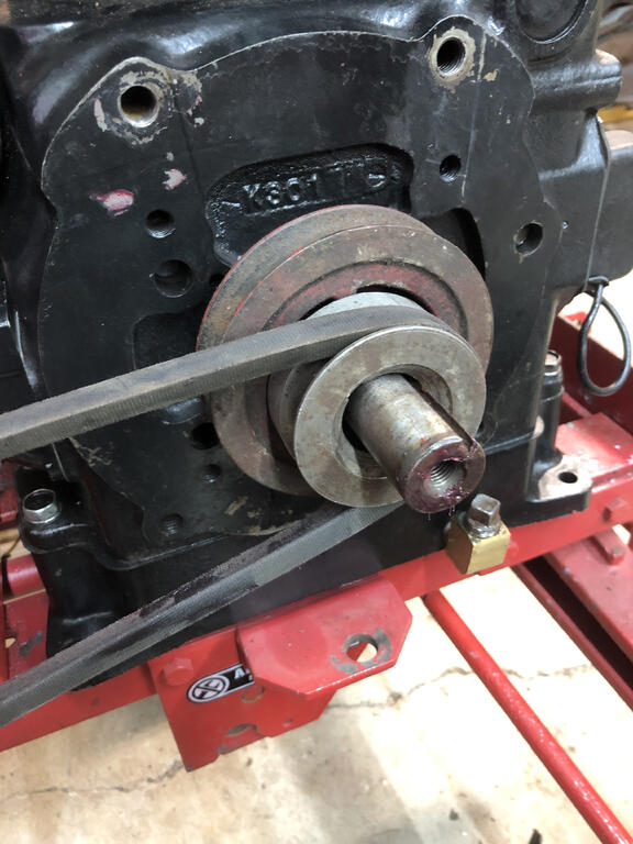

The Tuul Crib 7,354 #1 Posted February 22, 2021 Since I swapped out the crank and ended up with a smaller PTO shaft I had to use a larger diameter drive pulley. The belt was a 7473 I believe 81 1/2 inches. Any ideas what belt number this may be? Share this post Link to post Share on other sites

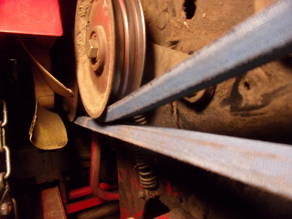

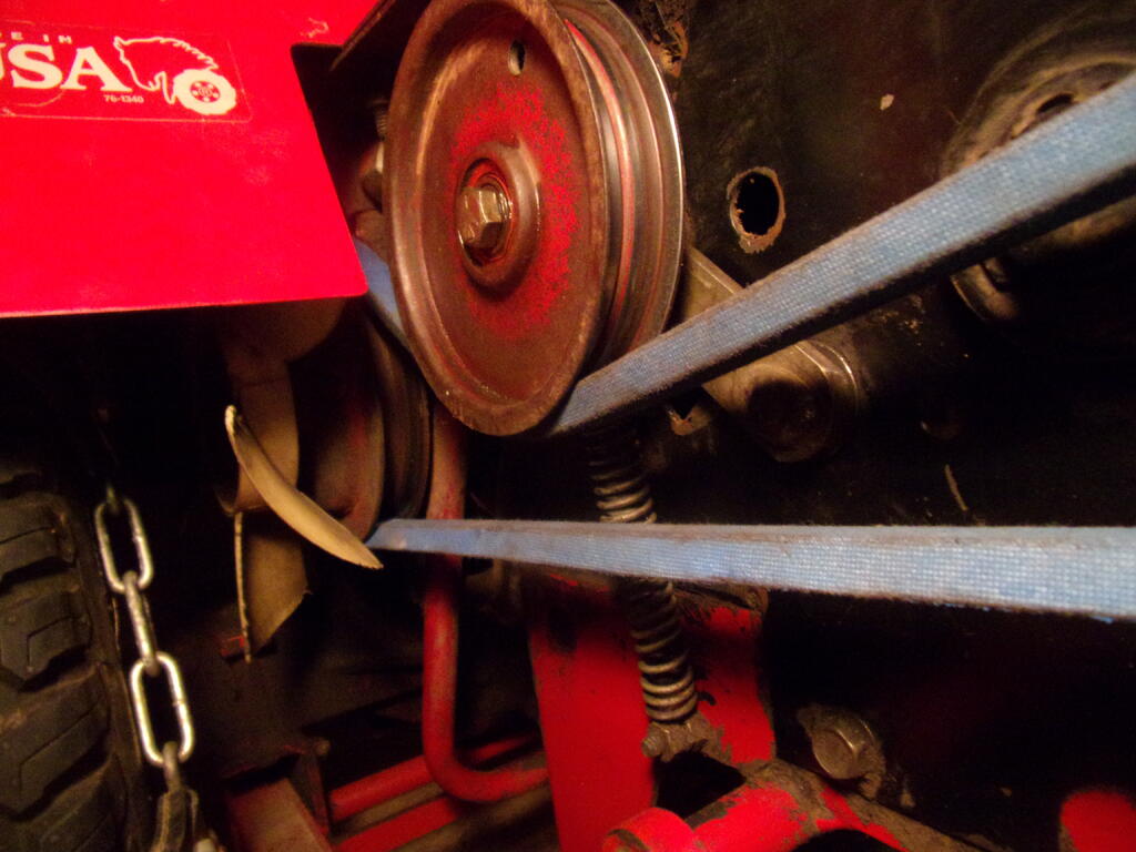

Ed Kennell 47,809 #4 Posted February 22, 2021 This This is an 82" TSC belt on a 312H. The belt is too long. The idler pulley flange will cut a groove in the lower belt causing it to fail. This is an 81" TSC belt. Much better clearance. 1 1 Share this post Link to post Share on other sites
