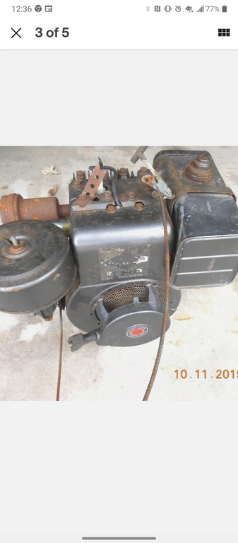

WVHillbilly520H 10,376 #106 Posted March 4, 2021 Does your engine look like this? 2 Share this post Link to post Share on other sites
TJ5208 1,841 #107 Posted March 4, 2021 (edited) Yes that it did I screw it up Edited March 4, 2021 by Tj salyers Share this post Link to post Share on other sites

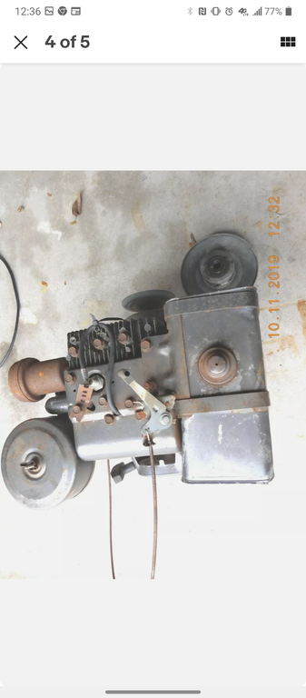

TJ5208 1,841 #110 Posted March 4, 2021 Here's some new pics 1 Share this post Link to post Share on other sites
TJ5208 1,841 #111 Posted March 4, 2021 It's a nice one 1 Share this post Link to post Share on other sites
