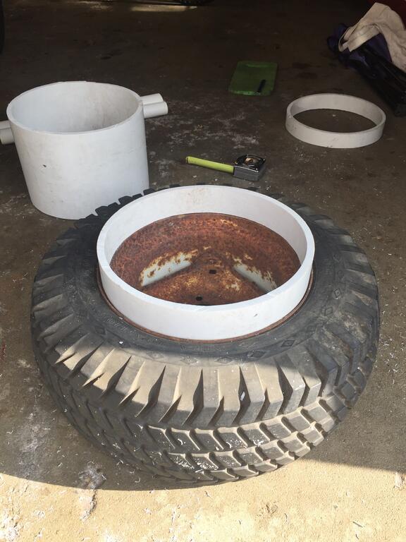

TJ5208 1,841 #9 Posted February 22, 2021 I seen where people use PVC rings for spacers Share this post Link to post Share on other sites
TJ5208 1,841 #10 Posted February 22, 2021 (edited) Here's some don't know if it pvc or not Edited February 22, 2021 by Tj salyers Share this post Link to post Share on other sites
lynnmor 8,899 #11 Posted February 22, 2021 3 minutes ago, Tj salyers said: I seen where people use PVC rings for spacers They are usually available from Miller Tire or on the big auction site. Duels add a real margin of safety when using a loader, but the axles take a beating. Share this post Link to post Share on other sites

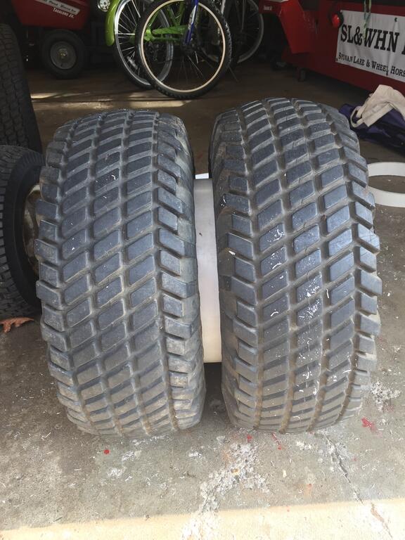

SylvanLakeWH 31,719 #19 Posted February 22, 2021 Here’s a build I did with duals. Kept hardly any air in outside tires to keep impact on axles to a minimum. Only did it for the look. Personally, I’d stick with single for a worker... 2” wide 12” diameter pvc pipe spacer and 10” bolts... Cool and fun but took up too much shop space... 3 1 Share this post Link to post Share on other sites

ebinmaine 79,688 #23 Posted February 22, 2021 Tj make sure you run very little air pressure in the outside tire. That'll keep some of the tension off the axles. Maybe 8 to 10 pounds on the inside and 5 or lower in the outside. Makes it so the outside tire can flex more. 2 Share this post Link to post Share on other sites
