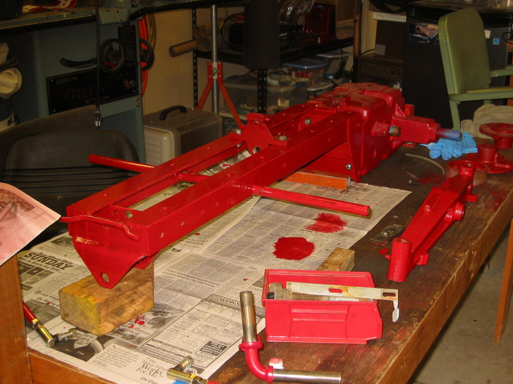

pfrederi 20,625 #67 Posted February 23, 2021 This is the best pic I could find right now as to how a Gear Transmission like on a Raider would mount to a WH frame. Significantly different than the Peerless mounting... Regular trany bolt frpm th e front of teh tranny directly to a plate on the end of the frame. The peerless mounts from the sides. 1 Share this post Link to post Share on other sites
