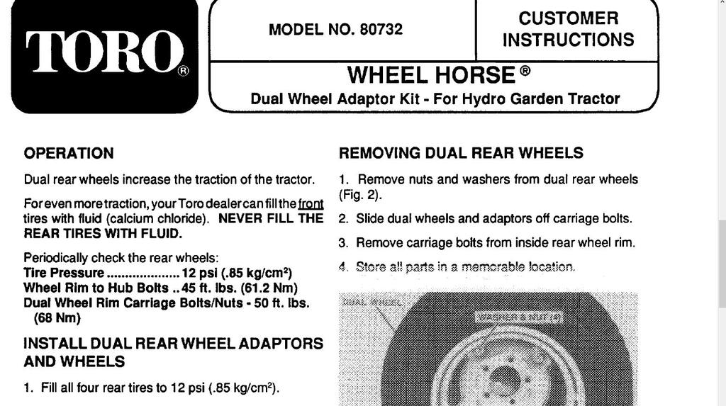

lynnmor 8,899 #27 Posted February 22, 2021 4 hours ago, DennisThornton said: Didn't know WH offered a kit. Got a part number or info? Wonder what was different about the hardening? Don't know the specifics about the hardening. Here is some information: One Two Share this post Link to post Share on other sites

DennisThornton 4,773 #30 Posted February 22, 2021 Never fill! Wonder why? Fill all four rear tires to 12 psi! Wonder why? I'll bet many here will disagree with at least the last! And the first confuses me! Share this post Link to post Share on other sites

pfrederi 20,870 #33 Posted February 22, 2021 Just now, DennisThornton said: Never fill! Wonder why? Fill all four rear tires to 12 psi! Wonder why? I'll bet many here will disagree with at least the last! And the first confuses me! I would suppose they were concerned about the added weight. That would be 292 lbs of rimguard. Special axles but still the same needle bearings to deal with stress leverage of heavy wheels and the issue of stopping it once it was rolling Share this post Link to post Share on other sites

DennisThornton 4,773 #35 Posted February 22, 2021 4 minutes ago, pfrederi said: I would suppose they were concerned about the added weight. That would be 292 lbs of rimguard. Special axles but still the same needle bearings to deal with stress leverage of heavy wheels and the issue of stopping it once it was rolling One of it's biggest advantages of fluid weight is that it's not on the bearings, or is it? Not while static, but what about starting to move, moving and stopping? Is that enough to matter? I don't know, but I'd think not. But it seems most everyone here suggest little to no air on the outside tires! That makes perfect sense to me. Share this post Link to post Share on other sites

DennisThornton 4,773 #40 Posted February 22, 2021 3 minutes ago, pfrederi said: When you are rolling along and one side hits a small rock or root it slows, the other side has momentum. There is front to rear and up and down impact stress on the bearings magnified by the extra 292 pound.stress on the outer needle bearing. Longer axles make the lever effect more severe Yeah, I can see that, but is it significant? I suppose more so with the leverage. Well, all in all, what I was all excited about a few years ago has become, "Nope!". If I had a FEL on a GT AND was lifting high to load a truck, maybe, but I won't as long as I have a compact. Other than that I'm not sure what dual are good for. Especially if they aren't to be weighted! Share this post Link to post Share on other sites
DennisThornton 4,773 #41 Posted February 22, 2021 18 minutes ago, Tj salyers said: Can you leave both tires flat Toro says fill all four to 12 psi. I wouldn't expect the tires to stay on the rim without some air. Why would you want to leave all 4 flat? Share this post Link to post Share on other sites
