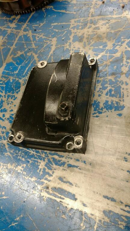

Raider69 124 #3 Posted February 21, 2021 (edited) 2 hours ago, RandyLittrell said: I don't believe so, needs to be trimmed for the shallower pan. Randy That would appear to be correct: (From the Kohler block ID thread) There are many many styles of oil pans to fit the small base block, other brands of tractors use pans in all shapes, and depths so when swapping this style pan you have to watch how long the oil dipper is on the bottom of the connecting rod, it can be cut to fit a shallower pan, WH used two basic pans on this engine a very shallow pan on the early 10 hp and a mid depth on the shaker plate engines. This pan is a shaker style pan used in the late 70's early 80's on the shaker engines This pan is the flat bottom style used on the 1045, 1055, 1075 and 1046 also used on many Cub engines and other brands, the dipper on the connecting rod is very short on the engines that use this pan. This is a deep pan on a Cub engine, I do believe it uses the same dipper as the large base blocks with the big oil pan. Edited February 21, 2021 by Raider69 1 Share this post Link to post Share on other sites

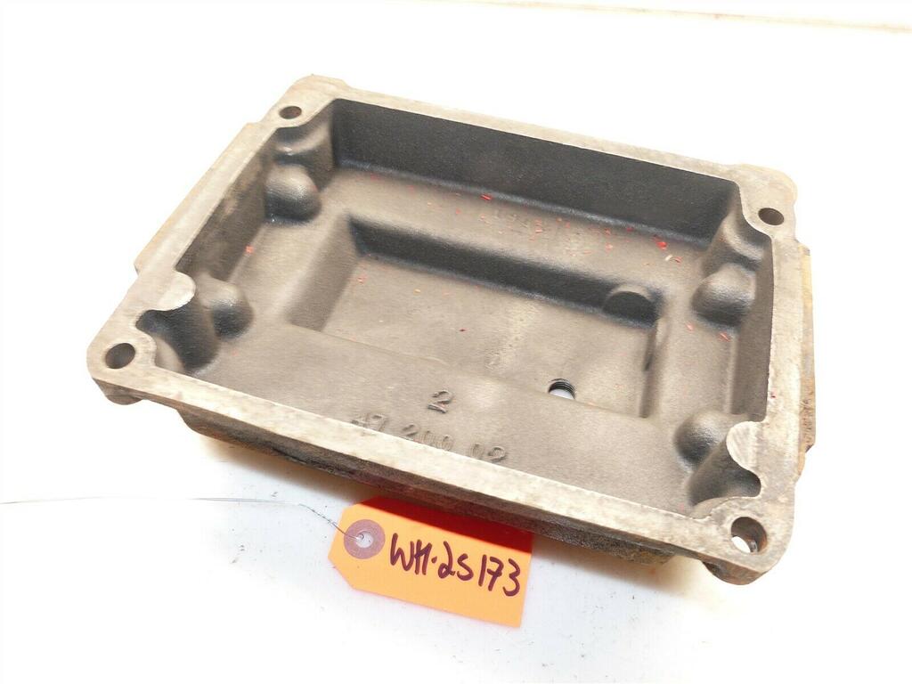

Raider69 124 #4 Posted February 21, 2021 I've been doing some parts manual "archaeology" and if the parts manuals are correct the shaker plate K-301AS in the C-125's used a long dipper connecting rod so I may not have to trim it. Once I have the C-125 pan in hand I'll pull the pan off my engine and clean the gasket surface. I'll put some modeling clay in the sump of the C-125 pan and bolt it on without a gasket then rotate the engine by hand to see if the dipper hits and if not how much clearance it has. Share this post Link to post Share on other sites

Raider69 124 #7 Posted February 25, 2021 The C-125 pan came today, it will be awhile before I can drop the other pan but I measured both from the gasket surface to the bottom on the outside and they are the same depth on the outside so while no guarantee it's quite encouraging. If I do need to trim the dipper it shouldn't be much. 1 Share this post Link to post Share on other sites
