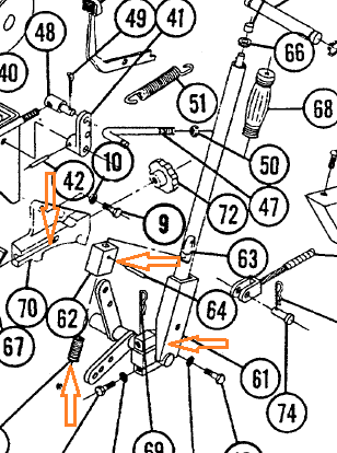

rmaynard 17,527 #4 Posted February 21, 2021 Right below the number 62 is the spring Mike is referring to. I have seen them break. The block right above it, #62 can get gunked up inside the lift arm. #70 where the arm catches could be worn or maybe loose. Get some spray lube with a tube and saturate the entire area as well as pour some down the lift tube from the top. My best guess is a combination of the spring and the block #62. The tab on the side of the block (not shown) may be broken or worn. 3 Share this post Link to post Share on other sites

Pullstart 71,098 #8 Posted February 21, 2021 @Bastkerg if you could create a short YouTube video and post it here, of your lift mechanism, the plow, etc... maybe someone will be able to see what’s going on that might be overlooked otherwise? I have a cast piece #42 on the diagram above that is broken on one of my tractors, allowing travel past the full lift position. Possibly yours has some of the holding nub broken off? 1 Share this post Link to post Share on other sites
rmaynard 17,527 #9 Posted February 21, 2021 3 hours ago, pullstart said: I don’t believe a 704 has the adjuster knob, does it? Take a look at the parts diagram above. That's from the 704 manual. 2 Share this post Link to post Share on other sites

Bastkerg 14 #12 Posted July 18, 2021 Sorry for my late reply. And thank you all SOO much for taking the time to reply. Didn't get around until now to try to fix it. (I'm always impressed how easy wheel horses come apart) My conclusion is spring or block 62. I tried to expand the spring a little bit and it made it feel more solid but it still vibrated loose when riding the mower. Any tips for fixes? I'll try to take it apart and take some pictures before snow plowing season. Share this post Link to post Share on other sites

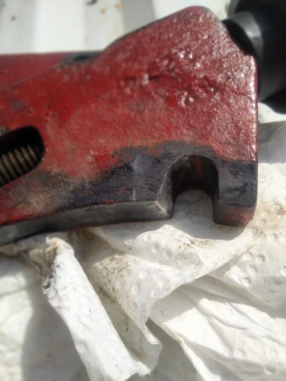

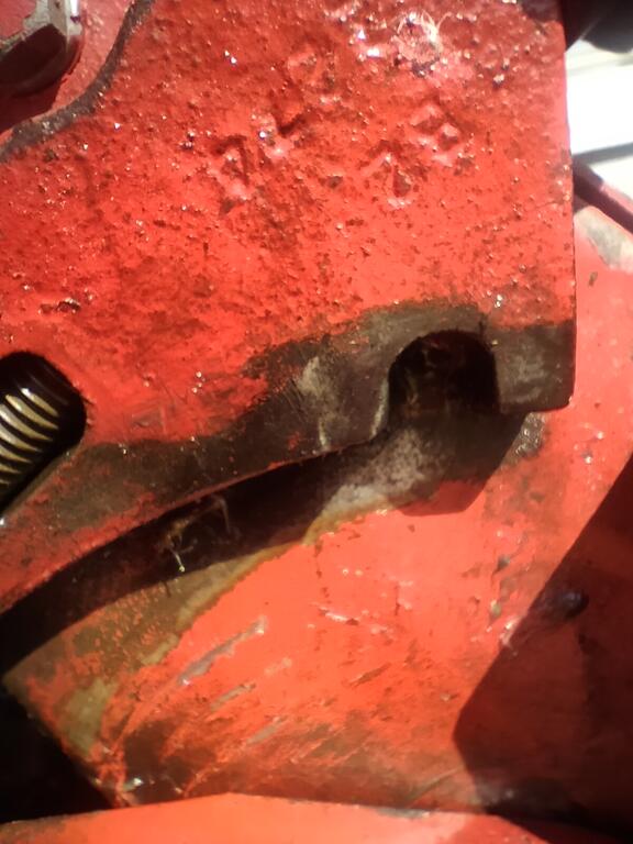

Bastkerg 14 #13 Posted July 25, 2021 Is it this part that is worn too much? Tried some epoxy metal putty but I couldn't get it to stick where it seems to be needed? Share this post Link to post Share on other sites
peter lena 10,014 #14 Posted July 25, 2021 @Bastkerg, your final picture shoes the small amount of angle fitting , you could weld that worn angular slide area , than grind it back to a stronger / tighter fit , or if possible find a better used same part . you might also try welding in a new piece of pipe , sliced on the horizontal , to duplicate the original hold point , pete Share this post Link to post Share on other sites
