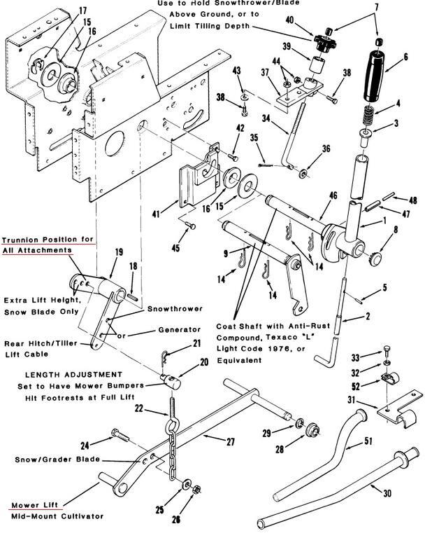

Stubby 19 #1 Posted February 21, 2021 I have a C101 and C105 and I would like to put a hydraulic life on one of them or find a list of models that already have hydraulic lift on it. Unfortunately I have snowblower, deck, tiller, plow attachments and am getting older and I need to try and preserve my shoulder. If I have to change tractor model, hopefully can do so with a attachment compatible model. Share this post Link to post Share on other sites
953 nut 64,094 #2 Posted February 21, 2021 A hydraulic lift will be found on most models that have a hydrostatic transaxle. If your C-101 or C-105 have a hydrostatic transmission then the conversion is something that could be accomplished with some good used parts and a bit of elbow grease. If they are manual shift tractors then an electric lift would be an potion. Either way one of the biggest obstacles would be converting the rocker shaft over. Part 46 would have to be replaced by part 9 and they are usually rusted into part 19 so well that it is nearly imposable to separate them. 2 Share this post Link to post Share on other sites
Stubby 19 #3 Posted February 21, 2021 Yes they are both manual. Maybe I should get a different tractor with hydraulic that is compatible with my attachments and sell these. I have no idea which electric lift I would need to get. Wotrking on them is not an issue just making sure I get the correct parts. 1 Share this post Link to post Share on other sites

roadapples 6,987 #7 Posted February 21, 2021 I'd be looking for a c120 or c160. But, I had a blower on a Raider 10 and it just about pulled me out of the seat trying to lift it. Turns out I had it hooked in the wrong hole. The trunnion #20 goes in the back hole in #19 2 Share this post Link to post Share on other sites
Stubby 19 #8 Posted February 21, 2021 3 hours ago, roadapples said: I'd be looking for a c120 or c160. But, I had a blower on a Raider 10 and it just about pulled me out of the seat trying to lift it. Turns out I had it hooked in the wrong hole. The trunnion #20 goes in the back hole in #19 OMG how stupid. I had it in the wrong hole. Night and day difference now. Thanks Roadapples. 3 Share this post Link to post Share on other sites
