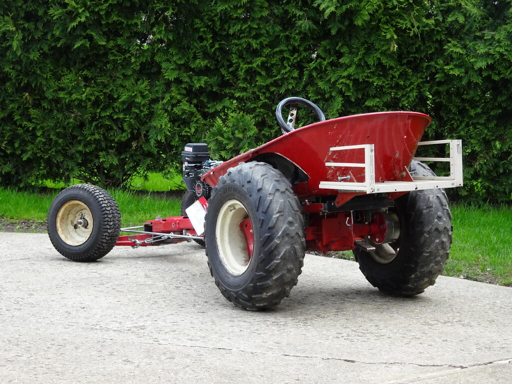

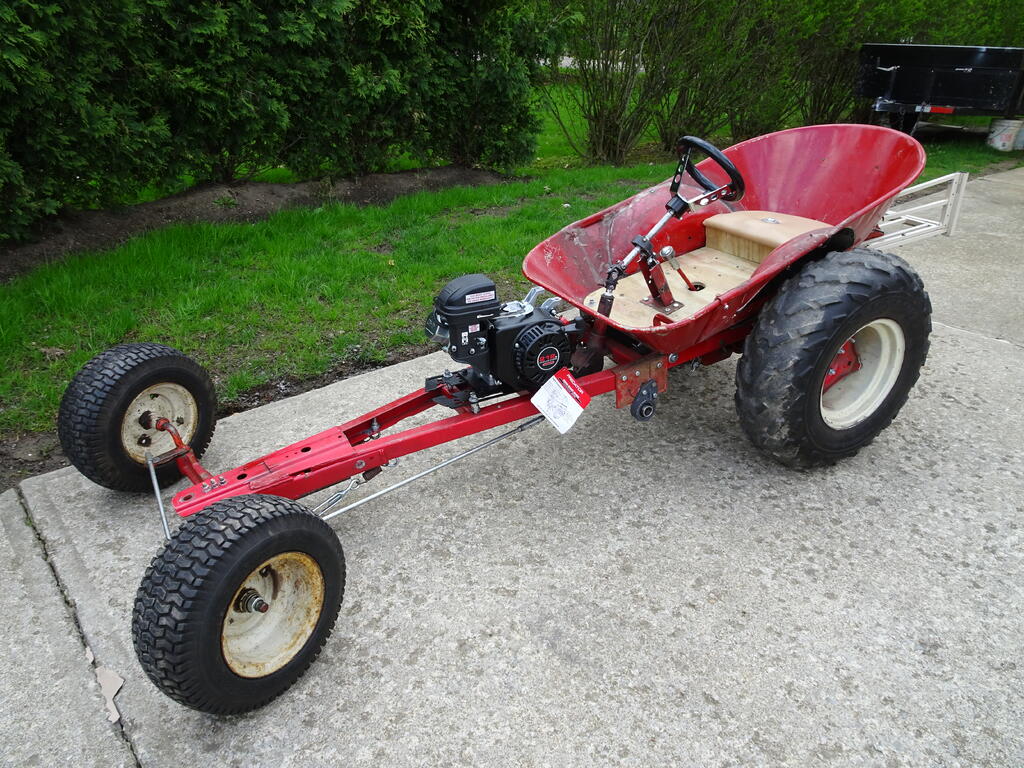

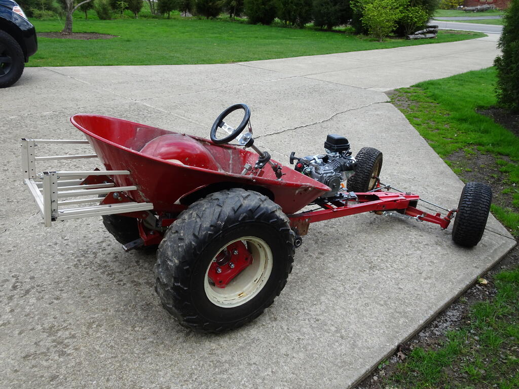

giddyap 1,574 #54 Posted April 18, 2021 With the start of a bed my project has become a bucket T. It still could be a sand rail but I'm not building it for speed. It's almost ready! The front axle saddle must be welded, two belts bought, a gas pedal and all the other adjustments of a custom build. After its maiden cruise I'll call it finished and that might be it for me. 2 6 1 Share this post Link to post Share on other sites

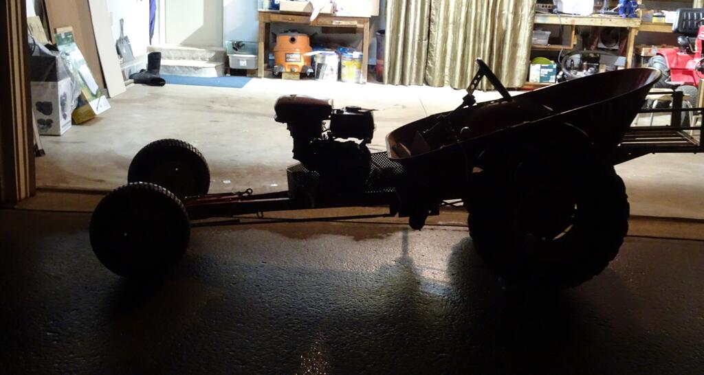

giddyap 1,574 #67 Posted April 22, 2021 I made some improvements that I wanted to show......but decided to wait until I did a little more work on them. Oh what the heck, here's the photo take a look 2 1 6 Share this post Link to post Share on other sites
Tractorhead 9,218 #68 Posted April 22, 2021 3 minutes ago, giddyap said: I made some improvements that I wanted to show......but decided to wait until I did a little more work on them. Oh what the heck, here's the photo take a look Nicely hidden info‘s. take a pict against light ain‘t fair.. 1 2 Share this post Link to post Share on other sites

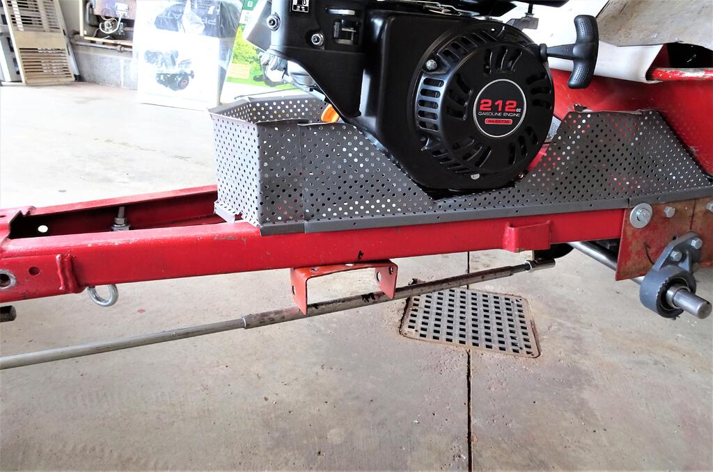

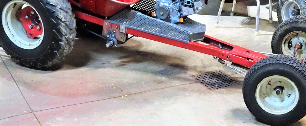

giddyap 1,574 #69 Posted April 22, 2021 (edited) Ok I'll be nice. Instead of a belt guard I made a fence around the complete engine. I need to control the turning radius from the wheels getting locked up. Maybe two stops on the drag link? Edited April 22, 2021 by giddyap 4 1 Share this post Link to post Share on other sites
ebinmaine 81,009 #70 Posted April 22, 2021 3 hours ago, giddyap said: Maybe two stops Excellent idea. Just be sure to make them a little tougher than you think you need. There will be some decent quality dynamic forces there when at motion. 1 Share this post Link to post Share on other sites
giddyap 1,574 #71 Posted April 23, 2021 Before and after "fence" 2 2 Share this post Link to post Share on other sites
