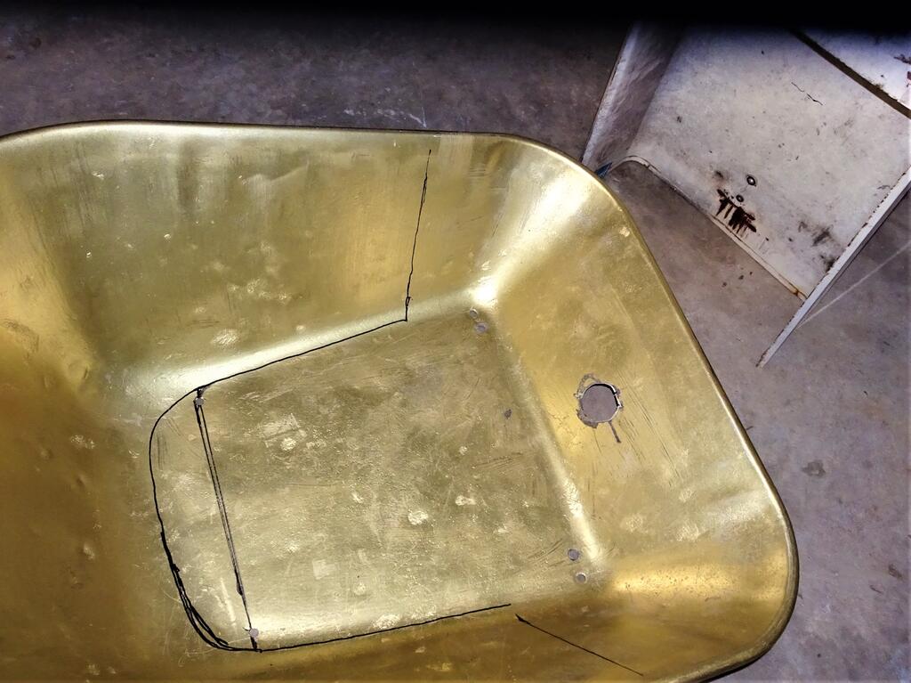

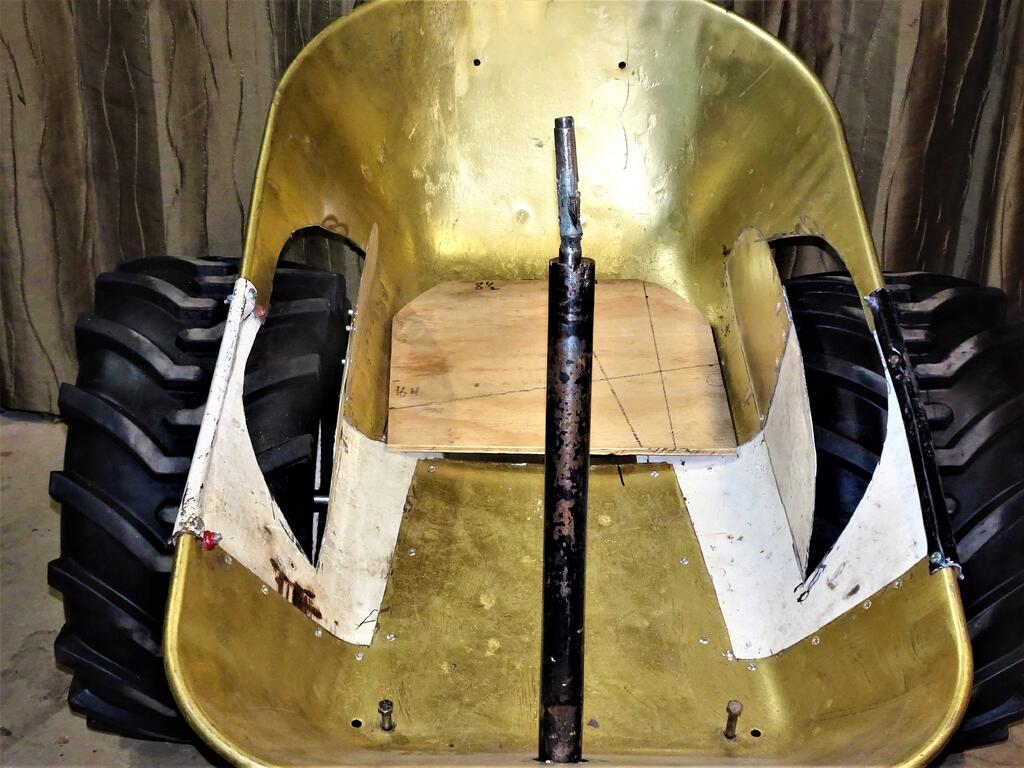

giddyap 1,574 #26 Posted February 23, 2021 19 minutes ago, pullstart said: do you weld? Nope, I drill and bolt everything and also riviting Here is my cut line. After which the front will return to it's position where it has already been bolted down. The back will slide 12". A 12" gap along the sides, a seam along to bottom sides and a 12" gap on the back floor. I plan to cut the Cub hood and use for patches If there are no objections. lol 3 Share this post Link to post Share on other sites
Pullstart 71,468 #27 Posted February 23, 2021 6 minutes ago, giddyap said: If there are no objections. lol Hey, it’s your thing! Awesome creation, awesome ideas! 1 Share this post Link to post Share on other sites
giddyap 1,574 #28 Posted February 23, 2021 Whoopee, For 2 hou'trs starting at 4am I measured and measured again hoping for a perfect cut. Only after the cut is finished do I see the surprise awaiting me. This one is not all that bad. The missing sidewall could have been centered for the wheel openning. On the good side, I can stretch my legs with the 12" expansion. After I conqure a major clean up, I'm taking a well deserved break. 3 2 1 Share this post Link to post Share on other sites

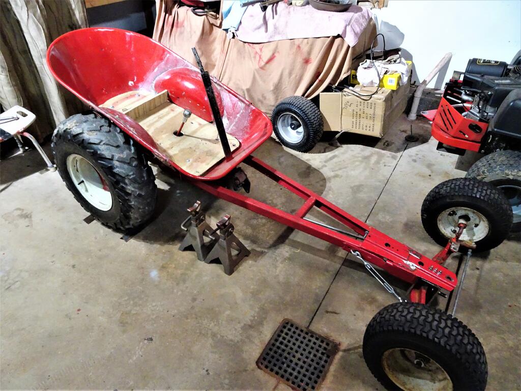

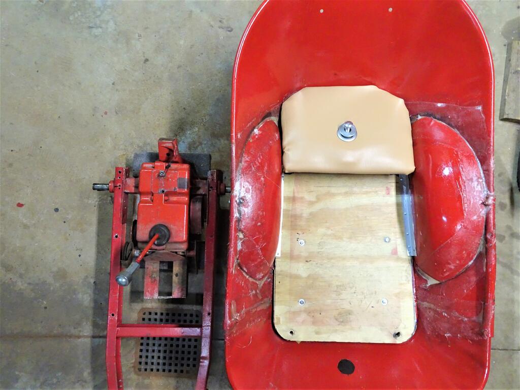

giddyap 1,574 #29 Posted February 25, 2021 S T R E T C H, now my little sporty can haul the soccer team.(before and after photos) Although it may now look like a mini-van I have a component in mind that will once again make it look like a hot rod. BTW I added a mini tower to attach a tow chain 2 5 Share this post Link to post Share on other sites

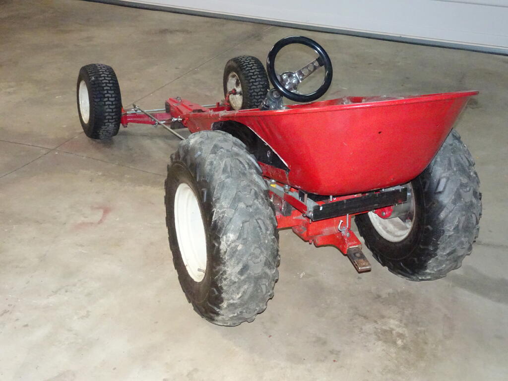

giddyap 1,574 #30 Posted February 26, 2021 Today I cut out the wheel wells in order to get the hubs as close to the frame as possible. Too much axle beyond the frame increases the chance of it bending. But this post compares two different methods, The correct way that dells68 did it, a work of art vs. the way I'm doing it. I'll see how far I can get before "throwing in the towel" lol 7 Share this post Link to post Share on other sites

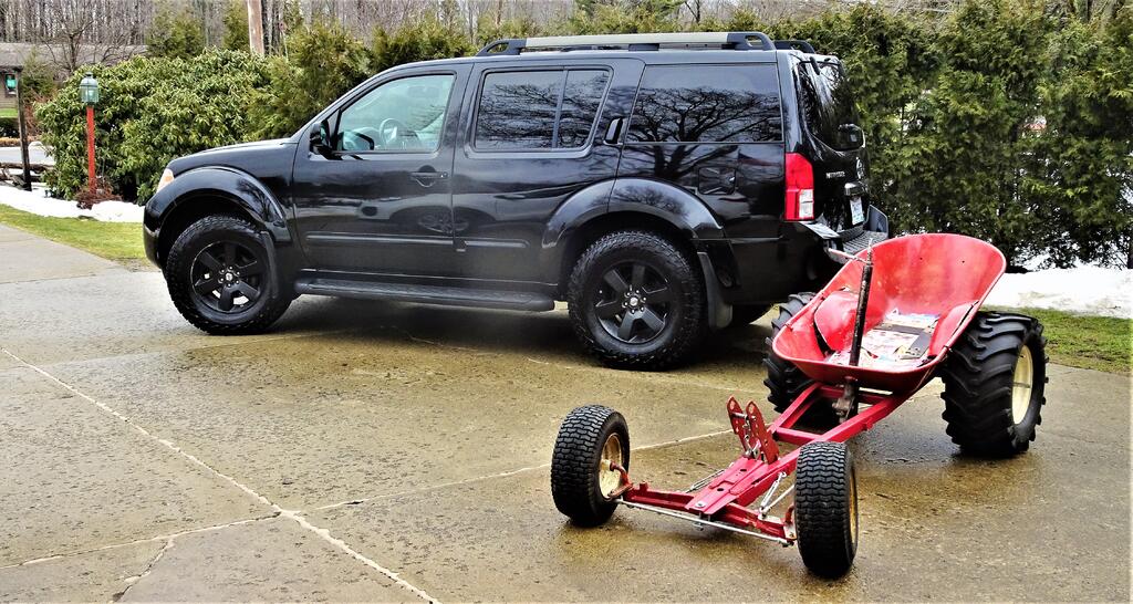

giddyap 1,574 #35 Posted February 27, 2021 (edited) I had to get this photo between rain drops because yesterday I spiffed up my 9 year old Pathfinder. I said spiffed because I no longer wax my vehicles. Yesterday I used "Mothers" CMX ceramic spray coating (Walmart $18). Apply with micro cloth and allow a few minutes for it to bond with the paint. It's a little more effort than a poly coating but it may last longer. And wax has a "layer" which debris embeds intself, not so with the new products. Never wax again. BTW other than a smuge on the camera lens, there is a nice reflection of my wife's car. Edited February 27, 2021 by giddyap typo 2 3 Share this post Link to post Share on other sites

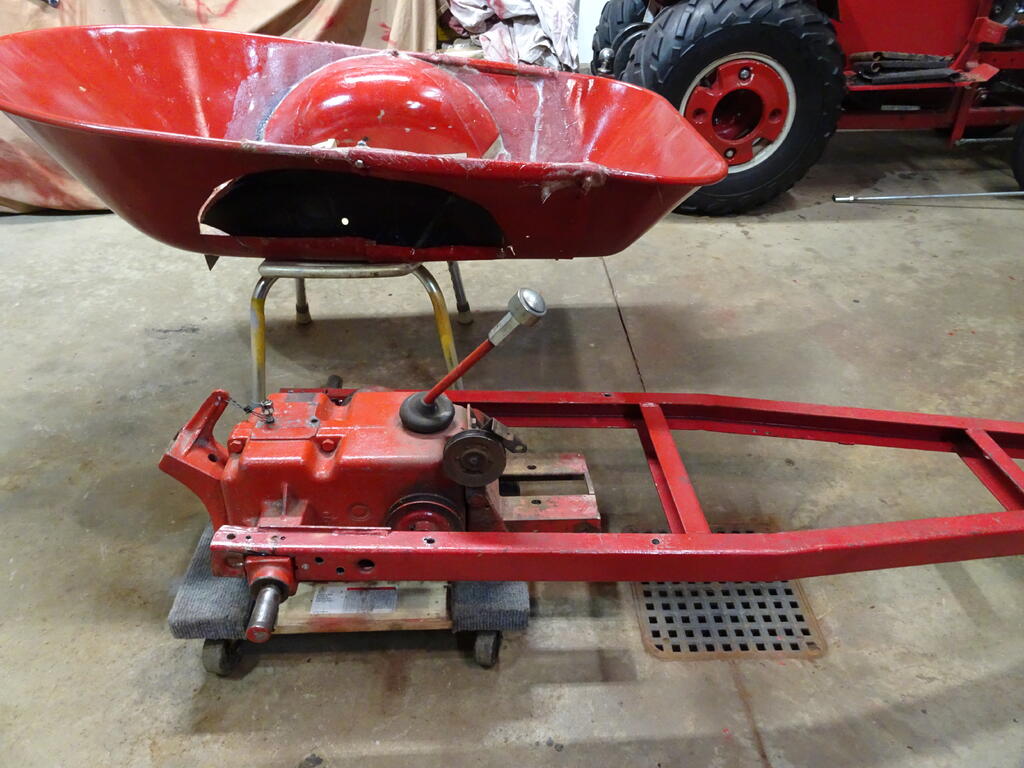

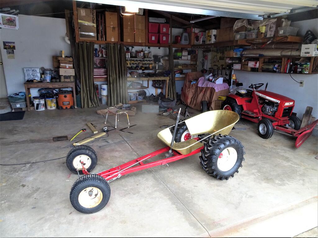

giddyap 1,574 #36 Posted March 19, 2021 Oh Oh My intro said I tried this project before and failed. Now that my last update is 3 weeks old, it appears it happened again. Nope, It's just because I changed gears. I originally planned a go-kart drivetrain but if you examine the photo I will now have those gears to change. I always said building a custom is like one step forward and two steps back. And now with the anticipated spring nearly here, coming yard chores will be putting this project on a slower pace. How it ever gets done amazes me. 6 Share this post Link to post Share on other sites

Jeff-C175 7,211 #40 Posted March 19, 2021 (edited) 2 hours ago, pullstart said: That frame is so resourceful and awesome! It is indeed! I personally might be concerned with frame 'twist' though and look for some ways to prevent that. And with that shifter between my legs, I would definitely want a good seat belt! And maybe wear a 'cup' when driving it! I don't think I would install the 'shifter handle' that I've pictured in my perverted mind either! Edited March 19, 2021 by Jeff-C175 6 Share this post Link to post Share on other sites

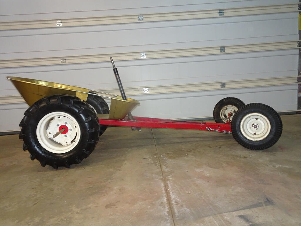

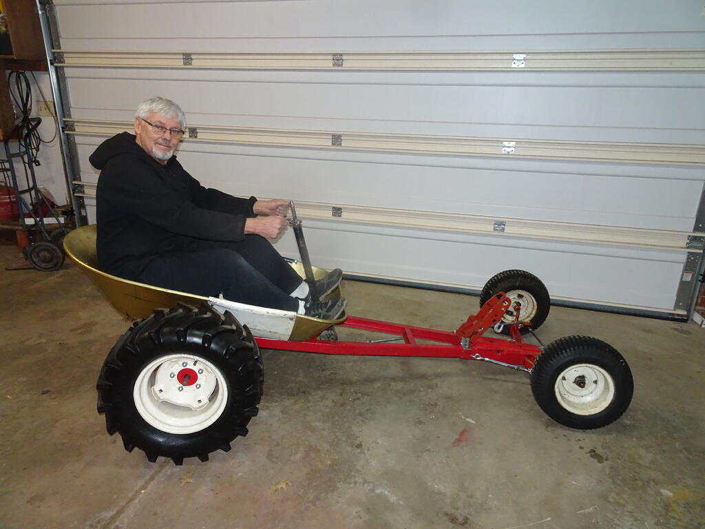

giddyap 1,574 #48 Posted March 22, 2021 A little more headway and a new view 6 1 Share this post Link to post Share on other sites

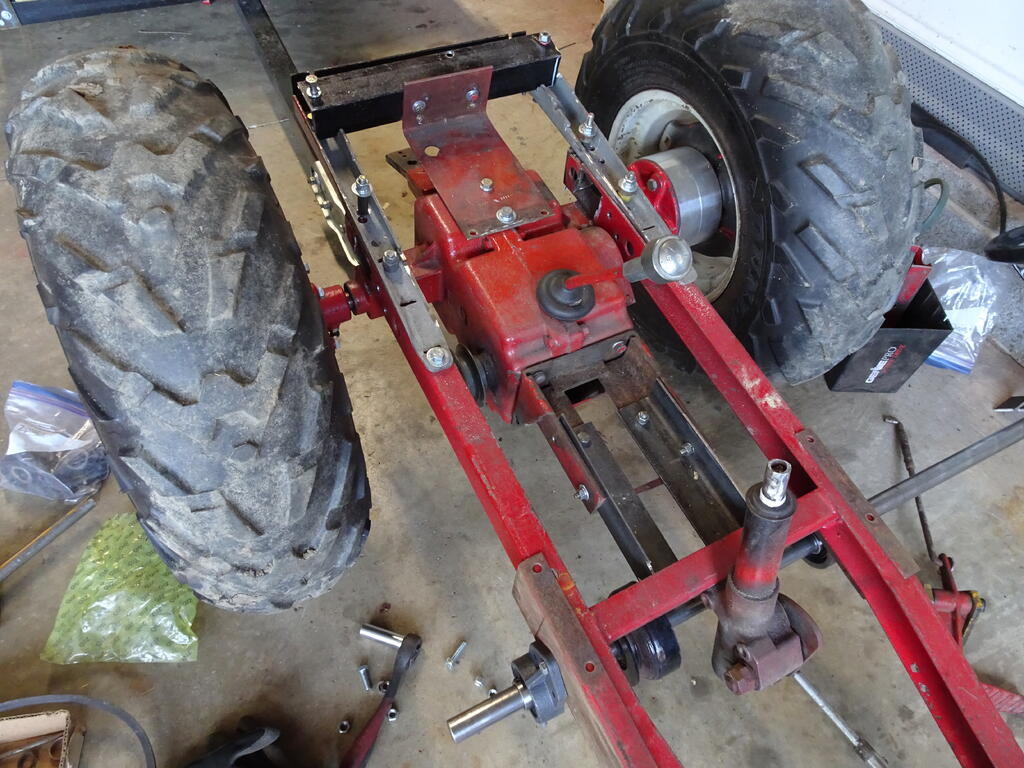

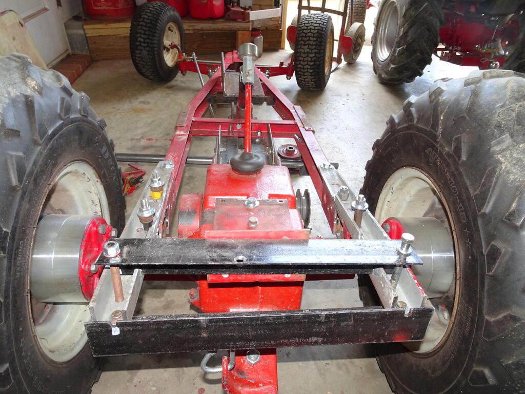

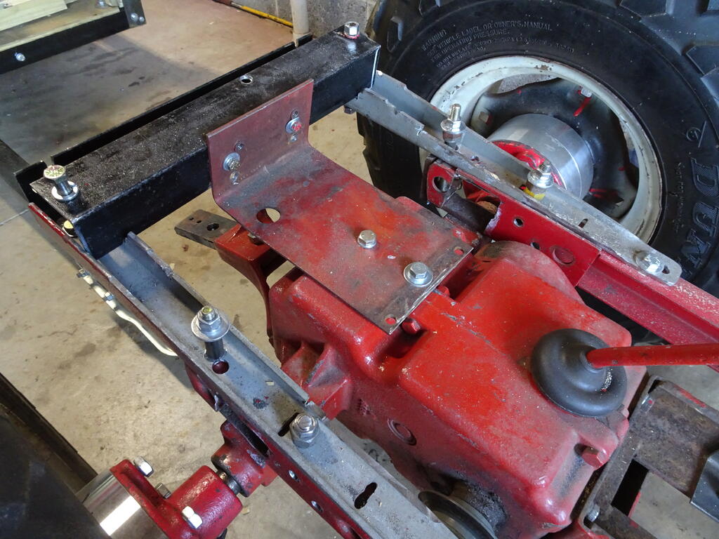

giddyap 1,574 #49 Posted April 9, 2021 All my trade secrets EXPOSED. I reveal parts of my build I missed taking photos of until now. The making of a jackshaft required a complete tear down so I will try to give some details of the mess I made. The frame was extended with HD shelf brackets. The trans plate is flipped and original frame extended with 1/8" 2x2 angle which may seam weak but the transaxle is secured via 4 points. 2 at transaxle plate, 2 at seat/fender and a wide plate to a 2x2 which at each end is the body tie down. If need be I can secure the frame to the axles with a snow plow type bracket. Double 1.5" wheel spacers. To be different the centrifugical clutch will be on the jackshaft. The frame was cut out for the axles which I had to "fix" for the frame to rest on the axles. Have a question? I will try and make an excuse that is believable. 5 1 Share this post Link to post Share on other sites
ranger 1,862 #50 Posted April 9, 2021 Looks like it’s going to be great fun, how are your front spindles secured to the axle? The reason I ask is because I had a circlip come off which was holding one of my C121 spindles to the axle! The spindle detached itself from the axle whilst running over rough ground. Yours being inverted could be worse if they came off. Doug. 1 Share this post Link to post Share on other sites
