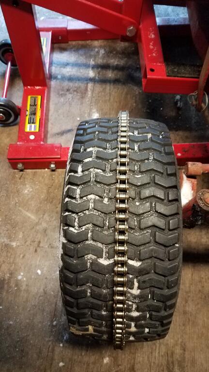

DennisThornton 4,773 #1 Posted February 19, 2021 My little 8HP C-85 has been my main goto for pushing snow for years. I was so happy to mount my first ever 48" blade and eager to push the first snow until I found that it really wouldn't push much snow. So chains! And then it would push some snow but I lost some steering. Filled the tires and pushed heavier snow but lost more steering. Added rear weights and could now for the first time hear most of the 8 horses getting into it, but steering really sucked! Then I added roller chains! OMG! First time ever now I can push the snow banks back with an angled plow! Unbelievable! Thank you @wallfish!!! I don't know if you came up with this idea or just passed it on but WoW! What an idea that I don't think I would have ever come up with! I should have done it long ago but it was just recently that I finally got around to adding the rear weights and could really push but still no steering against an angled load. Great idea John! I think another category or FAQ with top shelf ideas like this would be incredibly handy for all Wheel Horse AND all GT owners, especially newbies! Sidenote: Both of mine fell off within the first few minutes when aired as the picture shoes. I should have taken another picture... Got to have more air pressure to form a recessed area to retain the roller chain. I fitted them as tightly as I could empty then aired up to 25 PSI. Not enough for mine. This time I watched the tire depression the chain was causing as I aired and stopped when it was noticeable. 50 PSI! I released air down to 40. Old hard tires! New ones might not need that much and I've heard success stories at 25 PSI. I was going to grind a shallow recess into the tread if this didn't work at 40 PSI but I just ran it through a torture test and they are both on. Thank You! 3 4 Share this post Link to post Share on other sites

ebinmaine 80,949 #3 Posted February 19, 2021 When I put the set in Trina's 867 a few weeks ago I took the valve stem right out. No pressure even possible. Wrapped it with a ratchet strap and reduced the tire diameter. Shortened the chain 2 or 3 links and using leverage, brute strength, some creativity and several colorful sentences I got them put back in wicked tight mode. Aired up to about 15 or 20 psi and they've been ok. 1 Share this post Link to post Share on other sites

DennisThornton 4,773 #5 Posted February 19, 2021 (edited) 1 hour ago, ebinmaine said: When I put the set in Trina's 867 a few weeks ago I took the valve stem right out. No pressure even possible. Wrapped it with a ratchet strap and reduced the tire diameter. Shortened the chain 2 or 3 links and using leverage, brute strength, some creativity and several colorful sentences I got them put back in wicked tight mode. Aired up to about 15 or 20 psi and they've been ok. I: took the valve stem out wrapped the chain around and cut where it was 1/2 link too small tried putting the chain loop on thought about using a ratchet strap used leverage, moderate strength, both hands and knees, considerable creativity with a hammer and few colorful persuasive sentences and got them back on somewhat tight. Which was my goal, figuring the air would do the rest. Aired up to 25 psi and they came off in minutes... BUT long enough to convince me this was going to happen one way or another! Ordered new ags retried this morning and aired to 40 psi. Maybe my dry rotted, need to be replaced anyway tires were just too hard to depress by 25 psi? Too hard to retain the chains? Don't know but I'm happy now and have 2 new ags coming as a backup! I'll turn them backwards and put the roller chains on them. AFTER I compare performance. I really don't see how ags alone can compete. It's really impressive to see the chain grove tracks! And to finally hear all my 8 horses working together. Edited February 19, 2021 by DennisThornton 2 Share this post Link to post Share on other sites

midpack 1,148 #7 Posted February 19, 2021 Roller chain around the front tires is night and day difference in steering! Think I'm using 99 #40 links for mine. Work them on with a pry bar and run about 15 psi in the tires. They usually stay on pretty well 2 1 Share this post Link to post Share on other sites

DennisThornton 4,773 #11 Posted February 19, 2021 7 minutes ago, midpack said: Roller chain around the front tires is night and day difference in steering! Think I'm using 99 #40 links for mine. Work them on with a pry bar and run about 15 psi in the tires. They usually stay on pretty well I thought about prying but was nervous about these old tires. Prying on and using a ratchet strap are my next tools of choice. 1 Share this post Link to post Share on other sites

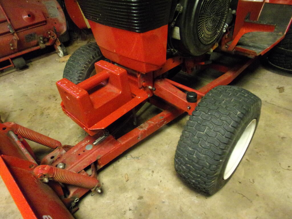

JoeM 10,317 #16 Posted February 19, 2021 This was the old worker a couple year back, 40 pounds of wheel weight. Chains will mark the concrete, but by the time summer came, the marks were gone. 3 1 Share this post Link to post Share on other sites
Ed Kennell 47,600 #17 Posted February 19, 2021 3 minutes ago, DennisThornton said: Ya just gotta do it! I mean WOW! Where did you add the weights? Wheels? I'm guessing my front weighs are about that. I made a weight bracket that attached to my plow side load stabilizer. I did try the roller chain years age when I was still using a blower. One came off while blowing. I made a set of 2 link fronts instead, but I will now try the roller chain again. 2 1 Share this post Link to post Share on other sites
