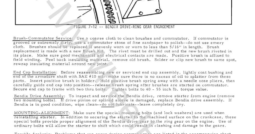

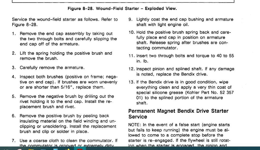

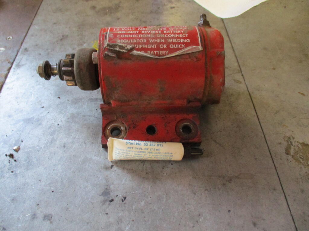

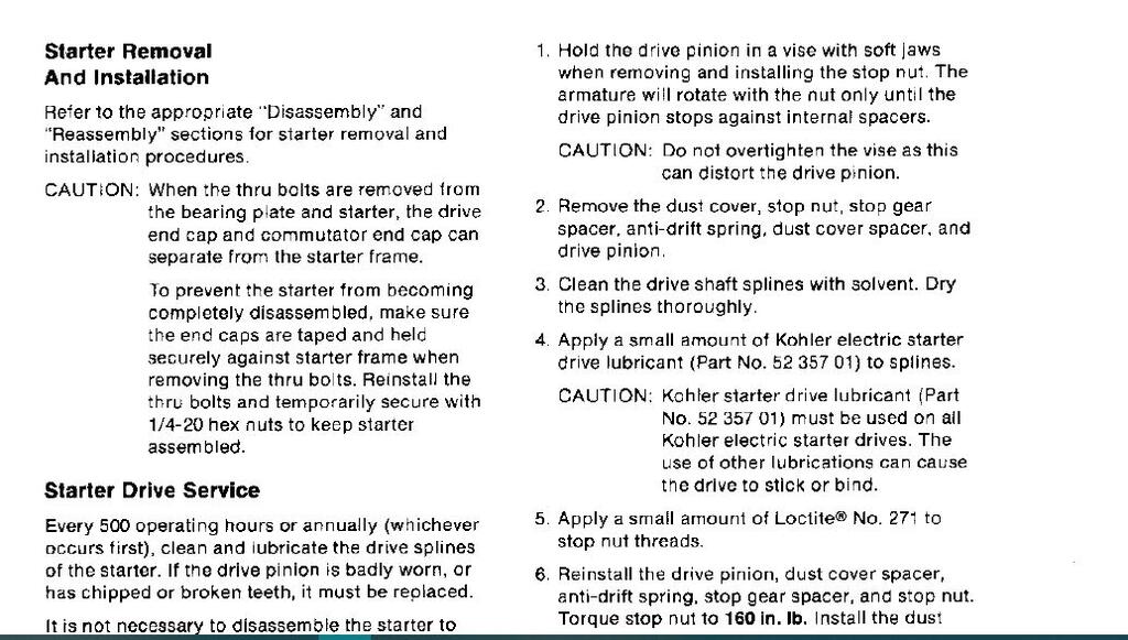

pfrederi 19,241 #1 Posted February 19, 2021 OK so for years I was taught never lube a starter bendix. Went to blow snow and the K341 starter would spin but not engage. That had happened a few days ago and I wrote it off to bad electrical connections so I cleaned them up made a new cable and it worked well. Today same thing. I used screw driver to push the pinion out a couple times the she worked. Pulled the starter motor just now and indeed the bendix doesn't move freely. OK so clean it up but, guidance from Kohler is not consistent. The 9-68 K service manual says no lube. The 11-92 K series manual calls for special lube as does the Magnum service manual. I had actually purchased some a could years ago but never used it. (52 357 01). Seemed to me the flying dust and chaff would stick gumming up the works. However since this is a snow only horse she doesn't see dust (Heck snowblowers don't even have air cleaners) do you think I should use the magic grease??? Share this post Link to post Share on other sites

rmaynard 16,690 #6 Posted February 19, 2021 The local Wheel Horse dealer that I bought parts from told me that Wheel Horse sent a service bulletin stating that dry graphite lube should be the only lubricant used. I have looked, but never found such a bulletin. 3 Share this post Link to post Share on other sites

pfrederi 19,241 #15 Posted February 20, 2021 Well in the interests of science I put the Kohler grease (actually it is from GE) on the pinion and put it back together. Will let you know what happens... In the past i was always a graphite powder type. 1 Share this post Link to post Share on other sites

rick 258 #17 Posted March 12, 2023 Kohler explains in the factory repair manual to use a Kohler p/n lubricant after cleaning the associated parts. When the starter in my '97 314-8 quit working I did as the manual advised with excellent results... 1 Share this post Link to post Share on other sites
