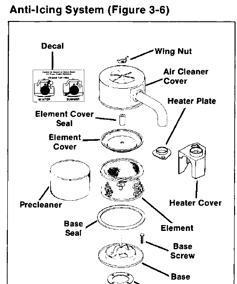

JohnD 145 #15 Posted February 22, 2021 My 1983 KT-17 has an anti-icing system built in. I haven't had any issues so I think you are on the right track. 2 Share this post Link to post Share on other sites
DennisThornton 4,773 #16 Posted February 22, 2021 50 minutes ago, JohnD said: My 1983 KT-17 has an anti-icing system built in. I haven't had any issues so I think you are on the right track. Never seen a preheater for a small engine! Pulls heater air off the exhaust? Share this post Link to post Share on other sites
JohnD 145 #17 Posted February 22, 2021 Yes, it does. We're getting snow here tonight so I can send a photo in the morning. The heater cover sits over the exhaust pipe, so it pulls in warm air almost immediately. 1 Share this post Link to post Share on other sites
Jeff-C175 7,211 #18 Posted February 22, 2021 2 hours ago, JohnD said: 1983 KT-17 That's the air filter I call the "top hat" type. They didn't offer that with the "tear drop" which is what I have. I'm going to do something very similar with mine. Been busy with other project that must be completed by Mar. 3rd. By then I may not need it until next winter, but I'll be ready! Share this post Link to post Share on other sites

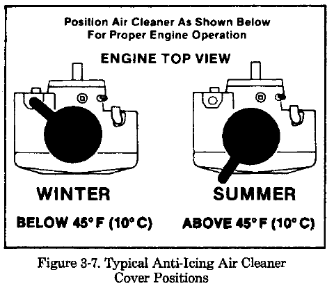

DennisThornton 4,773 #19 Posted February 22, 2021 Funny, almost as soon as I say I've never seen that: 2 Share this post Link to post Share on other sites
JohnD 145 #20 Posted February 22, 2021 1 hour ago, DennisThornton said: Funny, almost as soon as I say I've never seen that: Your air cleaner is rotated 180 degrees from the image on the side. Share this post Link to post Share on other sites
DennisThornton 4,773 #21 Posted February 22, 2021 3 minutes ago, JohnD said: Your air cleaner is rotated 180 degrees from the image on the side. Obviously different and I don't see how the one in the pic works or helps, but it ain't mine. Just a pic I shared. OP has the issue, not me. Share this post Link to post Share on other sites
JohnD 145 #22 Posted February 22, 2021 No problem. Just stating the orientation relative to my photo. 1 Share this post Link to post Share on other sites
Jeff-C175 7,211 #23 Posted February 22, 2021 (edited) 20 minutes ago, JohnD said: air cleaner is rotated 180 degrees Looks like the "Summer" position to me... and it's CHROME! I'm doing very similar with my tear drop air filter. Going to collect air from around the exhaust pipes. I'll post some pics when I get to it. My heat shield started to crack at the same location. Drilled small holes at the ends of the cracks and it's been stable for a few years now. Edited February 22, 2021 by Jeff-C175 2 Share this post Link to post Share on other sites
