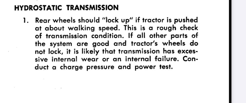

19richie66 17,864 #29 Posted February 19, 2021 (edited) From the Eaton manual the 1100 I put in my gt14 can be pushed and you can hear the balls clacking in the pump until it is pushed quicker and then it locks. Stop it and let sit for a couple seconds and I can push it again. This transaxle came out of a 418-A. My other 418-A and 417-A both could be pushed the same way, same noise and same lock up. Eaton 1100 manual link 👇 https://www.wheelhorseforum.com/files/file/1494-transmission-hydro-eaton-11-sm-492-4205pdf/?do=download Edited February 19, 2021 by 19richie66 1 Share this post Link to post Share on other sites

19richie66 17,864 #31 Posted February 20, 2021 Doesn’t matter. It locks when pushed faster than a slow roll. Belt engaged or disengaged. 1 Share this post Link to post Share on other sites
