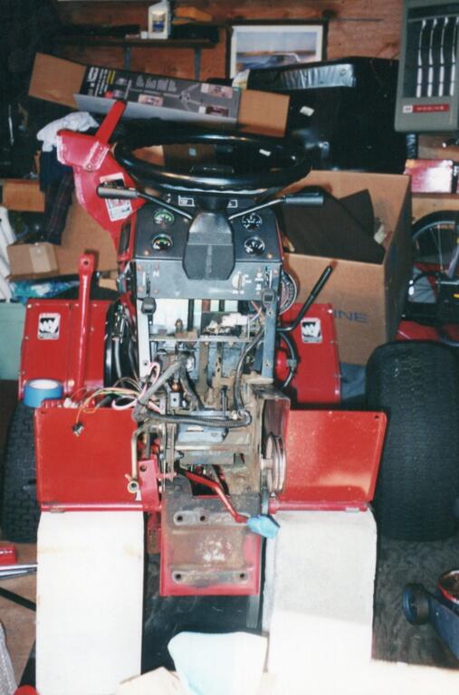

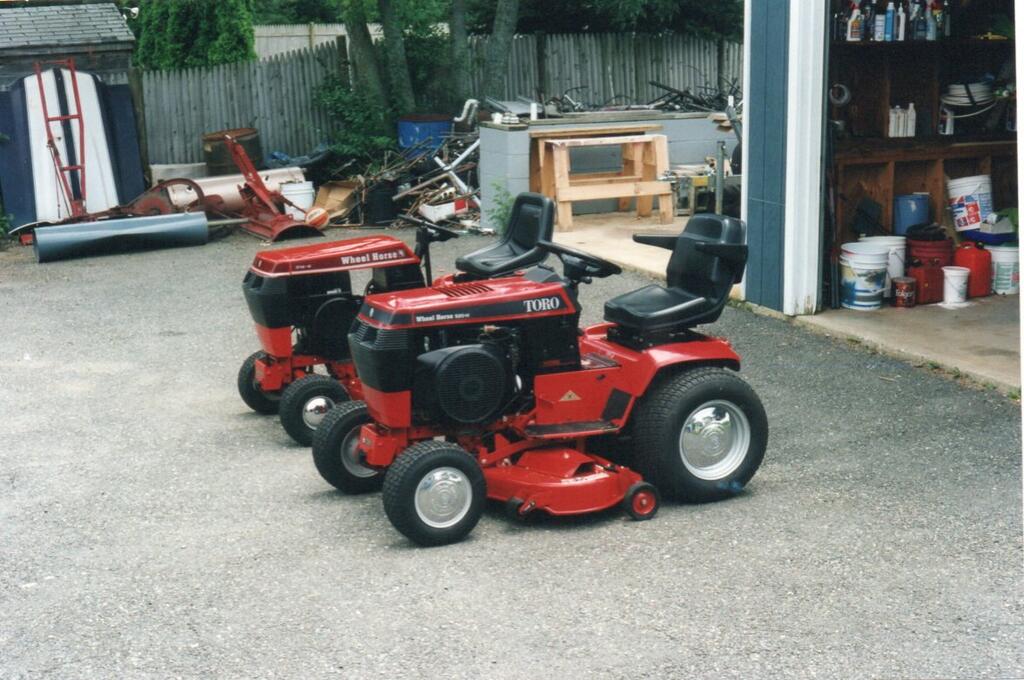

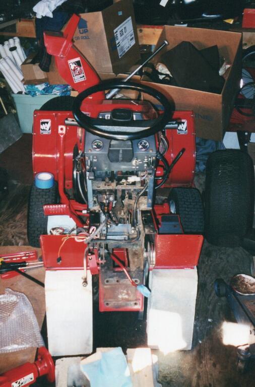

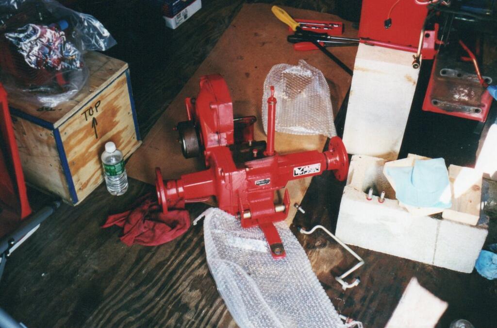

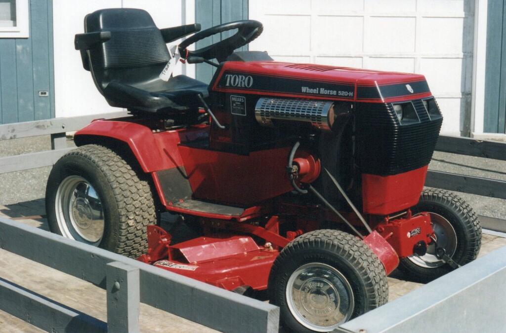

JCM 11,419 #1 Posted February 18, 2021 I have many questions that are unanswered and would appreciate having someone with more knowledge than myself pass that on to me. I will start with a little background first. I bought a 1993 520-H on 6-28-00 with 611 hrs. Did all maintenance required. At 642 hrs the Toro oil filter at the gasket end blew up like a soda can that was left out in freezing weather. ( I do have some of this info on another thread but don't know where) . I then talked to my dealer who called Toro and they gave us the name of a Company in Michigan to send it out for service. The pictures included show the work I did myself to get it ready for shipment and the plywood box I made to ship the pump in. I pulled the complete transaxle out because someone had done work to this before and replaced 1 hydraulic line with a hose which I wanted to install an OEM line. I did also find remnants of Orange permatex gasket maker and knew that could be trouble. Pump came back, reinstalled and never an issue even to this day I believe with the new owner. Questions , Now that I own 3 1100's, 1 on a 91 520-H, 1 on a 418-A and 1 on a 420 LSE wondering what the proper procedure is when I want to push them in the shop or open the door to the outside and push them out. Is this basically forbidden or not such a big deal. In the 520 manual it mentions to push the column mounted Hydro lever forward first. It has been many years since I have tried that but I remember the usual clicking sound then locking up which I think is correct ? On the 418 and 420 it has the dis/ engagement lever, if I pull that up does that allow me to push those but still not recommended. The aforementioned tractors do not lock up, is this normal. Before tranny work pic on the trailer and after pic next to the 89 312-8. Thanks all for your time, much appreciated. Jim 1 Share this post Link to post Share on other sites
