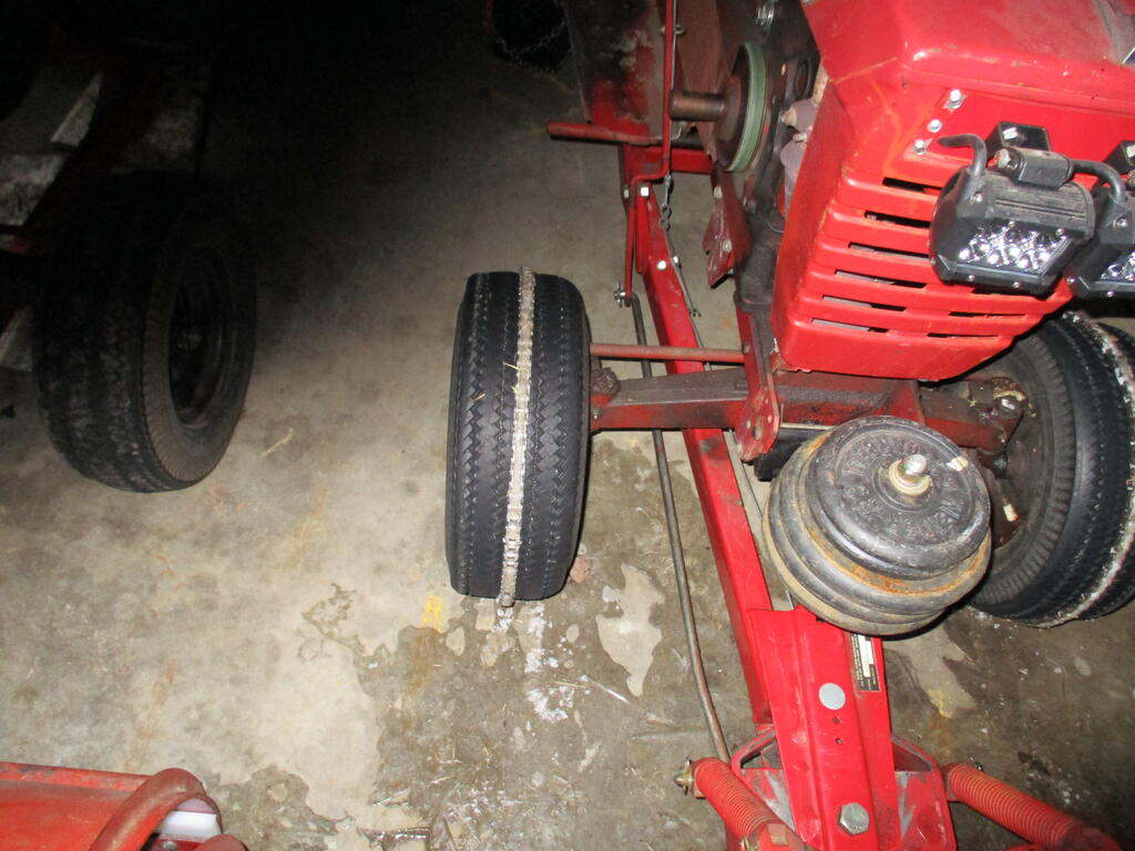

DennisThornton 4,773 #1 Posted February 18, 2021 (edited) My C-85 is getting the front roller chains today. Wonder if they could steer this? No roller chain, no wheel weights front or rear! I don't see enough clearance to angle the front very much. Maybe from the south to deal with that rare 2" snow storm! All the pics I've found... Edited February 18, 2021 by DennisThornton 2 Share this post Link to post Share on other sites
oldlineman 1,800 #2 Posted February 18, 2021 Very good addition best thing I have done for my 1979 c-101. Dennis you won't be disappointed. One note, you will have to keep the tire pressure up or they will work themselves off, an issue with changing air temperatures . Bob Share this post Link to post Share on other sites
SylvanLakeWH 32,140 #3 Posted February 18, 2021 (edited) Cool idea! If it’s light and fluffy I bet you could get away with a couple inches... for a while... but as it builds up I think you will get a fare amount of side pressure that turns / skids the front end towards the wing... The wing will take double the volume of the front blade- all front blade snow plus all wing snow... that’s a lot of pressure... Edited February 18, 2021 by SylvanLakeWH 1 Share this post Link to post Share on other sites
DennisThornton 4,773 #4 Posted February 18, 2021 1 hour ago, oldlineman said: Very good addition best thing I have done for my 1979 c-101. Dennis you won't be disappointed. One note, you will have to keep the tire pressure up or they will work themselves off, an issue with changing air temperatures . Bob Absolutely makes a huge difference! But/AND you are right. I've got 25 psi now and they won't stay on. Now, the tires are real old and actually need replacing. I'm going to order new ones but it would be nice to utilize this idea now. I just moved snow in the sides of my drive that this little horse wouldn't touch yesterday! But then the rollers started to come off... Share this post Link to post Share on other sites
DennisThornton 4,773 #5 Posted February 18, 2021 4 minutes ago, SylvanLakeWH said: Cool idea! If it’s light and fluffy I bet you could get away with a couple inches... for a while... but as it builds up I think you will get a fare amount of side pressure that turns / skids the front end towards the wing... The wing will take double the volume of the front blade- all front blade snow plus all wing snow... that’s a lot of pressure... I completely agree! But I suppose for clearing off sidewalks one pass is enough. I'm still surprised that there's no wheel weights. I just tested the roller chains and they are REMARKABLE! 3 Share this post Link to post Share on other sites
pfrederi 21,049 #6 Posted February 18, 2021 I have had these same chains on for at least three years now never had them come off. The tires are, I am pretty sure, the original 1969 5.50 - 8 tires. I did have to resort to half links.... 3 Share this post Link to post Share on other sites
DennisThornton 4,773 #7 Posted February 18, 2021 27 minutes ago, pfrederi said: I have had these same chains on for at least three years now never had them come off. The tires are, I am pretty sure, the original 1969 5.50 - 8 tires. I did have to resort to half links.... I managed to not have to use half links and they barely went on. Couldn't if they were any smaller. What PSI? 1 Share this post Link to post Share on other sites
oldlineman 1,800 #8 Posted February 18, 2021 (edited) I just air up so there is a distinct impression where the chain is. They will have more chance to slide off when steering hard left or right of course.I actually left most of the air out when I installed mine then aired them up. Bob Edited February 18, 2021 by oldlineman Share this post Link to post Share on other sites
pfrederi 21,049 #9 Posted February 18, 2021 (edited) about 24 PSI Totally drained and did it in eh summer when the tires were more pliable Edited February 18, 2021 by pfrederi 3 Share this post Link to post Share on other sites
DennisThornton 4,773 #10 Posted February 18, 2021 1 hour ago, oldlineman said: I just air up so there is a distinct impression where the chain is. They will have more chance to slide off when steering hard left or right of course.I actually left most of the air out when I installed mine then aired them up. Bob I let ALL the air out and had to use all my skills to get them on the aired up to 25 psi. Still slid and one came off. Share this post Link to post Share on other sites
DennisThornton 4,773 #11 Posted February 18, 2021 1 hour ago, pfrederi said: about 24 PSI Totally drained and did it in eh summer when the tires were more pliable I let ALL the air out and had to use all my skills to get them on the aired up to 25 psi. Still slid and one came off. The tires are so old that I hate to put more air in until my new tires come in. Share this post Link to post Share on other sites

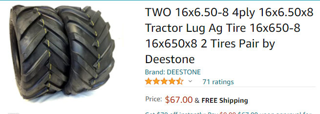

DennisThornton 4,773 #13 Posted February 18, 2021 I just ordered these. I've always thought ags on the front were just for show but I've read a ton here today that turned backwards they do help. I see no issues that would hinder the roller chain. But I would like to keep the rollers on until the new ones get here. Guess I'll try 30 PSI. 1 Share this post Link to post Share on other sites
pfrederi 21,049 #14 Posted February 18, 2021 Don't know why yours wont stay I plow fast flat out a lot of the time (7mph Sunstrand) Lots of turning on gravel . grass and Ice... \ 1 Share this post Link to post Share on other sites
DennisThornton 4,773 #15 Posted February 18, 2021 7 minutes ago, ol550 said: Looks like you are trying to accomplish this. Wow! I live in upstate NY and we have some huge snow trucks but gosh! Share this post Link to post Share on other sites
DennisThornton 4,773 #16 Posted February 18, 2021 1 minute ago, pfrederi said: Don't know why yours wont stay I plow fast flat out a lot of the time (7mph Sunstrand) Lots of turning on gravel . grass and Ice... \ Don't know either. Mine had even more of a groove do to the chain than yours. A few minutes later it I saw it had move inwards then I noticed it hanging. Your tires look better than mine. I've got tread but dry rotted. Well, I've got two ideas, more pressure or grind a slight groove in the treads. Worked so good I'm not giving up on the roller chains! 2 Share this post Link to post Share on other sites
