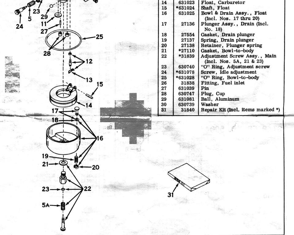

pfrederi 21,301 #7 Posted February 18, 2021 I think there is an internal O ring (#22). If it is old dried out /hard it may be letting the needle turn a new fresh one might create more resistance. Share this post Link to post Share on other sites
