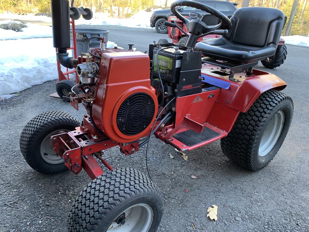

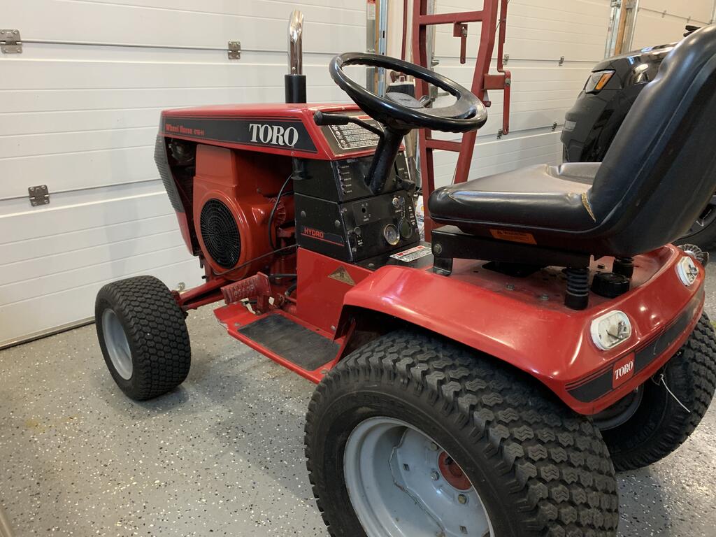

Raposo 532 #28 Posted March 15, 2021 Well she’s a runner! Need to get a longer throttle cable and hook that up and fine tune the carb but she’s moving under her own power now! 1 2 Share this post Link to post Share on other sites
ebinmaine 76,504 #29 Posted March 15, 2021 Looking pretty sweet! 1 Share this post Link to post Share on other sites

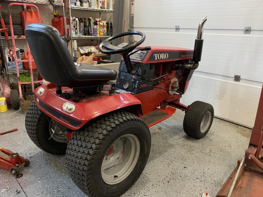

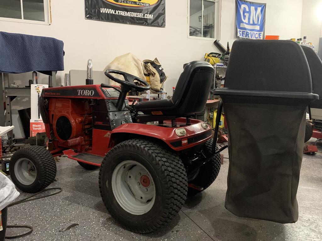

Raposo 532 #31 Posted March 16, 2021 She’s getting there! Now time for the PTO and get the mower deck hung under it 2 Share this post Link to post Share on other sites

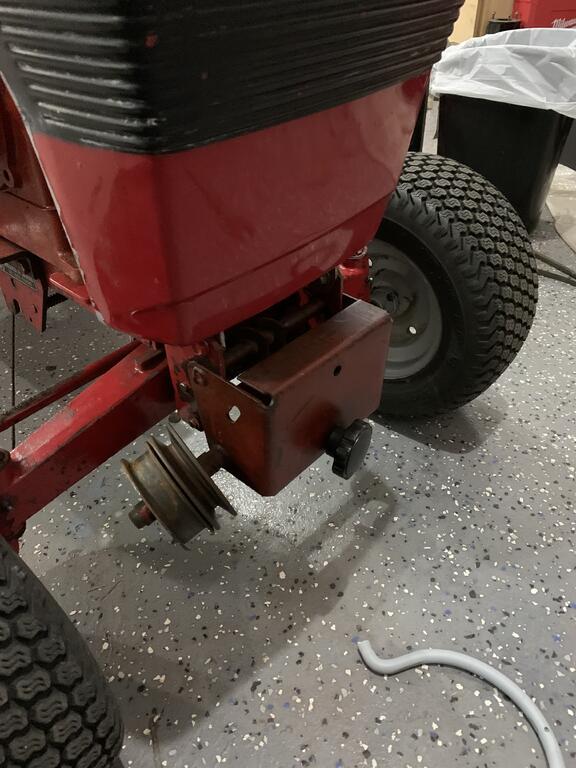

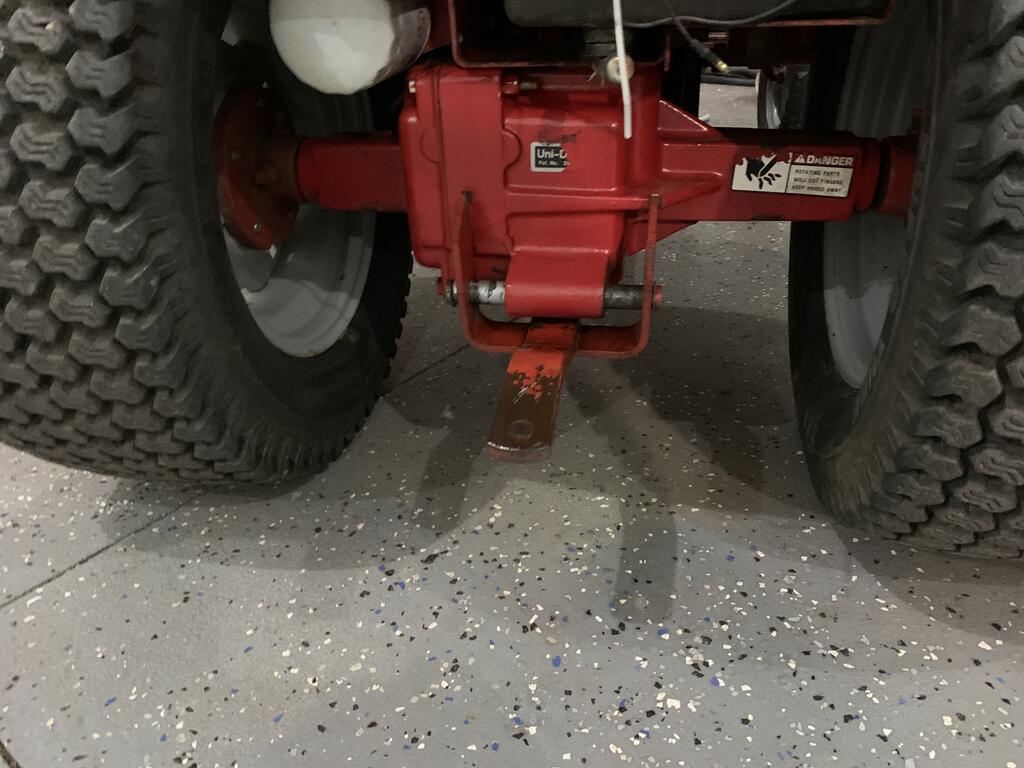

Raposo 532 #32 Posted March 16, 2021 Got the hitch installed and got an older patina’d mule drive mounted up front until I get a newer one I have rebuilt. 2 Share this post Link to post Share on other sites
Bill D 2,500 #33 Posted March 17, 2021 I love the look of those tires on that machine. Any plans for a stack brace? Bill Share this post Link to post Share on other sites
Raposo 532 #34 Posted March 18, 2021 22 hours ago, Bill D said: I love the look of those tires on that machine. Any plans for a stack brace? Bill As of right now, no, I’ll keep an eye on it tho! thank you! I love these tires! They have a great boxed off loom! Share this post Link to post Share on other sites

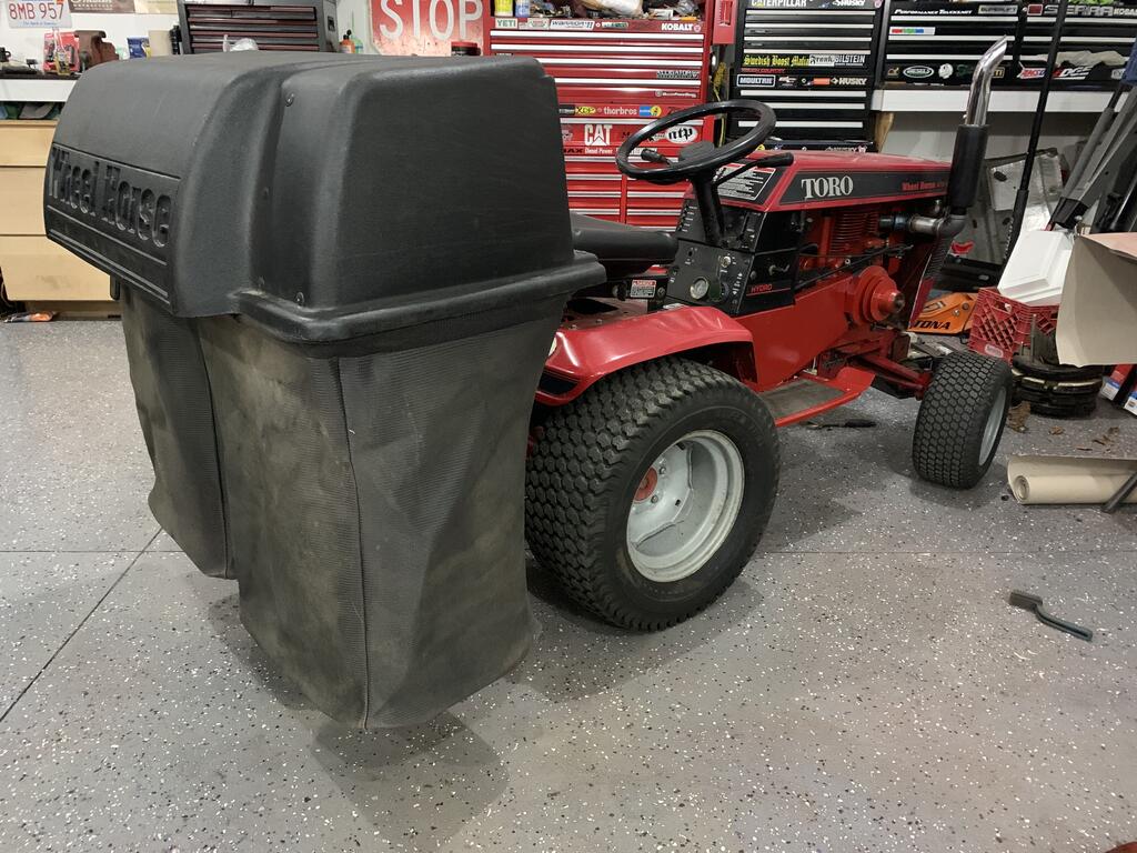

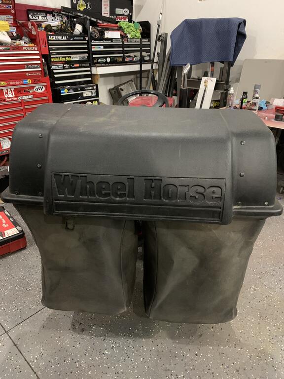

Raposo 532 #35 Posted March 18, 2021 Got the bags mounted! Now I just need the damn mower blades to arrive so I can get the mower deck underneath her and get it all finished up! 1 Share this post Link to post Share on other sites
Raposo 532 #36 Posted March 18, 2021 Another shot! 1 Share this post Link to post Share on other sites

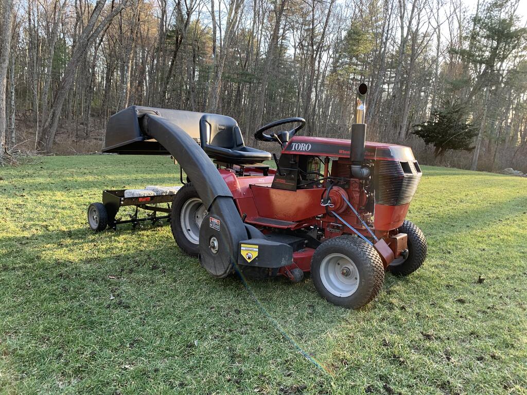

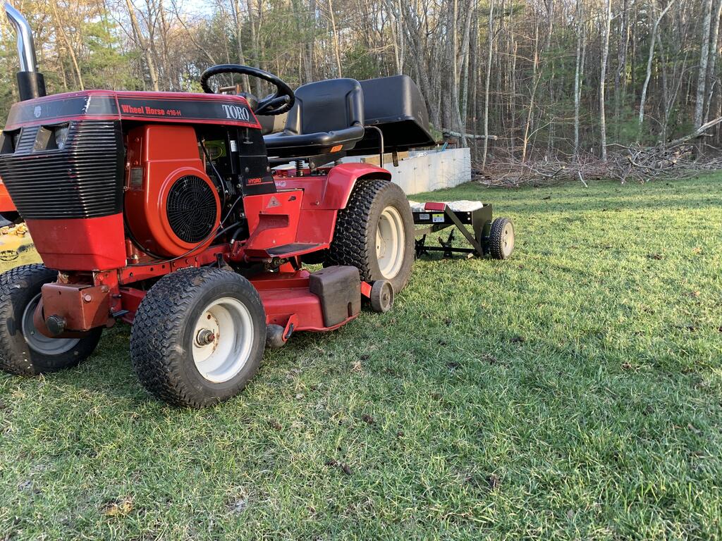

Raposo 532 #38 Posted March 30, 2021 Well guys she’s done! 1 2 Share this post Link to post Share on other sites
Raposo 532 #39 Posted March 30, 2021 Pulled the bags off to tow the aerator around today, ran it for 45 mins and she did great. I did notice the exhaust seems to be a bit hot, what would cause that? Too lean? 1 Share this post Link to post Share on other sites

ebinmaine 76,504 #41 Posted March 31, 2021 11 hours ago, Raposo said: Too lean? Usually that's the case. Yes. Very nice looking tractor you've got there. Share this post Link to post Share on other sites
Raposo 532 #42 Posted March 31, 2021 1 hour ago, ebinmaine said: Usually that's the case. Yes. Very nice looking tractor you've got there. I'll mess with the carb a little more, still don't have it perfect. I'll add a little more fuel. I never remember if tightening the screw is more or less fuel haha. I am very happy with it! 1 Share this post Link to post Share on other sites
rjg854 12,716 #43 Posted March 31, 2021 Tightening the needle valve decreases the amount of fuel, loosening increases the amount of fuel being used. 2 Share this post Link to post Share on other sites
