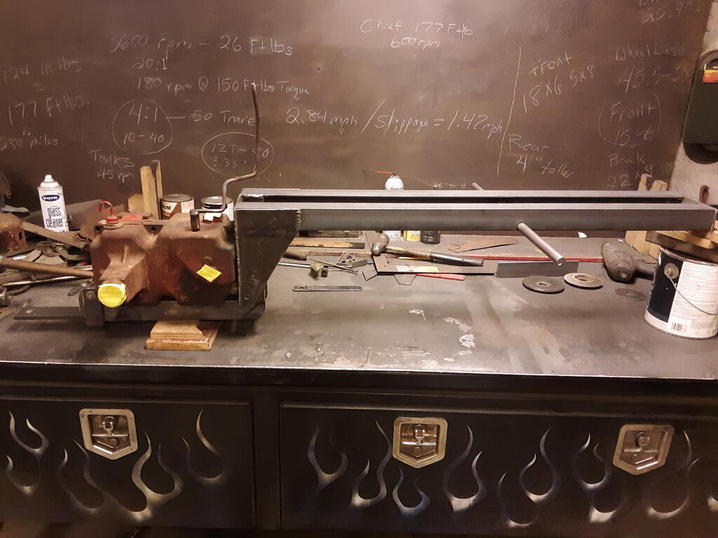

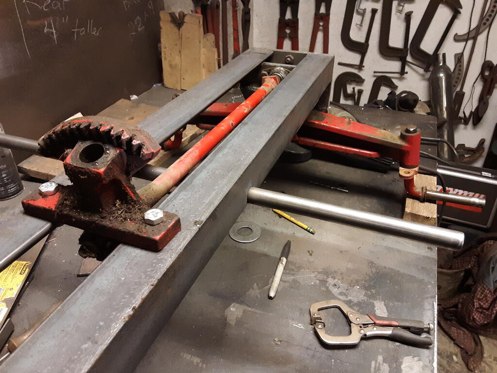

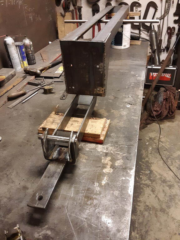

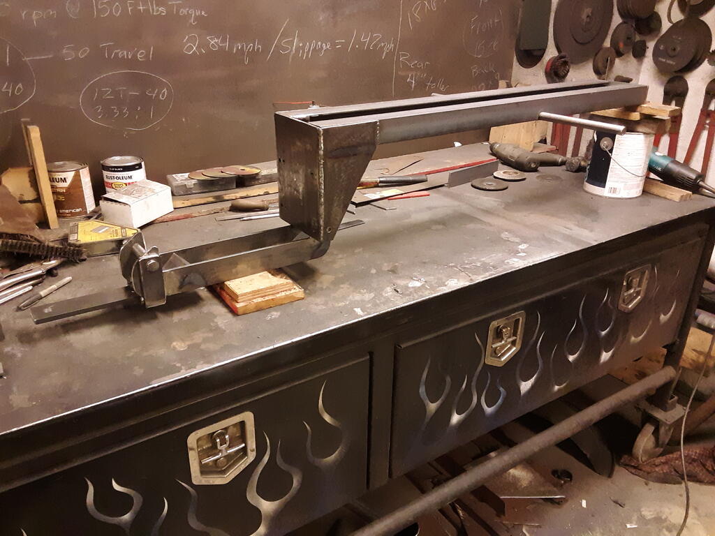

Oldskool 6,678 #79 Posted February 20, 2021 A bit more work on the frame. 1 2 1 1 Share this post Link to post Share on other sites

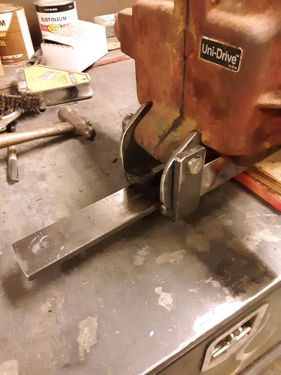

ebinmaine 79,832 #80 Posted February 20, 2021 24 minutes ago, Oldskool said: frame So what's the cradle under the trans for? 1 1 Share this post Link to post Share on other sites
Oldskool 6,678 #81 Posted February 20, 2021 23 minutes ago, ebinmaine said: So what's the cradle under the trans for? Well I figured if I'm building from nothing I might do it to disperse any loads on the trans. Tongue weight from towing is now stretched out over the cradle AND the trans housing. The cradle also runs top to bottom of the trans mounting plate to stiffen that up. 2 1 1 Share this post Link to post Share on other sites
ebinmaine 79,832 #82 Posted February 20, 2021 2 minutes ago, Oldskool said: Well I figured if I'm building from nothing I might do it to disperse any loads on the trans. Tongue weight from towing is now stretched out over the cradle AND the trans housing. The cradle also runs top to bottom of the trans mounting plate to stiffen that up. Well placed idea I'd say. 4 Share this post Link to post Share on other sites

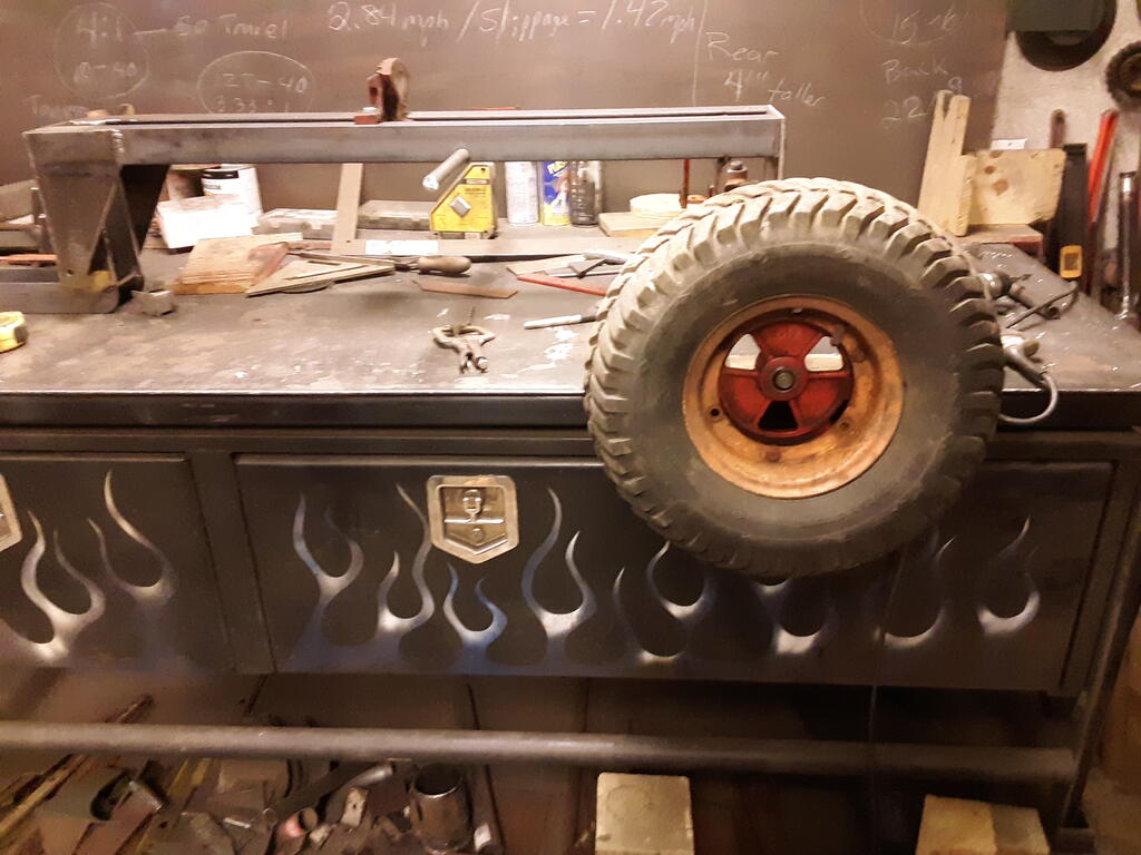

Oldskool 6,678 #83 Posted February 21, 2021 A bit more progress today. Front axle is mounted and some steering pieces. 1 3 Share this post Link to post Share on other sites
SylvanLakeWH 31,860 #84 Posted February 21, 2021 Excellent progress! 1 Share this post Link to post Share on other sites
Oldskool 6,678 #85 Posted February 21, 2021 I'm diggin the front wheels. 4 Share this post Link to post Share on other sites
