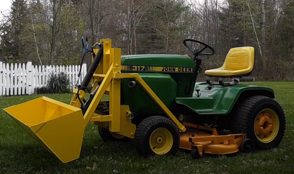

DennisThornton 4,773 #7 Posted February 17, 2021 This still interests me since it doesn't interfere with the mower deck. Not sure yet if it's what I'd use... And these cylinders are too big for this: Share this post Link to post Share on other sites

Handy Don 17,217 #11 Posted February 17, 2021 11 minutes ago, DennisThornton said: This still interests me since it doesn't interfere with the mower deck. Not sure yet if it's what I'd use... And these cylinders are too big for this: I think the cylinders in the ad are longer than the ones in this unit. Here I'd estimate the lift cylinder at 18-20" and the bucket cylinder at 15-16". The ones in the ad are for a larger setup. 1 Share this post Link to post Share on other sites

pfrederi 21,007 #19 Posted February 17, 2021 I am not sure the john deere set up is very heavy duty. What sub frame there is is only on the bow of the tractor. A full subframe that can have a counter weight at the stern would be much better. the set up in the picture would be very unstable if you had a bucket of gravel. 2 Share this post Link to post Share on other sites

DennisThornton 4,773 #22 Posted February 17, 2021 1 hour ago, pfrederi said: I am not sure the john deere set up is very heavy duty. What sub frame there is is only on the bow of the tractor. A full subframe that can have a counter weight at the stern would be much better. the set up in the picture would be very unstable if you had a bucket of gravel. It is marketed as lighter duty that can still leave the mower deck on. I posted it here now because of our conversation about how many cylinders does it take to make a FEL. And I'm sure you are right, a big load of rock would lift the rears off the ground. Would still need some counter balance for anything heavy. Maybe we could call it a mulch loader? Share this post Link to post Share on other sites
