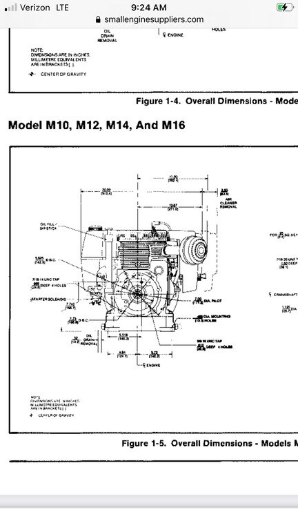

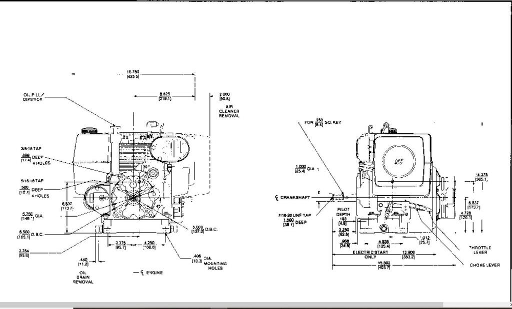

KrazeyOlDave 859 #1 Posted February 17, 2021 Any of you folks happen to know where I can find a legible drawing of the bold circumstances and such? I’ve contacted Kohler and they sent me a.pdf that is a hot mess 🤦🏼 M8 Share this post Link to post Share on other sites
