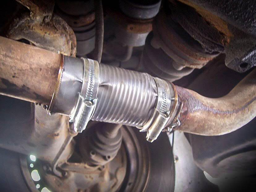

ebinmaine 81,047 #11 Posted February 17, 2021 15 minutes ago, pullstart said: Standard issue catalytic converter substitute pipe 1 1 1 Share this post Link to post Share on other sites
Handy Don 17,634 #12 Posted February 17, 2021 13 minutes ago, ebinmaine said: Standard issue catalytic converter substitute pipe Clearly not running in a place does emissions testing with annual inspections! 1 3 Share this post Link to post Share on other sites
