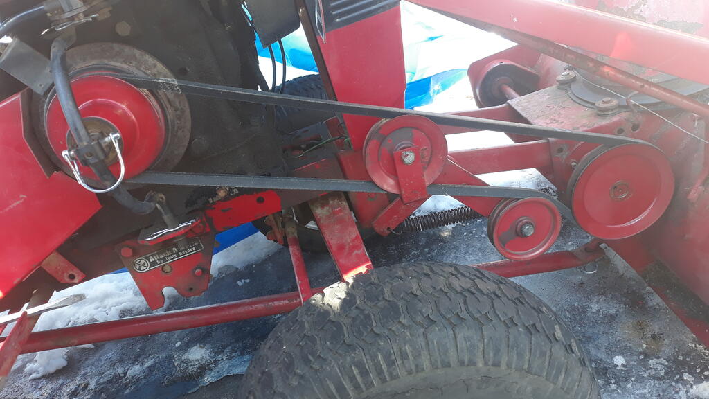

peter lena 9,893 #26 Posted February 20, 2021 NEWBIE, that spring tensioned pulley frame at the front of the frame with your belt issue , should be lubricated at its cross rod to frame area , typically never lubricated , and rusty, if its free to move the belt tension will be better and smoother . on your grease issue , regularly maintain it , more important is the auger chain drive lubricant and adjustment , use a specified chain and cable lubricant on the chain and never let it dry out , adjust chain at the bottom corner out side bolt area , tension should be about 1/2" of play. when properly lubricated , that blower / thrower , will spin by hand , pete 1 Share this post Link to post Share on other sites

artietube 12 #28 Posted February 21, 2021 Alright, got the new belt on. Seems extra tight... Bought belt# 102743 as per the manual. Maybe it needs to stretch out a bit... Haven't started it yet as I need to figure out the chute cable. Only goes halfway to the right. I appreciate everyone's help immensely. Share this post Link to post Share on other sites
pfrederi 20,613 #29 Posted February 21, 2021 (edited) That is too tight and will never wear down to fit. The tractor your blower was designed for a B-80/100 were made in a couple versions I believe (don't have any myself) difference in frame length?? That is a 67" belt. For my blower on a long frame tractor like yours belt is #7950 which is what I run 69" . You might go to Tractor supply get a 69 inch belt. Keep the sleeve clean take back if it isn't right Edited February 21, 2021 by pfrederi 3 Share this post Link to post Share on other sites
artietube 12 #30 Posted February 21, 2021 I was afraid there might be some differences based on age. Oh well. Looks like I get to replace it twice. Thanks for the info. Share this post Link to post Share on other sites

artietube 12 #34 Posted February 25, 2021 Peter, Thanks a bunch for the info. Surprisingly I was able to readjust the chute cable and it's working now. It's old though so I'll take your advice and change a few things when I get brave enough to replace the cable. I took the the advice of pfrederi and bought a 69" belt at Tractor Supply. I'm confident that'll do the trick. I'll have daylight time to change it this weekend and will post a pic. As always, thanks a ton! Without this forum I'd still be fumbling. 2 Share this post Link to post Share on other sites
artietube 12 #35 Posted March 1, 2021 Hi all, Finally got the new 69" belt installed (properly) yesterday. What a difference! Not only was it easier to install but but it didn't bog down so much when I cut into the existing snow bank. Of course, this weeks weather is very mild but should it snow again I'll have the opportunity to give it a workout. Thanks again to all. I literally wouldn't have been able to do this without everyone's input. Greg 2 Share this post Link to post Share on other sites
