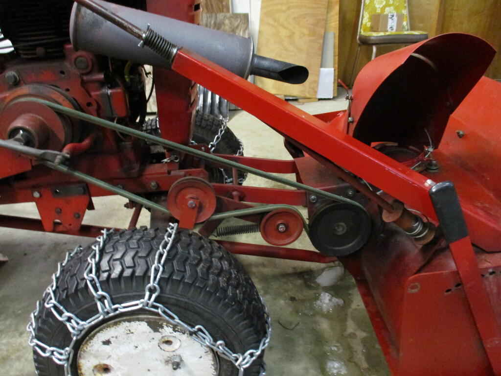

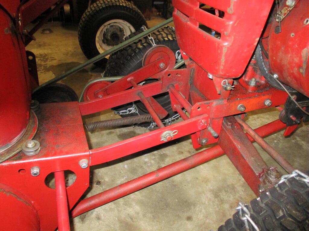

artietube 12 #1 Posted February 16, 2021 Hi all, I'm new here and am hoping I'm not asking a redundant question. I've hunted around quite a bit but don't find the answer I need. I am a new owner of a Toro/Wheelhorse 312-h. 5112-keo (if memory serves). It's from around 1992. With it is a Wheel Horse 6-0202 snow thrower. When I attach it to the tractor (with the belt on the outer spindle) the belt rubs against the top of the frame (where the axle would be). It seems wrong to me and I don't know if it's because the snow thrower is so old that it's not 100% compatible or perhaps that's the way it's supposed to be. Any help will be appreciated. Thanks 2 Share this post Link to post Share on other sites

squonk 48,218 #7 Posted February 16, 2021 Thinking maybe a too long of a belt may cause the V idler pulley to hit the axle. 3 Share this post Link to post Share on other sites

artietube 12 #11 Posted February 17, 2021 (edited) Wow, thank you all for the warm welcome & the info. Here are a couple pics. Hopefully they explain the situation better. For all I know it's perfectly fine but... These seem like great yard tractors with an obvious long history. FTR, I purchased a NOS belt recently. Came in yesterday & I'll be installing it this weekend. Thanks again Edited February 17, 2021 by artietube Share this post Link to post Share on other sites
Achto 32,844 #12 Posted February 17, 2021 (edited) I'm not sure but I think your issue may be shown by comparing these two pics. Yours 15 minutes ago, artietube said: The one that Squonk posted. 16 hours ago, squonk said: Notice the different position of the idle/tension pulleys? Edited February 17, 2021 by Achto 3 3 Share this post Link to post Share on other sites
artietube 12 #13 Posted February 17, 2021 Ahhh, I see that now! So simple. I'll reroute the new belt the correct way. I'm glad it's something simple. Thanks a million!!! 4 Share this post Link to post Share on other sites

1995 520H+96+97 939 #15 Posted February 17, 2021 The belt also looks to be wrong. Its is sitting to deep in the pto and driven pulley. 1 Share this post Link to post Share on other sites
artietube 12 #16 Posted February 17, 2021 It could be a wrong belt for sure. I ordered a replacement based on the diagram in the manual so I'm pretty sure when I get the new one on it'll help the situation. Always something to learn! 1 Share this post Link to post Share on other sites
1995 520H+96+97 939 #17 Posted February 17, 2021 You may have to loosen and/or remove the 3 bolts for the bearing behind the driven pulley, to install the new belt. Is the loop touching the pto bell? 1 Share this post Link to post Share on other sites
artietube 12 #18 Posted February 17, 2021 51 minutes ago, 1995 520H+96+97 said: You may have to loosen and/or remove the 3 bolts for the bearing behind the driven pulley, to install the new belt. Is the loop touching the pto bell? Thanks for that insight regarding the three bolts. I'm afraid I'm not sure what you mean by the loop touching the pto bell. Apologies. Share this post Link to post Share on other sites
artietube 12 #19 Posted February 17, 2021 If I may ask one other question... there's a grease fitting on the auger shaft which seems to take endless grease. Is it filling up the entire shaft? Any info is much appreciated. Share this post Link to post Share on other sites
Handy Don 17,564 #20 Posted February 17, 2021 (edited) 1 hour ago, artietube said: Thanks for that insight regarding the three bolts. I'm afraid I'm not sure what you mean by the loop touching the pto bell. Apologies. I think the PTO "bell" being referred to is the arched metal rod mounted to the motor and frame that, when rotated, presses the PTO pulley against the motor to engage the PTO. Belts should never rub against it. When you re-route your new correctly-sized belt onto the correct sides of the idler/tensioner it should keep the belt from rubbing on stuff. No experience with blowers so it'll be for someone else to respond to the auger/grease question! Edited February 17, 2021 by Handy Don 1 Share this post Link to post Share on other sites

artietube 12 #22 Posted February 17, 2021 2 hours ago, Handy Don said: I think the PTO "bell" being referred to is the arched metal rod mounted to the motor and frame that, when rotated, presses the PTO pulley against the motor to engage the PTO. Belts should never rub against it. When you re-route your new correctly-sized belt onto the correct sides of the idler/tensioner it should keep the belt from rubbing on stuff. No experience with blowers so it'll be for someone else to respond to the auger/grease question! Ah, ok, I get it now. That makes sense. The belt is definitely not rubbing against the bell. The PTO seems to engage very well and the thrower stops as soon as it hits a load. Which leads me to believe that the wrong belt orientation plus the idea that the belt is wrong to begin with are my issues. I was wondering why there seemed to be no load on the clutch spring... duh. As far as the grease situation goes I just want to not mess anything up as I'm a newb to all this equipment. Thanks again to all!! Share this post Link to post Share on other sites
1995 520H+96+97 939 #23 Posted February 17, 2021 The four bearings on the blower I never grease now, replace every 2 seasons. The bell is the pto, the part the belt is on. It looks like a bell when it is on the bench. The loop is the black vertical part. Looks like paint is missing on the bell from the loop rubbing. 1 Share this post Link to post Share on other sites
