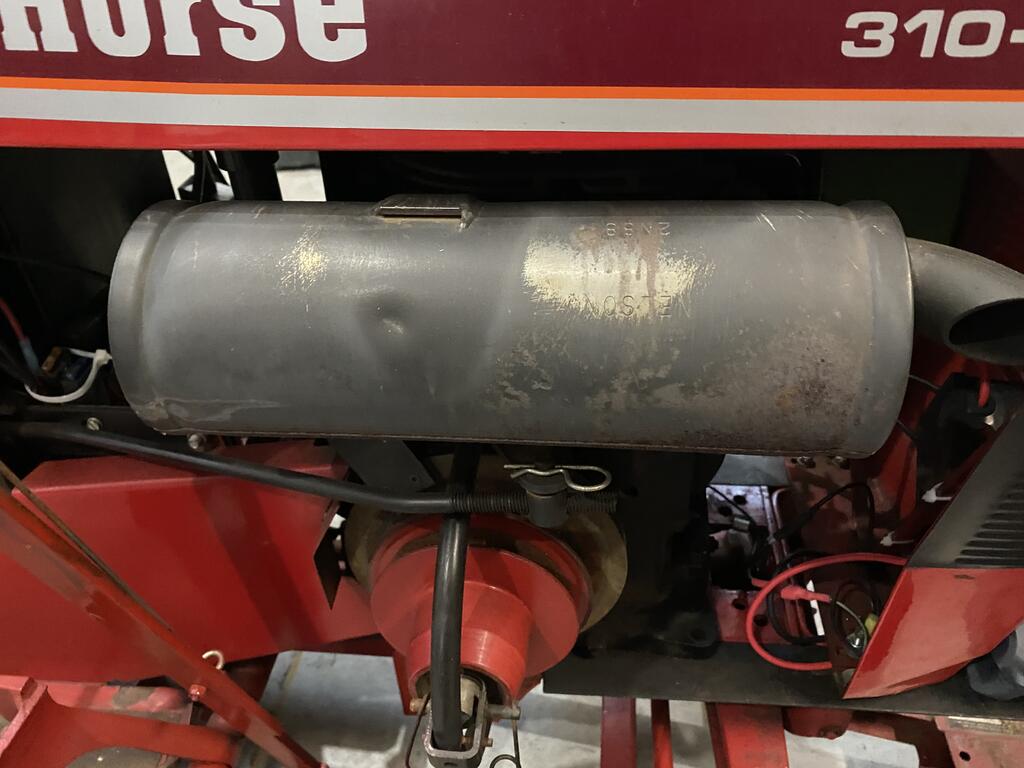

BeninCT 451 #1 Posted February 16, 2021 Mine came with this spot that looks like it was wire wheeled. Anyone have any luck with any black hi heat paint on this? Have to scuff and sand the whole thing obv 1 Share this post Link to post Share on other sites
