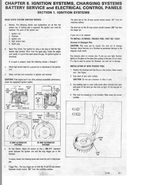

pfrederi 21,301 #3 Posted February 15, 2021 Most solid state ignitions are a binary function...They work or they do not. have you checked the air gap ?? Share this post Link to post Share on other sites
lae1967 35 #4 Posted February 15, 2021 I'll run through the service steps tomorrow, thanks 1 Share this post Link to post Share on other sites

lae1967 35 #8 Posted February 18, 2021 I went through and reset the air gap and it fired right off on starting fluid. Hooked up fuel line and got it running again. Thanks for all the information, I may need to do more with it in the future. Share this post Link to post Share on other sites
