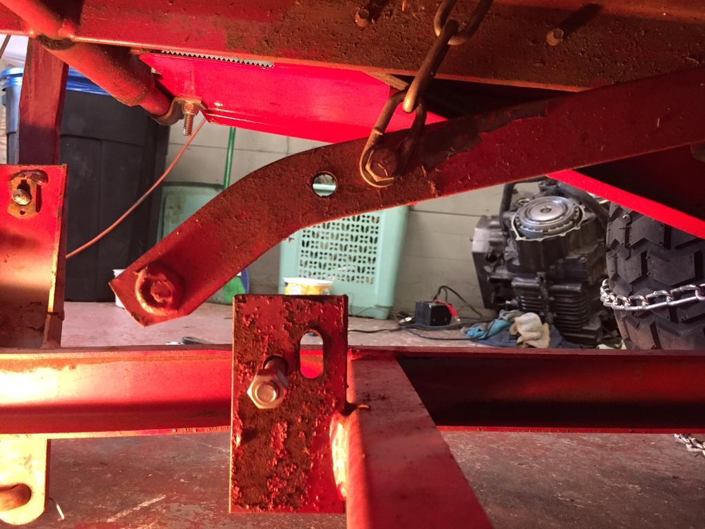

Blackhood Bill 728 #28 Posted February 14, 2021 @Horse Newbie if you look real close at the first pic haydendavid sent zoom in you will see the cross member is on the face of the bracket. Too Much Red’s bracket has the cross member on top. 1 Share this post Link to post Share on other sites
Horse Newbie 7,405 #29 Posted February 14, 2021 1 minute ago, Blackhood Bill said: @Horse Newbie if you look real close at the first pic haydendavid sent zoom in you will see the cross member is on the face of the bracket. Too Much Red’s bracket has the cross member on top. Yes sir, I see that now... I was jumping the gun and commenting too fast before I studied the pics...I apologize. Share this post Link to post Share on other sites
Blackhood Bill 728 #30 Posted February 14, 2021 (edited) @Horse Newbie. When I seen that Drew the pic. You chimed in about Lowell and I just reiterated that he needed to call first. No apologies needed were all here to help all. Edited February 14, 2021 by Blackhood Bill 1 1 Share this post Link to post Share on other sites

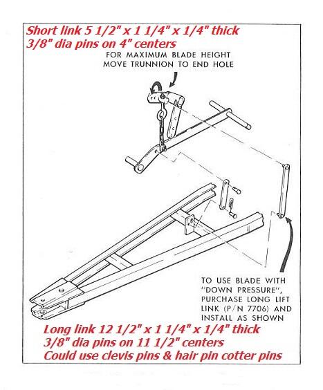

squonk 48,216 #34 Posted February 14, 2021 10 hours ago, Too much red said: One more question (I hope), does anyone have a part number or part name to search for the lift t bar that Pete linked to? My 854 does not have that. You do not need that. Attach a chain or solid link from the tractor lift rock shaft to the slotted hole on the plow. Your tractor does not have the holes to attach the lift bar. 1 Share this post Link to post Share on other sites
Racinbob 13,213 #35 Posted February 14, 2021 You don't have the T shaped lift arm but you do have the rock shaft. Use the longer lift link, p/n 7706, and connect it in the rear hole. You can mont it forward if you want more lift. I had my blade on the 854 for the summer. I used the rear hole on the rock shaft and the round hole on the blade. 1 Share this post Link to post Share on other sites

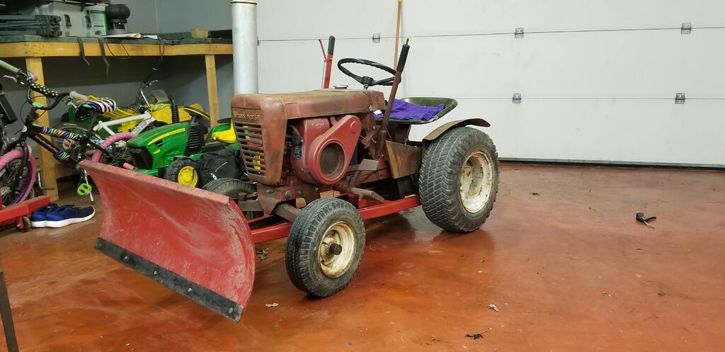

Too much red 65 #36 Posted February 15, 2021 (edited) I just want to say thanks to everyone here for their help. It took less than 2 hours for you guys to set me in the right direction. Then I was contacted by another red square member ( big thanks to him) who was local to me and he helped me get set up with the part I needed. Just now finished up mounting the plow in preparation for the incoming snow tomorrow. Thanks everyone! I'm just writing this little section here to help the next guy down the road who finds himself scratching his head. If you have a short frame wheel horse and you're trying to mount a snow plow that fits both short frame and long frame wheel horses then you need mounting bracket part number 104659. I believe these model snow plows all use mounting bracket #104659. 1968 model 6-4111 - First to fit LONG & SHORT frame tractors and first to mount under the rear axle - replaced by 1969 model [6-4112 + 6-9621] 1970-73 model [6-4113 + 6-9622] 1973-74 model [6-4113 + 6-9623] 1974 model [6-4114 + 6-9624] 1974 model 6-2131 1975 model 6-2132 1976 model 6-2133 1976 model 66-42BC01 1977 model 76-42BC01 1978 model 86-42BC01 1979 model 96-42BC01 1980 model 06-42BC01 1981-1984 model 06-42BC02 (Up to here they are 42" wide) Edited February 15, 2021 by Too much red 1 1 Share this post Link to post Share on other sites
Too much red 65 #37 Posted February 15, 2021 My bad, I can't close this thread without a pic to show you the result of your help! 3 2 Share this post Link to post Share on other sites
