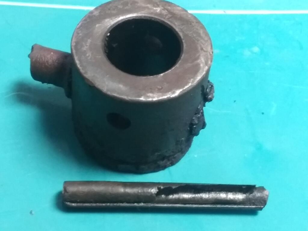

Slimpickins 61 #1 Posted February 13, 2021 Are you experienced enough to know what this part is? Just a little fun pic of what I had to deal with yesterday on the 16 auto. This was the first one for me. Share this post Link to post Share on other sites
ebinmaine 80,635 #2 Posted February 13, 2021 Did that used to be in a steering wheel? 2 1 Share this post Link to post Share on other sites
WVHillbilly520H 10,379 #3 Posted February 13, 2021 I hate roll pins, Cub Cadet used them in their rockshafts and clutch pedals through the frames PITA period. 1 1 Share this post Link to post Share on other sites
rjg854 13,341 #4 Posted February 13, 2021 9 minutes ago, ebinmaine said: Did that used to be in a steering wheel? That would be my guess also Share this post Link to post Share on other sites
Ed Kennell 47,266 #5 Posted February 13, 2021 I've taken some drastic measures to remove some wheels, but never to that extreme. Share this post Link to post Share on other sites
Slimpickins 61 #6 Posted February 13, 2021 Yep the steel was broke in the top half of the wheel so I popped cap and it was full of rust water. 1 Share this post Link to post Share on other sites

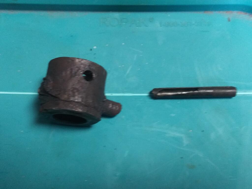

rmaynard 17,575 #7 Posted February 13, 2021 Looks like the motion control arm that triggers the neutral switch. Share this post Link to post Share on other sites
Slimpickins 61 #8 Posted February 13, 2021 My thought was to cut junk wheel away with sawzaw leaving part of the spoke to turn with 2' pipe wrench. So I fired up the hot wrench got her hot and twisted it off no mushroomed shaft .So forgot to say i soaked for a week. 4 Share this post Link to post Share on other sites
