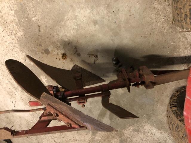

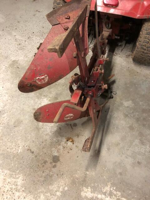

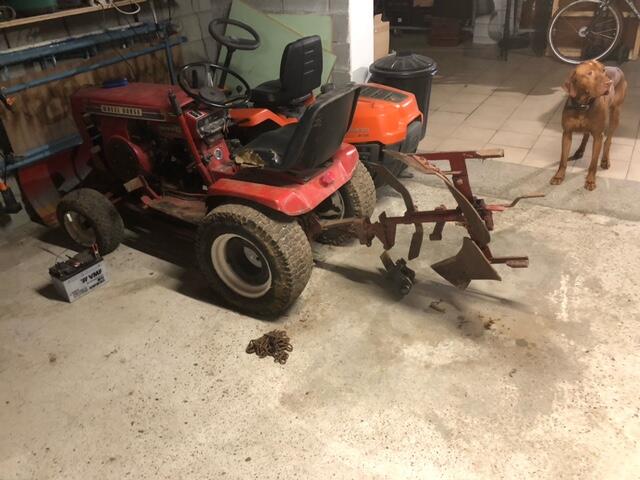

Fille van Diest 31 #1 Posted February 13, 2021 Hello Phil from Belgium , i have found a plow , that belongs to my Raider 10 from 1971 . Is there anybody familiair with this thing ? How to use it , how to lower the plow . I never used it before , it was my gf’s WH . Greetings PHil 4 1 Share this post Link to post Share on other sites

Pullstart 71,367 #3 Posted February 13, 2021 Nice rig! The lift arm on the left will control the plow’s up and down motion. We don’t have plows that flip over like that typically but they are a great idea! Share this post Link to post Share on other sites

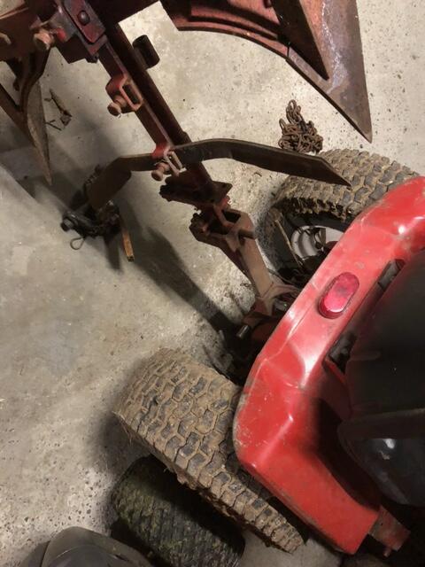

Handy Don 17,564 #4 Posted February 13, 2021 Nifty gadget. Nice score! Connected using a slot hitch and a cable through a tube to the middle of the tractor so the lift lever can raise/lower it. Lets you drive the tractor both ways across the garden but still always turn your furrows to the same side. Clever! 1 Share this post Link to post Share on other sites
Pullstart 71,367 #5 Posted February 13, 2021 Also, I believe that should have a limited slip differential with the six speed transmission. That’s a rock solid setup! 1 Share this post Link to post Share on other sites
oliver2-44 11,782 #6 Posted February 13, 2021 Interesting plow. Is there a mechanism to flip it at the end of the row as others have mentioned. Share this post Link to post Share on other sites

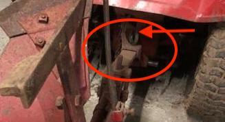

Handy Don 17,564 #7 Posted February 13, 2021 The oval in the image below highlights where the plow has a "tongue" that slide into a "slot" in the tractor-mounted hitch and is held there by a vertical pin through the slot and tongue. The arrow points to the arm on the top of the hitch. A cable connects this arm to another arm in the middle of the tractor that is part of the lift mechanism. Share this post Link to post Share on other sites

Fille van Diest 31 #9 Posted February 13, 2021 Indeed , you cab flip it over and even put them closer together , by turning thé spinner Share this post Link to post Share on other sites
Fille van Diest 31 #10 Posted February 13, 2021 Thé lift arm on thé left is for my snowplow thats for sure . Anyway thanks for all thé reply’s . I will Check it out . Sorry for my bad english 😊 Share this post Link to post Share on other sites
Pullstart 71,367 #11 Posted February 13, 2021 4 minutes ago, Fille van Diest said: Thé lift arm on thé left is for my snowplow thats for sure . Anyway thanks for all thé reply’s . I will Check it out . Sorry for my bad english 😊 Your communication, we can work around! Tractors, they speak for themselves That lift arm mechanism will run any and all lift implements. It pushes forward for snow blowers and other front mounted things, lifts straight up for mower decks, mid mount grader blades and snow plows, and pulls forward to lift the rear hitch as well. Share this post Link to post Share on other sites
