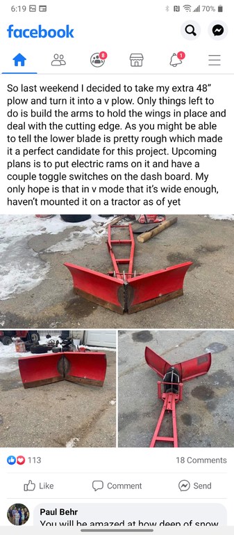

WVHillbilly520H 10,379 #52 Posted February 14, 2021 Something I spotted on FB just a bit ago... Maybe even something like this? 4 Share this post Link to post Share on other sites
ebinmaine 80,953 #53 Posted February 15, 2021 17 minutes ago, WVHillbilly520H said: Something I spotted on FB just a bit ago... Maybe even something like this? That's pretty slick. 2 1 Share this post Link to post Share on other sites
WVHillbilly520H 10,379 #54 Posted February 15, 2021 11 minutes ago, ebinmaine said: That's pretty slick. I thought so, especially after adding the electric actuators, put 1 forward 1 back after going first pass vee? 5 Share this post Link to post Share on other sites
ebinmaine 80,953 #55 Posted February 15, 2021 7 minutes ago, WVHillbilly520H said: I thought so, especially after adding the electric actuators, put 1 forward 1 back after going first pass vee? I been thinking on trying a V plow. Maybe 3 feet each side. I could run up the middle. Then use the sides to push back rows a bit. Then scoop to it's destination. 3 Share this post Link to post Share on other sites

MikMacMike 494 #68 Posted February 15, 2021 (edited) 16 hours ago, WVHillbilly520H said: Something I spotted on FB just a bit ago... Maybe even something like this? Now thats the Horses ass made red heheheh, thats the best Idea I seen yet as sometimes there just isnt enough snow for a single stage snow blower to toss snow, plus at times in wet snow the single stages are just a waste of time, but this takes the cake for sure, wet snow and melted water can be scouped more easily in a inverted V and light snow or how ever much snow your tractor can push in flat and for quick off to the side runs either in a flat or to the side. Now this is what Id build for sure, in fact I just copied the pics because its going on my WH to do list. Hi 5 to WVHillbilly520H Edited February 15, 2021 by MikMacMike 1 Share this post Link to post Share on other sites

MikMacMike 494 #70 Posted February 15, 2021 12 minutes ago, MikMacMike said: Now thats the Horses ass made red heheheh, thats the best Idea I seen yet as sometimes there just isnt enough snow for a single stage snow blower to toss snow, plus at times in wet snow the single stages are just a waste of time, but this takes the cake for sure, wet snow and melted water can be scouped more easily in a inverted V and light snow or how ever much snow your tractor can push in flat and for quick off to the side runs either in a flat or to the side. Now this is what Id build for sure, in fact I just copied the pics because its going on my WH to do list. Hi 5 to WVHillbilly520H HillBilly I dont use my cell for much but phone calls, but if you could could you send me the site of the guy who made that V plow? Im definately going to draft up a drawing for it but Id like to see how he did his first. Share this post Link to post Share on other sites
