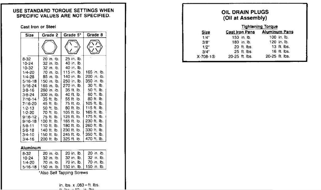

pfrederi 17,040 #7 Posted February 13, 2021 From Kohler service manual 2 2 1 Share this post Link to post Share on other sites
Handy Don 10,439 #8 Posted February 14, 2021 On 2/13/2021 at 10:00 AM, pfrederi said: From Kohler service manual Replying to this to add keywords so it'll come up in a search for: Torque settings for bolts and drain plugs Grade 2 Grade 5 Grade 8 1 Share this post Link to post Share on other sites
