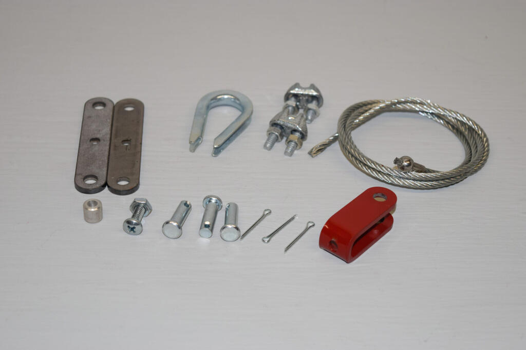

haydendavid380 759 #1 Posted February 12, 2021 Are there detailed instructions on installing one that previously hasn't had one? Is everything included in the kit from Lowell? 2 Share this post Link to post Share on other sites
R Scheer 525 #2 Posted February 12, 2021 That looks like everyghing, the kit I bought from Lowell had everything I needed. I believe you have to specify hydro vs manual, the tube the cable runs in is different. 1 Share this post Link to post Share on other sites

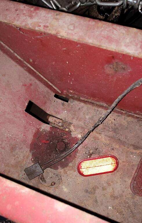

haydendavid380 759 #5 Posted February 12, 2021 34 minutes ago, squonk said: It's pretty much self explanatory as long as you have the holes in the rear of the tractor to mount it. If you don't, are they unable to use them? Where I assume the cross piece goes theres small pin holes, almost like marking a spot to drill, but certainly nothing big enough to drop parts right in. Share this post Link to post Share on other sites

Blackhood Bill 728 #8 Posted February 12, 2021 @haydendavid380 Inhave purchased one from Lowell. Amazing piece. Very simple to install. But as stated above there is a different tube for a hydro versus a geared machine. Yes there is a hole already there for the cable to slide thru predrilled. I don’t remember if it came with instructions. I’m some of us here could take a picture or two if you needed it. Share this post Link to post Share on other sites

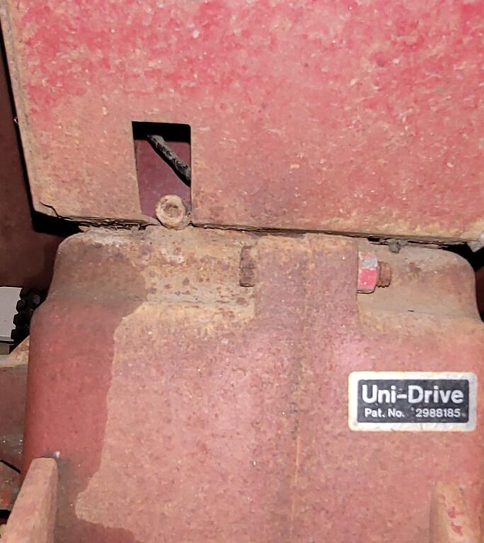

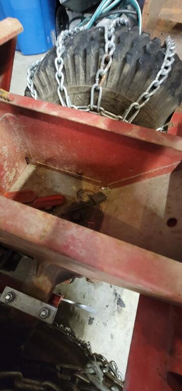

haydendavid380 759 #15 Posted February 14, 2021 Thank you! So if I'm reading that right, all I need is this? There should be a tunnel or tube on my tractor right? Share this post Link to post Share on other sites
haydendavid380 759 #16 Posted February 14, 2021 I'll be darned, I've looked for that tube multiple times but there she is. Share this post Link to post Share on other sites
Handy Don 17,563 #17 Posted February 14, 2021 Just now, haydendavid380 said: I'll be darned, I've looked for that tube multiple times but there she is. Looks like you'll have a bit of a task clearing out the tube! There is some debate among members on lubrication in there. Some like good grease but others think it attracts/retains dirt that causes wear in this very exposed location so they use no lubrication. Some think graphite is the way to go. My cable is plastic coated and self-lubricating (way to sidestep the debate, eh? ). All up to you! Share this post Link to post Share on other sites
