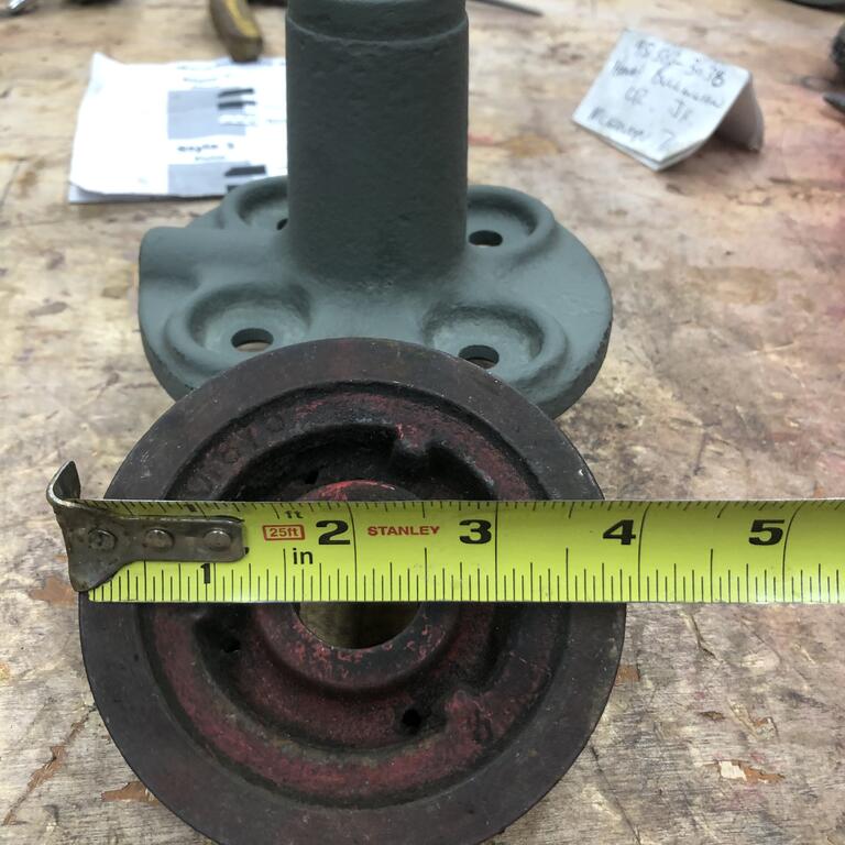

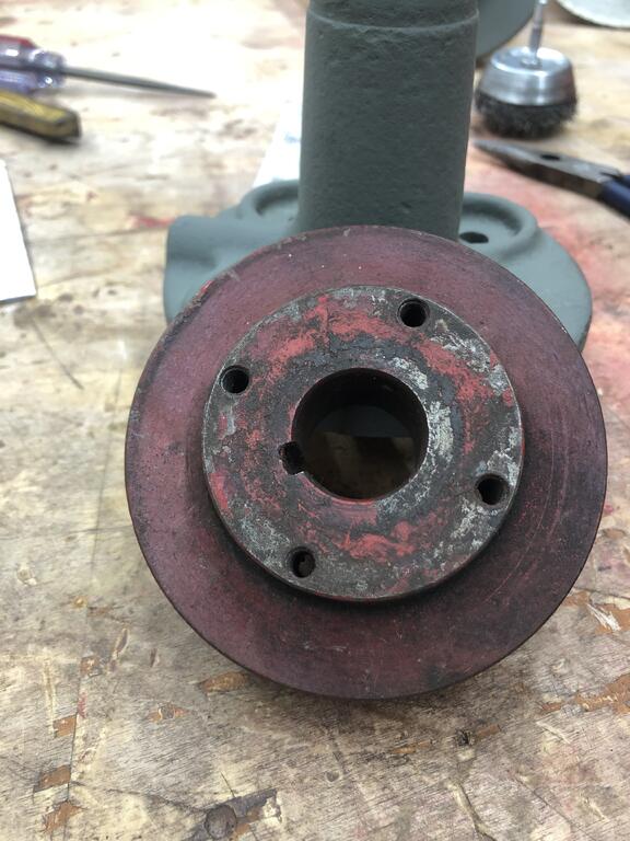

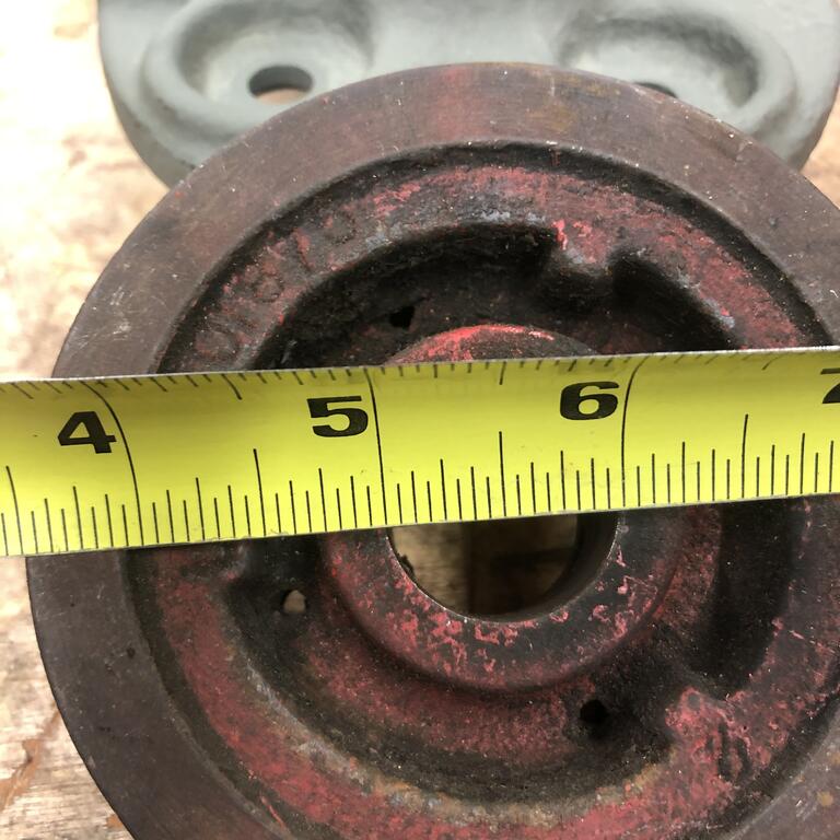

The Tuul Crib 7,354 #1 Posted February 12, 2021 I'm trying to figure out how to calculate the speed that a 4 inch pulley would be over a 2 1/2 inch one for my fresh 12 hp Kohler . After I put it together then realized I had a 1 inch shaft on the PTO side. Oppps! No biggie it was the only one I had that met specs for a standard sized connecting rod. So I'm sitting looking at this 4 inch pulley that I have with a 1 inch shaft. My question is.... I had a 2 1/2 on it before to work for the newer PTO. I found this four-inch that has the new PTO bolt up and a 1 inch shaft.What size belt would I have to put on the tractor to make it work? Would this police speed it up too much? weeeeeeeeee!!! Share this post Link to post Share on other sites
8ntruck 9,381 #2 Posted February 12, 2021 Changing from a 2 1/2" drive pulley to a 4" pulley will increase the speed of the tractor by a factor of 1.6 - assuming that it is a gear drive. Not sure what the increased pump speed would do on a hydro drive. As far as belt size goes, with one that is 1 3/8" longer should get you close to one that should work. 2 Share this post Link to post Share on other sites

953 nut 70,323 #6 Posted February 12, 2021 5 mph 8 mph The math is very straightforward. 2.5" 4" You will probably be able to get by with a one inch longer belt. Just go to Tractor Supply and buy one an inch longer and one two inches longer and see what works best. Share this post Link to post Share on other sites
