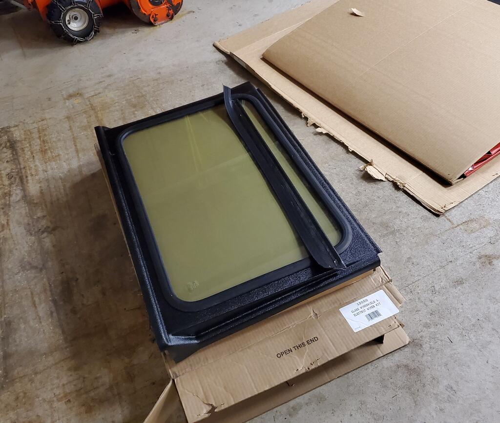

Red-Bovine 337 #1 Posted February 11, 2021 (edited) Received our winter cab from Original Cabs yesterday. Only took a couple days to get it. Everything arrived safe and sound. We opted for the glass windshield and electric wiper. Very easy install and no holes needed to be drilled in the tractor. Only two holes needed in roof for the wiper motor. Rich is one happy camper with his new warmer and less drafty snow removal environment. We have relegated the Wheel Horse to just snow blowing so that makes it easy for us not to convert it to summer duties. We have another tractor for that. We have the foot control for the hydro drive and it posed no issue in installing the cab. Very well made unit and worth having. Here are some photos of the install. Red Edited February 11, 2021 by Red-Bovine 3 4 Share this post Link to post Share on other sites

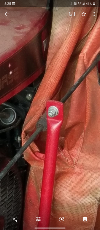

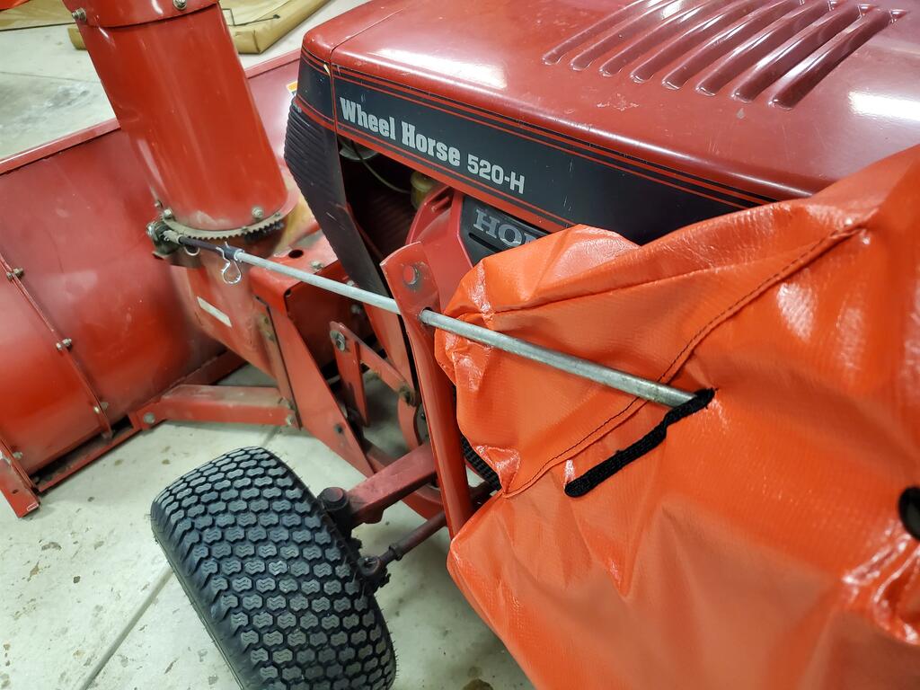

Red-Bovine 337 #6 Posted February 11, 2021 Needed to lower the chute control so we drilled a hole below the original. This allowed us to place the rod bracket lower for the cab material to properly snap in place. 5 Share this post Link to post Share on other sites

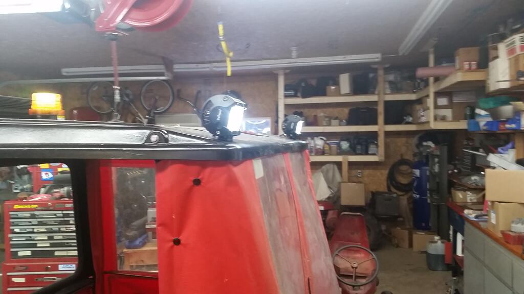

WHX?? 58,306 #11 Posted February 12, 2021 (edited) You will not be sorry you went with the glass front and wiper. Funny you did not have the inside the cab support for the chute rod. I was all set to make the support out of 3/4 conduit as the deuce I got was missing more than a few pieces but ther was a tab on the inside of the cab for the rod. Looks like it worked out for you. Ed and I ventilated the belt guard then directed some engine heat up into the cab. Not sure how that would work with your Honda repo tho. I would go snap some pics but too cold out! Some cab lights next! Now you know what I meant about the heel reverse on the pedal kit just clearing the support. Get yourself a wheel spinner too... you will not regret that. Edited February 12, 2021 by WHX24 1 Share this post Link to post Share on other sites
Red-Bovine 337 #12 Posted February 13, 2021 (edited) Rich says it's not as nice as the Lincoln but then the Lincoln doesn't clear the driveway LOL We did get the brackets for the chute rod and did use the one for the 520H. Problem was the angle from the chute to the rod brace was too steep causing the rod to be too high and interfered with the snap on the front cover. So we flattened the brace and drilled a hole a little lower so we could attach the bracket below where the snap was located. Rich says he is getting some heat off the Honda engine. Red Edited February 13, 2021 by Red-Bovine 1 Share this post Link to post Share on other sites

WVHillbilly520H 10,379 #16 Posted February 13, 2021 4 hours ago, Red-Bovine said: Rich says it's not as nice as the Lincoln but then the Lincoln doesn't clear the driveway LOL We did get the brackets for the chute rod and did use the one for the 520H. Problem was the angle from the chute to the rod brace was too steep causing the rod to be too high and interfered with the snap on the front cover. So we flattened the brace and drilled a hole a little lower so we could attach the bracket below where the snap was located. Rich says he is getting some heat off the Honda engine. Red I just made a small link/spacer for my chute rotation handle... 3 Share this post Link to post Share on other sites

WVHillbilly520H 10,379 #20 Posted February 14, 2021 7 hours ago, Red-Bovine said: I like the offset bracket for the chute control and will try that. Red The beauty of this is the 270° arc of adjustability. 1 Share this post Link to post Share on other sites
