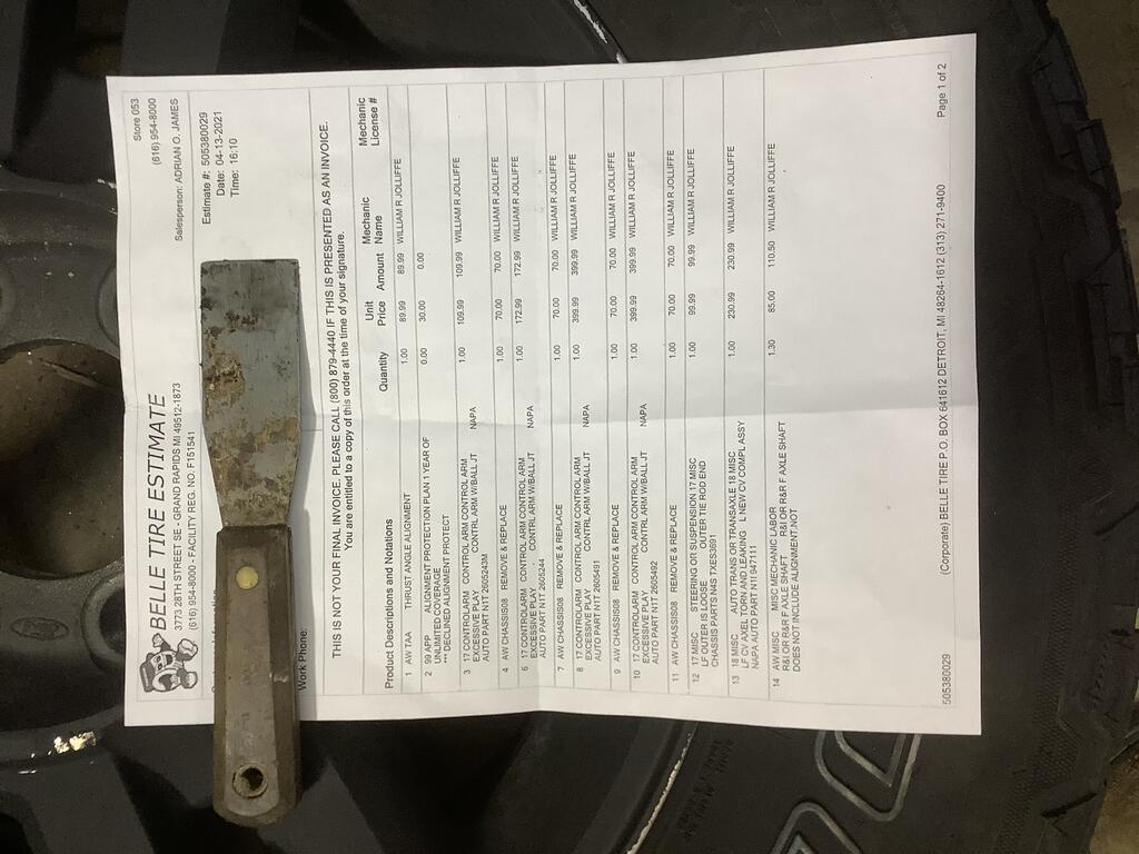

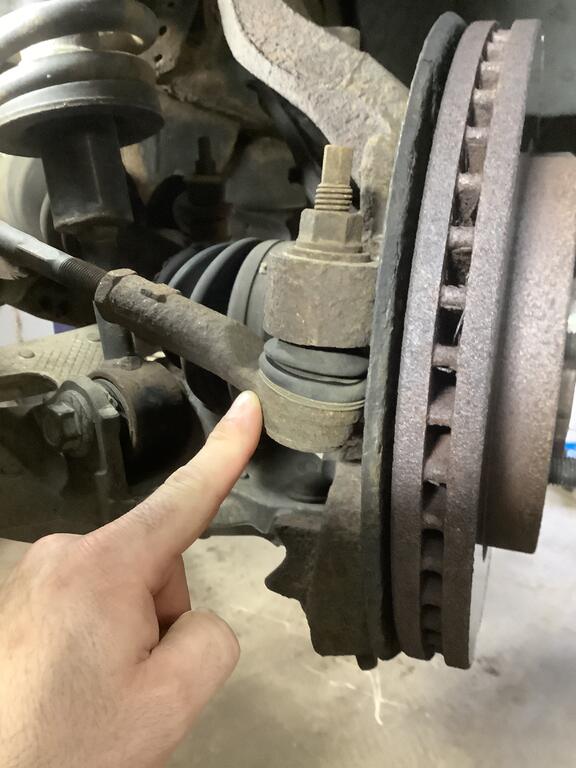

Pullstart 69,638 #105 Posted April 20, 2021 Idiot of the week? Prescribing $1900 of service work for a bad tie rod end. These ball joints are right tight and I found a dry rotted CV as well but not leaking. As much as I’d love a day long pay check, I can’t justify billing as such. Best of all, this is just his winter beater truck. It’s barely worth $1900. 1 Share this post Link to post Share on other sites

Jeff-C175 7,207 #108 Posted April 20, 2021 2 hours ago, pullstart said: These ball joints are right tight Why are there four control arms listed? They want to replace both upper and lower? Not an idiot, rather a CROOK! 1 Share this post Link to post Share on other sites
Pullstart 69,638 #109 Posted April 20, 2021 9 minutes ago, Jeff-C175 said: Why are there four control arms listed? They want to replace both upper and lower? Not an idiot, rather a CROOK! Easier than ball joints, I suppose. The sad part, is every ball joint is in solid shape. An hour or so of shop time and it’s complete. I used my “eyecrometer” to check the alignment (toe) and it feels pretty good on the road. He plans to have the front tires replaced, or I’d have stuck them on the rear for him and he’d likely have no issues of drivability. Share this post Link to post Share on other sites
