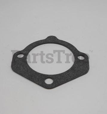

cschannuth 3,819 #1 Posted February 10, 2021 (edited) I was plowing snow today and my charger 12 started to run a little bit rough. I topped off the fuel tank and took off again and as I was backing up the entire air filter assembly was laying on the ground after I looked up from backing up. The three screws that attach it to the carburetor had come loose inside the housing. I put a little medium duty Loctite on the three screws and reinstalled it and everything looked fine but it appeared that I could see a little bit of light between the filter housing and the face of the carb. Is there supposed to be a gasket between there? Without it it seems like it might be a spot for air to bypass the filter and go directly into the carburetor. Edited February 10, 2021 by cschannuth 1 1 Share this post Link to post Share on other sites
WHX?? 53,360 #2 Posted February 10, 2021 (edited) Yes there is a gasket there Craig. Bigger question is did the screws get ingested by the engine? Edited February 10, 2021 by WHX24 5 Share this post Link to post Share on other sites

cschannuth 3,819 #6 Posted February 10, 2021 31 minutes ago, WHX24 said: Yes there is a gasket there Thank you so much. Can I get just that one gasket somewhere? Is that something my local auto parts store would have? Share this post Link to post Share on other sites
pfrederi 19,278 #7 Posted February 10, 2021 Be cheaper faster to make one. it is nothing special. Cereal box or some gasket paper 6 Share this post Link to post Share on other sites

cschannuth 3,819 #14 Posted February 11, 2021 I ordered a new one for $5 on partstree and made a temporary one out of a piece of cardboard for now. It worked fine. The carb was a litttle loose too. This tractor seems to vibrate lots of bots/screws loose. 2 Share this post Link to post Share on other sites

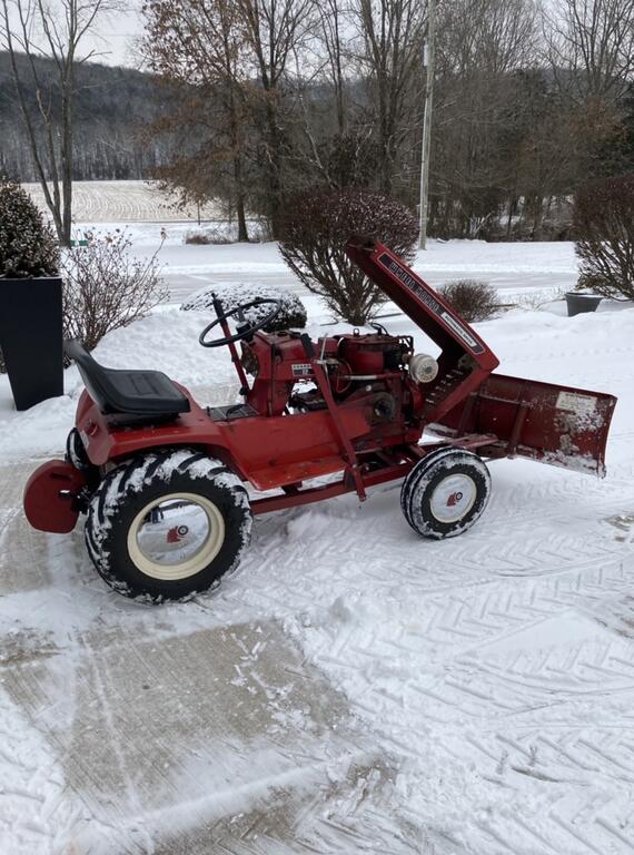

WHX?? 53,360 #15 Posted February 11, 2021 (edited) 11 minutes ago, cschannuth said: bots/screws loose. Kinda like @squonk!?!?!? Forgot to add guy that is one fine tractor ther guy.... love them shoes and hub caps. Looks to be a early large diameter steering wheel on it? Edited February 11, 2021 by WHX24 Add 3 Share this post Link to post Share on other sites
cschannuth 3,819 #16 Posted February 11, 2021 17 minutes ago, WHX24 said: Forgot to add guy that is one fine tractor ther guy.... love them shoes and hub caps. Looks to be a early large diameter steering wheel on it? Thanks! I’m still not really sure if it’s a 1277 or an early 68 Charger 12 but I really like it. It’s really fast and fun. I pushed a little snow every day this week at my house and the neighbors across the street. It worked great (until I lost the air filter assembly-haha). I need to do a bit of adjusting because the motion lever works its way all the way forward if you let go of it. 1 5 Share this post Link to post Share on other sites
