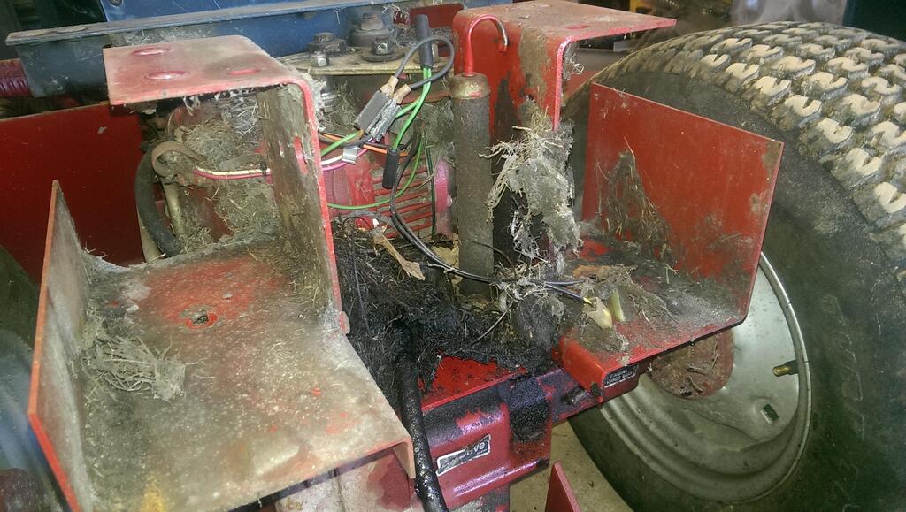

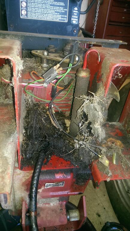

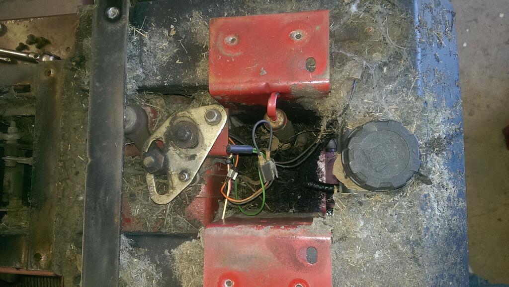

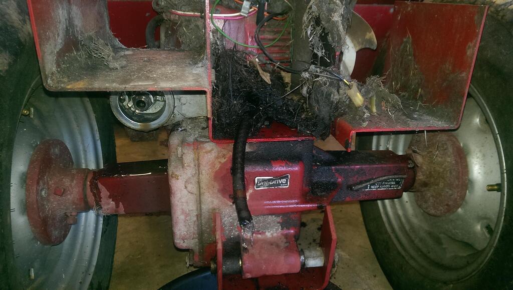

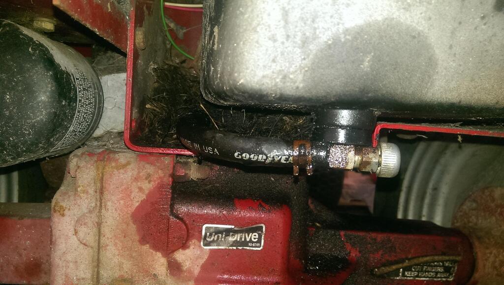

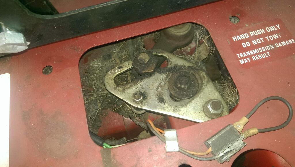

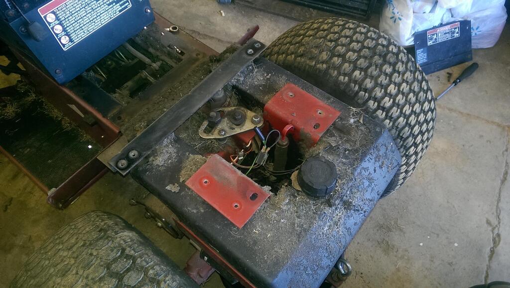

WVHillbilly520H 10,378 #11 Posted February 11, 2021 This is what could potentially happen if not cared for properly, bought this 1 used this way. In no particular order... 2 1 Share this post Link to post Share on other sites
Handy Don 15,949 #12 Posted February 11, 2021 34 minutes ago, lynnmor said: I wash down the rear with engine cleaner and a garden hose, so a rag is not enough protection. For sure if I'd been doing a big clean I would have just put the old oil filter back on temporarily after getting the tank off. 17 minutes ago, WVHillbilly520H said: This is what could potentially happen if not cared for properly, bought this 1 used this way. In no particular order... It is amazing they continue working with this much neglect. Were the transmission fan blades wrecked too? Seat switch overridden and the hydro cam bolt looks maxed (the cam plate seems a bit wallowed out, too.) Cleaned up real nice in the back there, though! Share this post Link to post Share on other sites

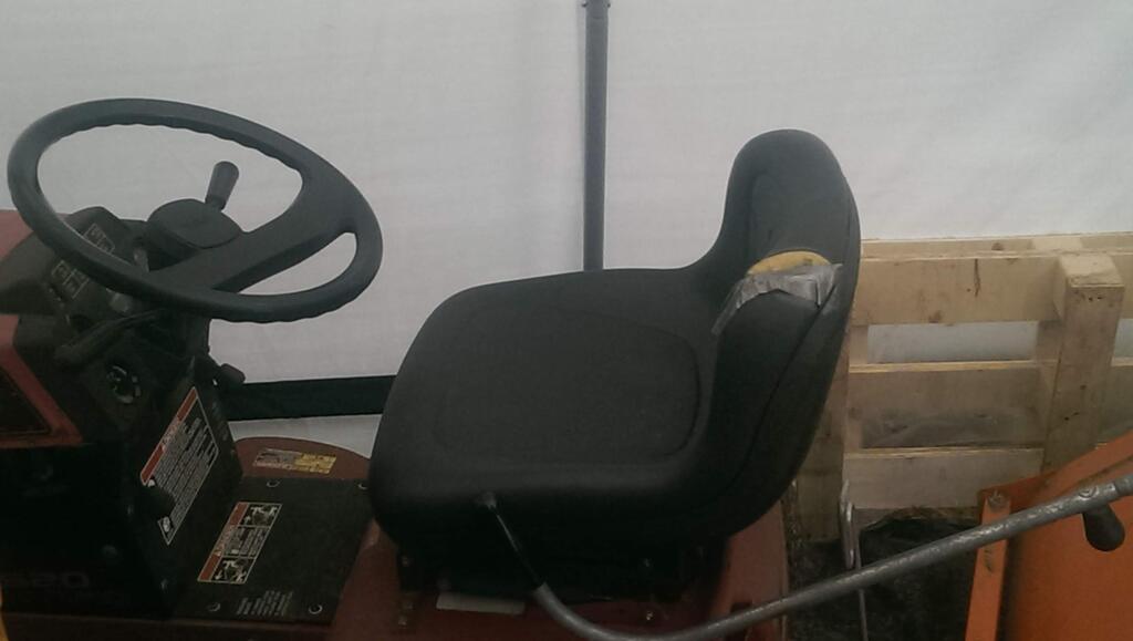

WVHillbilly520H 10,378 #13 Posted February 11, 2021 12 minutes ago, Handy Don said: For sure if I'd been doing a big clean I would have just put the old oil filter back on temporarily after getting the tank off. It is amazing they continue working with this much neglect. Were the transmission fan blades wrecked too? Seat switch overridden and the hydro cam bolt looks maxed (the cam plate seems a bit wallowed out, too.) Cleaned up real nice in the back there, though! Why the seat switch was bypassed. And to boot this was my old WH dealers personal mower for a while (after trading it on a Dxi not long after I bought my Anniversary 520H) then he just left it sitting after he decided to use a Simplicity ZTR. But he does keep the NOS unsold 522xi in the dry... 1 Share this post Link to post Share on other sites

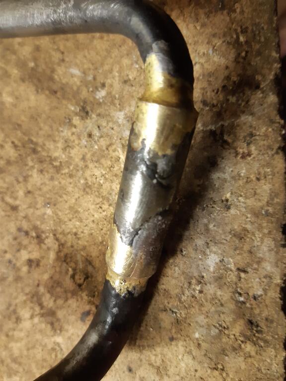

Damien Walker 297 #20 Posted March 19, 2021 Quick update: the filter to transmission return pipe is no longer available from Toro (though I note there are a few on ebay), so I brazed mine, slipping the trimmed broken ends into a larger piece of steel pipe. Fitting it was a complete @#$%^&! As I have only just put the tractor together, I couldn't face taking it apart again. First problem is that there is insufficient room between the transmission and the centre console to let the nut on the pipe pass between. I made room by chain drilling and taking out a small piece of the rear of the centre console just behind the slot for the brake linkage. I'm not going to photograph it because it is a horrible mess (embarassed) but the nut passes through. With the space available it is difficult to do a more professional job without a significant dismantle. Taking the brake levers off is not easy because it seems you have to get spanners on both sides of the transmission ...which was impossible for me with the number of hands I have and the lack of room in the shed. If you remove the brake band and the long bolt and spring that actuated it, you can winkle the pipe into position. Left rear wheel off of course. 40 mins mowing the lawn this evening and no (noticed) leaks. Share this post Link to post Share on other sites
lynnmor 8,628 #21 Posted March 20, 2021 If I am thinking of the same pipe, I had one kinked and bought a used replacement from A-Z Tractors. To make enough room, I loosened the transmission mounting bolts and pried the transmission back. 1 Share this post Link to post Share on other sites
Handy Don 15,949 #22 Posted March 20, 2021 I concur that the metal tubing for the trans and lift supplies are not readily serviced, but I suspect their "mean time between failures" (when following the well-documented maintenance guidelines) is longer than rubber/fabric hose. And for factory installation, they were probably less costly. JMO Share this post Link to post Share on other sites
